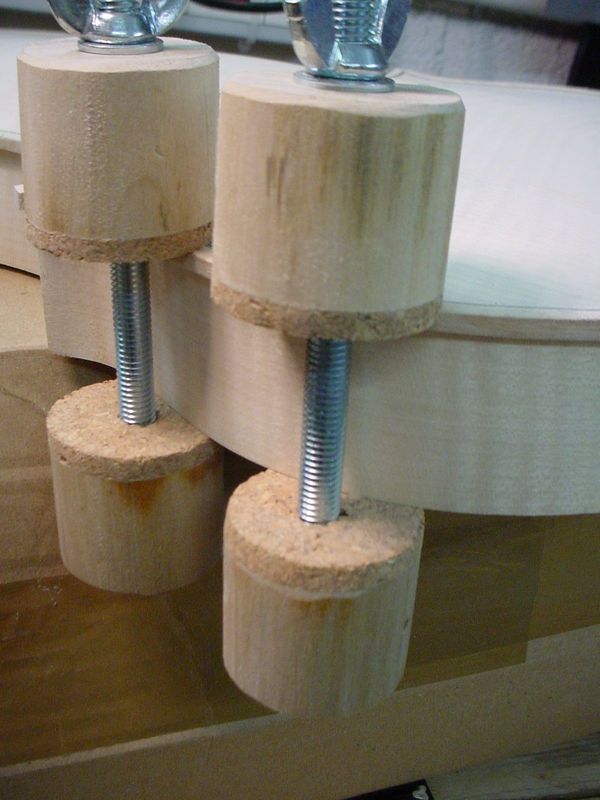

    The luthier needs some special clamps, plenty of special clamps, of different kinds.

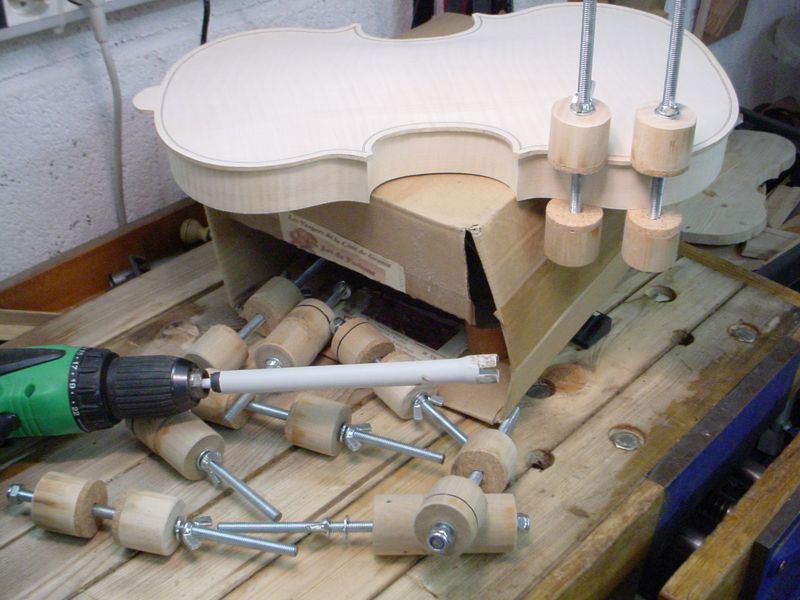

    Here is a batch of rib clamps for stringed instruments, used for clamping the plates on the sides when gluing.
    The clamping faces are padded with thick cork.
    Notice that when you are using hot hide glue, the open time is very short, and you need to be fast.
    To accelerate the process, I have designed this little PVC adapter you can see on the cordless drill, to tighten (just approach) the wing nuts quickly.
    Cheers !
    Christophe

    You have such fascinating construction techniques. The cork cover clamps and the wing nut tightening device is so clever. Thanks for explanation about having to work fast with hot hide glue. You must be doing a lot of research just to learn the traditional techniques and/or figure it out as you go along. Either way your photo of the violin you are making is truly amazing.
    I am looking forward to learning and seeing more from this line of work.

    Very easy to set up especially with the drill. Fits nicely with the contours and could well be adapted for similar gluing setups.
