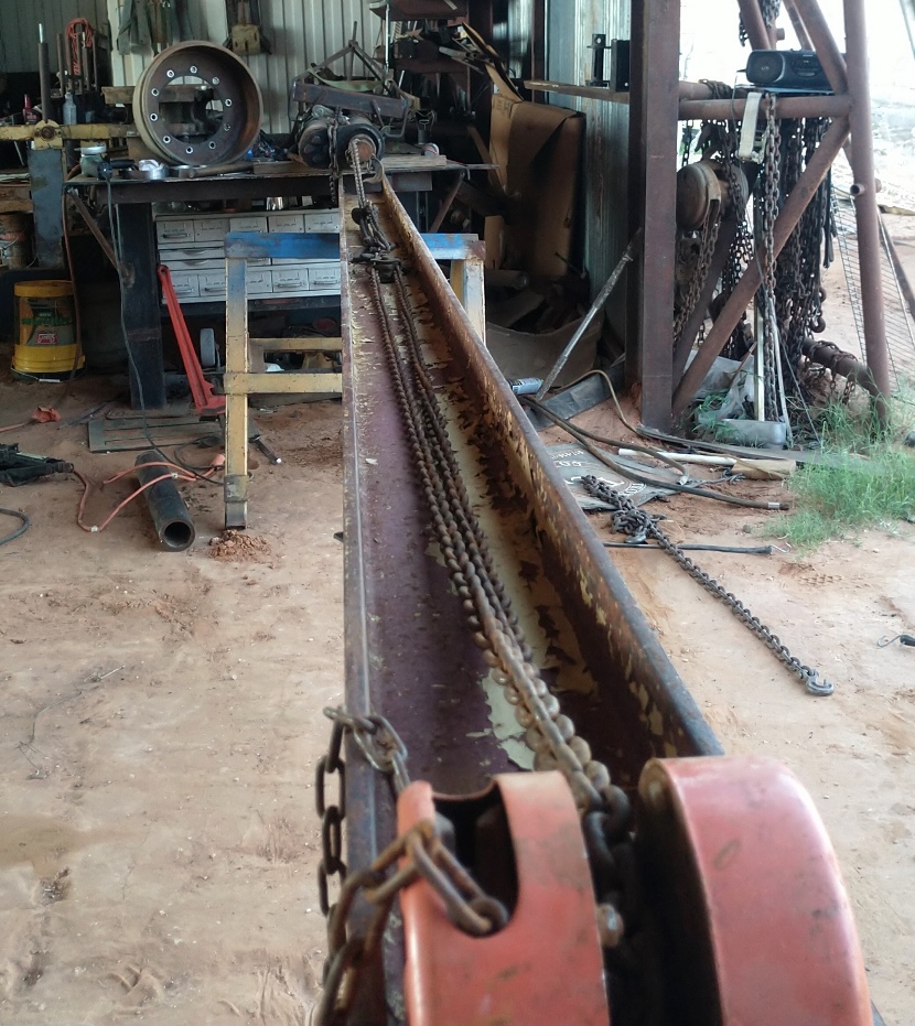

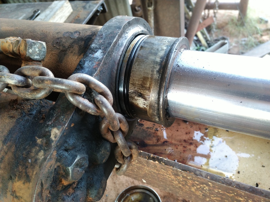

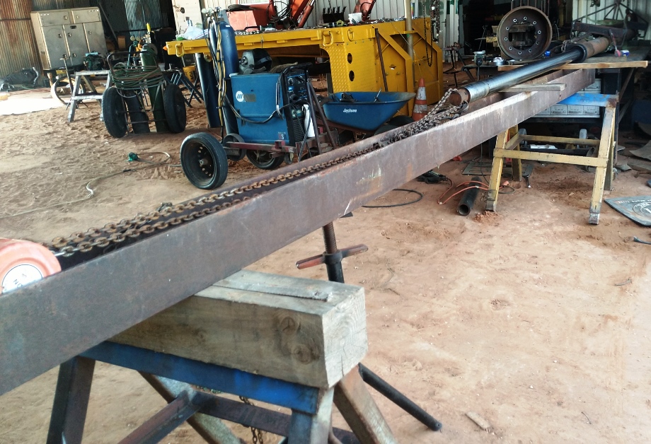

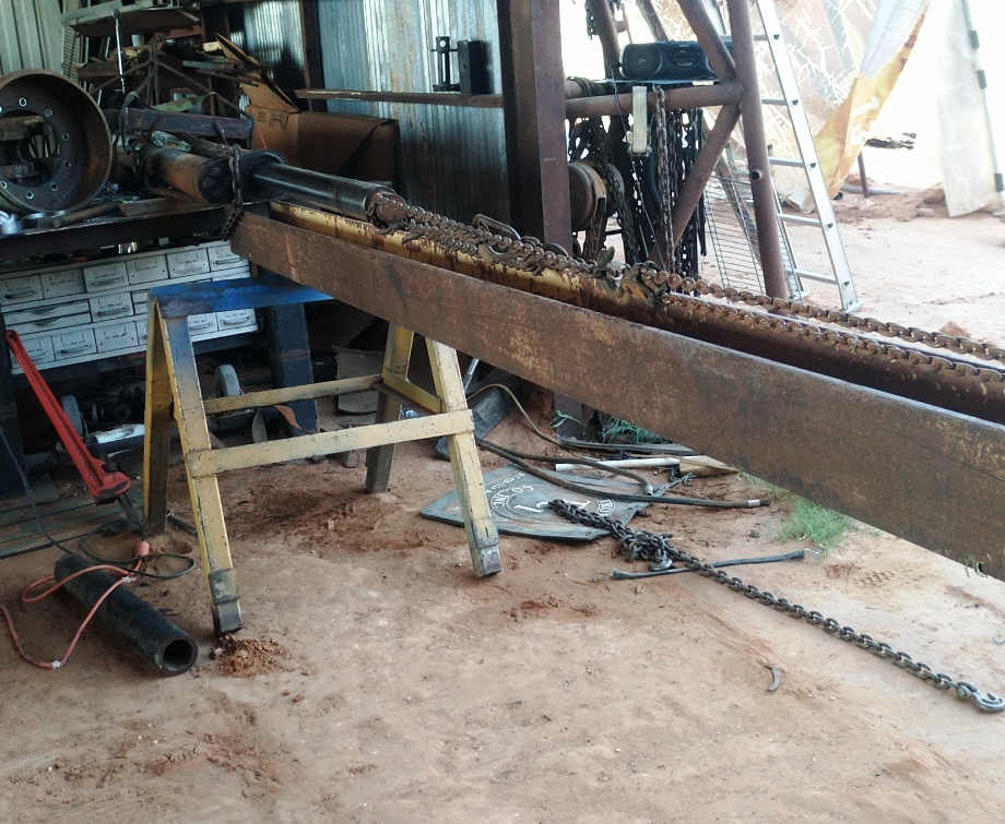

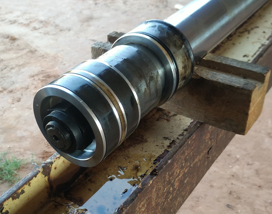

With the Siamese cylinders chained down tight to my worktable the gland nut removed it was now time to make a rig for puling the rod.
I used a 16 ft long piece of 6" H beam laying on na pair of my steel work horses butted up against the table a 2 ton chain hoist and a length of chain
