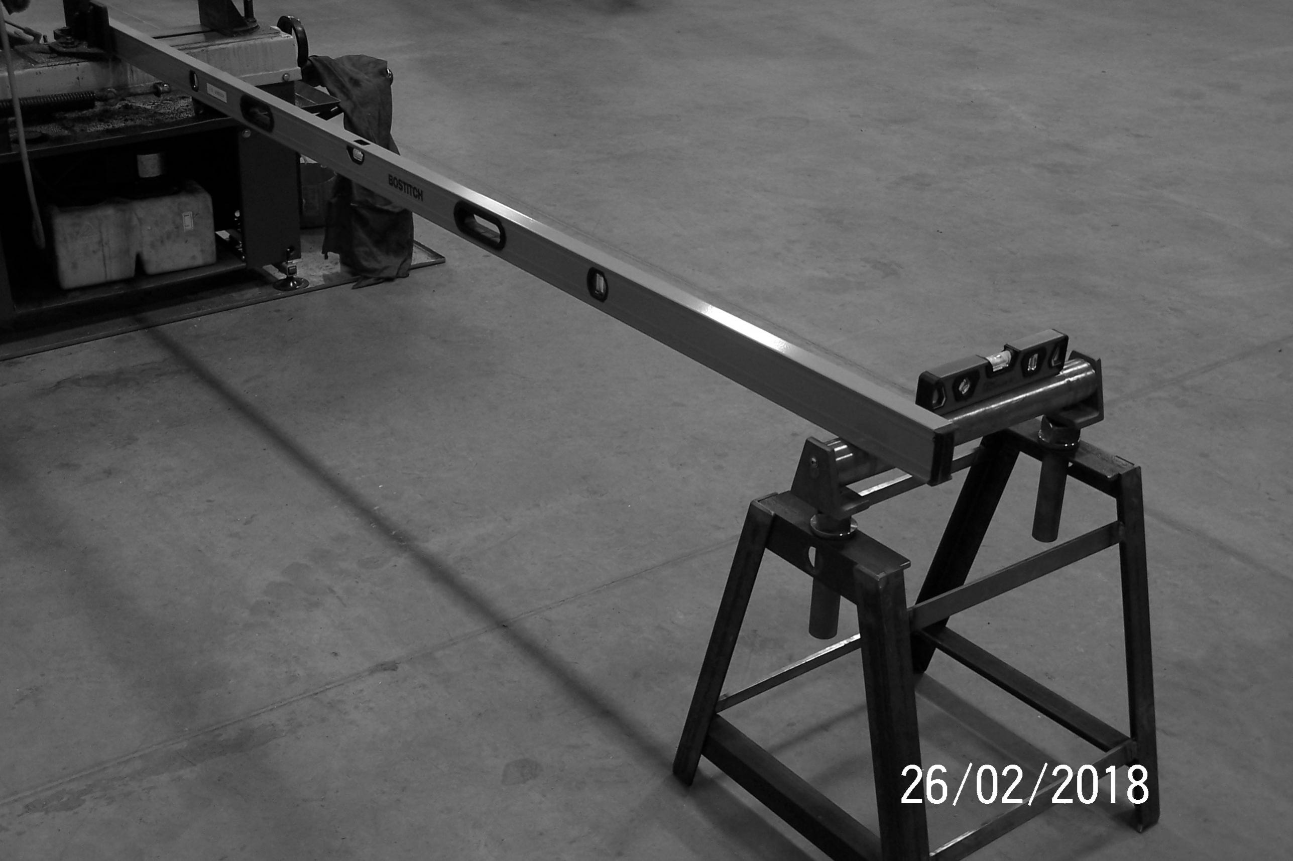

I used 2 levels, an 8' carpenter for X and 12'' magnetic torpedo for Y on the bandsaw support. To get accurate cuts for long material used in machine frames, this and improved leveling of the saw itself had to occur.
Attachment 23835
As no table connects machine and support there likely is a sag in the level, regarded negligible by reversing level for the same reading. I found imperfections in the concrete floor experimenting with the distance and approximating the Airy Points https://en.wikipedia.org/wiki/Airy_points
