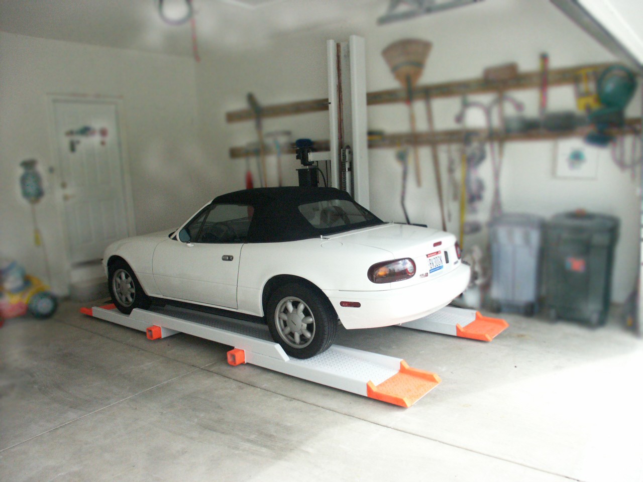

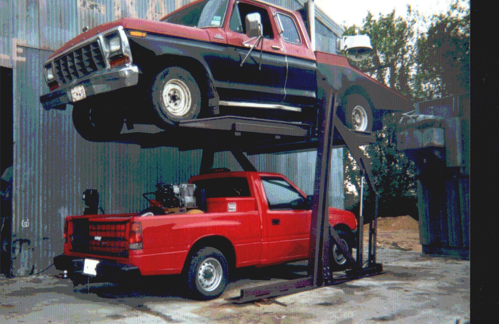

    However here are some examples of my 4 post 2 post and even a single post parking/ service lift design.
    IN the gif I can see the platform design as having its origin from the company I was once associated with.
    and the single post quite possibly could have been a spin off of my single post lift

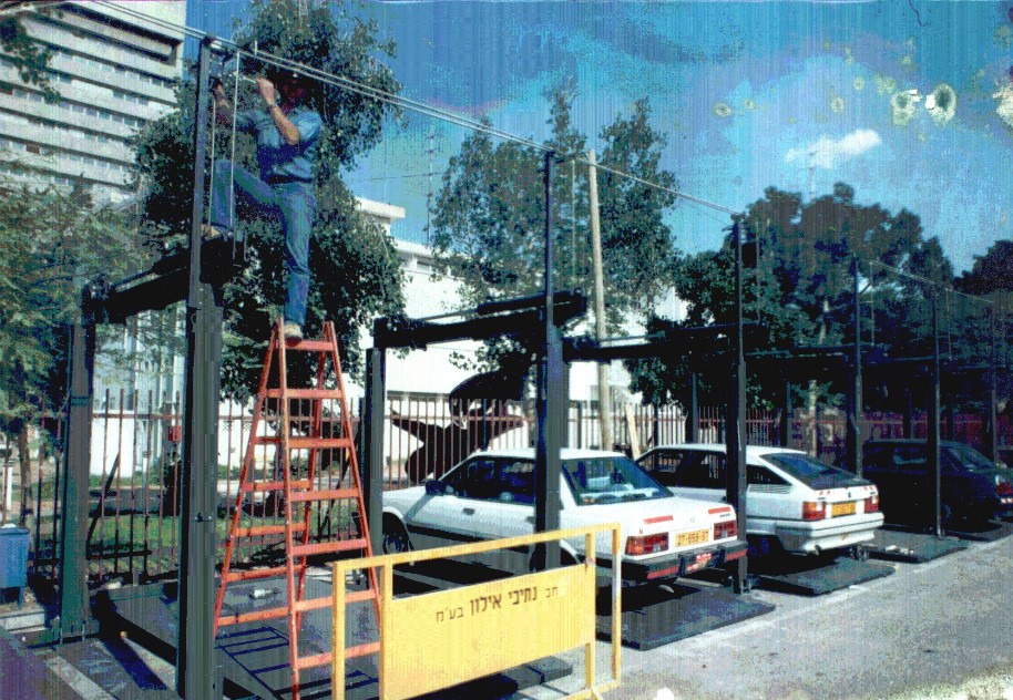

    Me installing some parking machines in Telavi Israel

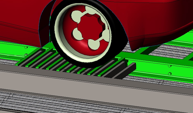

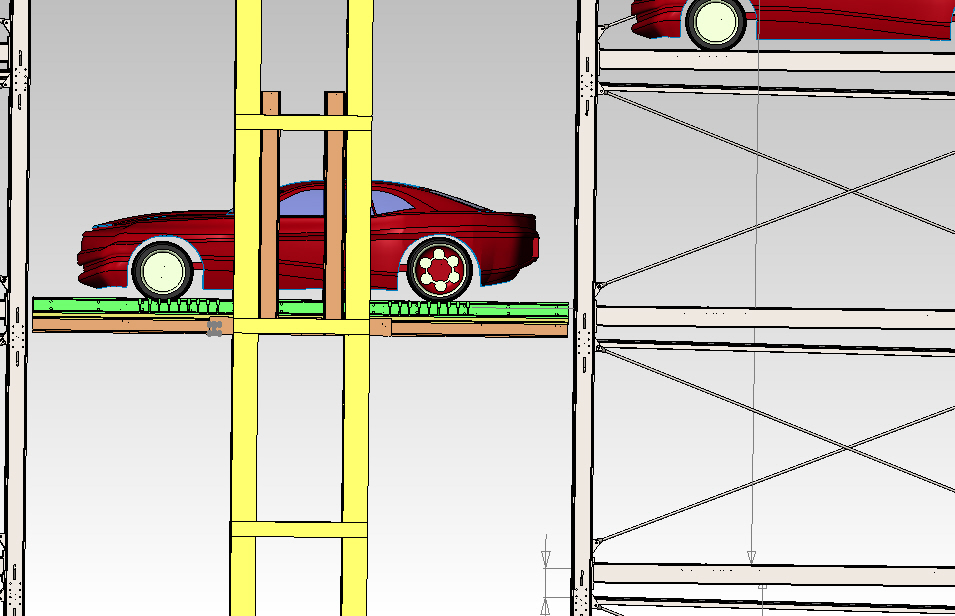

    I did a lot of the preliminary design work on the fully automated parking system installed in Dubai my work was in the structural and mechanical aspects of the scope. I still have most of my cad drawings filed away
    Once completed whoever did the automation on the system did a jam up job for the time period. a driver would just drive into a stall exit his vehicle hold his cell phone up to the Bluetooth scan reader or insert his credit card into the reader His vehicle would then be hauled on the platform to the appropriate spot raise it to a predetermined level eject the vehicle into its parking space then the platform would return to the cue of waiting transport platforms.
    the main issue with those mega automated parking facilities is the drivers themselves. on average it could take from 45 seconds to 2 full minutes for some drivers to exit their vehicles because of needing or wanting to gather items to carry with them and up to 5 minutes on return to load their stuff back into their vehicles particularly if they had been shopping.

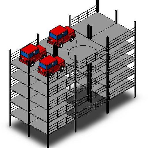

    Another such system I designed for the Sultan Center in Kuwait was strictly valet with 4 elevators and turntables the valets as I had envisioned it would drive the vehicles onto a lift rise to which ever level there was open spaces then drive to the appropriate parking spot the turn tables were there to alleviate the need to do any maneuvering other than straight forward or reverse .
    Shown is half of the valet carpark system
    the preliminary design drawings for the automated system
