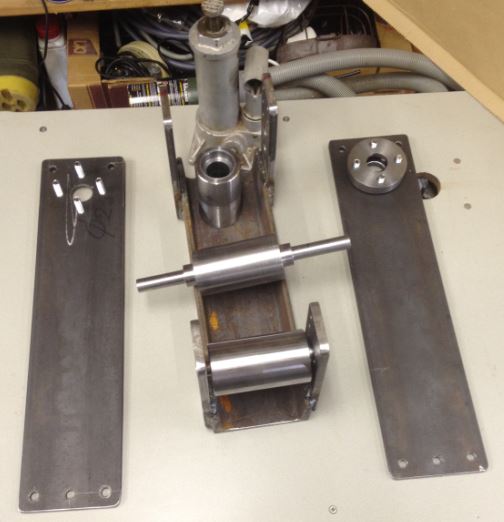

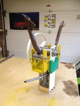

I want to bend some square tubing to make a pedal car for my grand sons and need a roller bender for that and maybe for other projects in future.
So I came up with the idea to make one myself and as I have practically all the parts now I want to show you my progress.

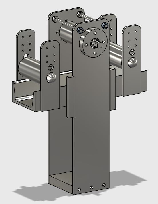

Attachment 8400
the idea

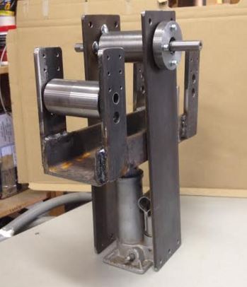

Attachment 8373
important parts

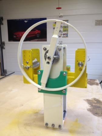

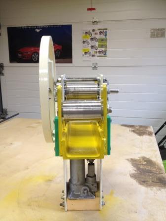

Attachment 8374
impression when finished
