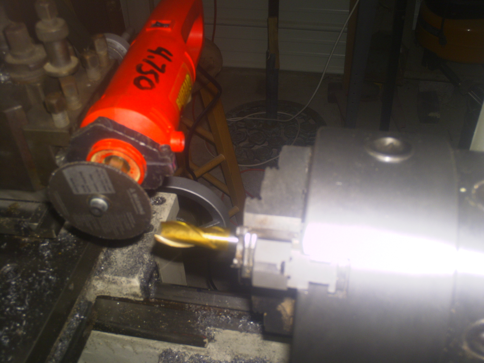

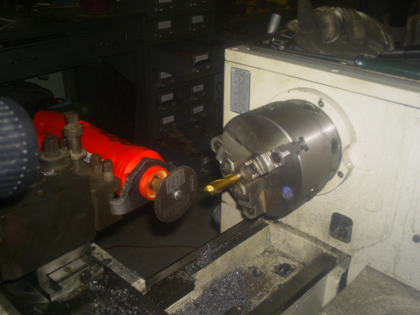

Attachment 8122 Attachment 8123 built bracket to mount rotary cutter on toolpost mainly to sharpen end mills

Hey,
Is that simply an abrasive cutoff disc you are using to sharpen the end mills or is it something a bit more special ?
Bill
just abrasive cut off disc. worked really good I was about .250 above center
