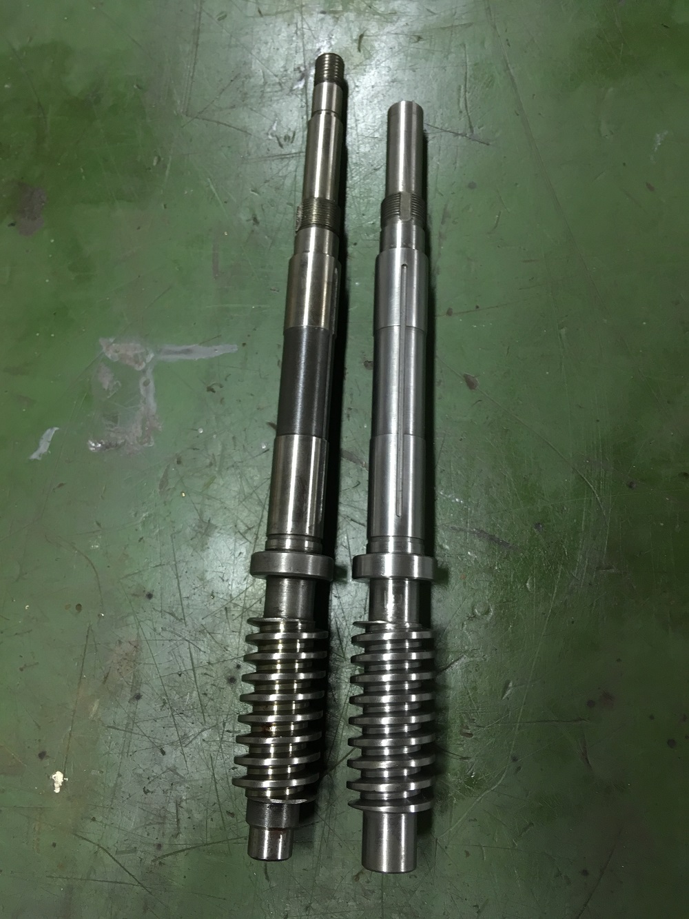

Hi All
Yesterday I spent the day making a new worm shaft for my rotary table. The reason for this, I am currently trying to make this motorised. controlled via an Arduino and stepper motor. As I need to find away of coupling the shaft of the rotary table to the stepper motor I didn't want to make modification to the existing shaft just in case I ever need to convert back to manual table.
The last time I cut a worm was in my apprentice days so a bit of head scratching :headscratch: and research it all came flooding back.

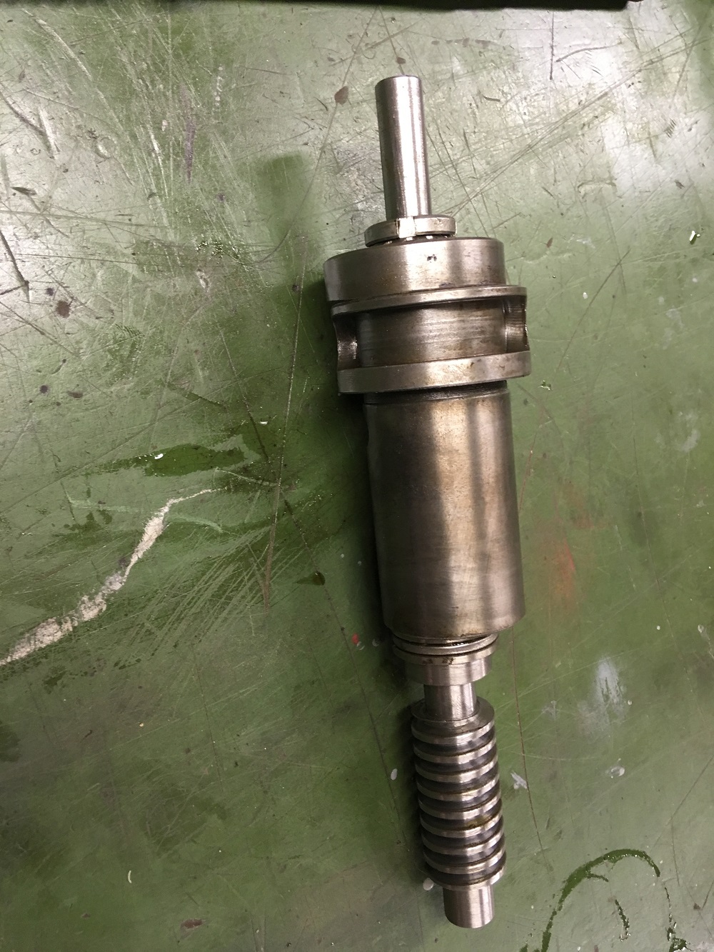

The first thing was to remove the existing shaft so I could get some measurements. As I could measure the pitch this was a good starting point and the table being made in Spain I was guessing it would be a Module gear? so to calculate the Mod=Pitch/Pi. So Mod=6,28/3.14= Mod 2,
I then calculated the helix angle to ensure I had enough lead clearance when setting the tool and cutter to cut the HSS tool. The helix angle is simple trigonometry. First the opposite side is the pitch and the adjacent side = (Pi x Dia of shaft) which equates to one full thread.

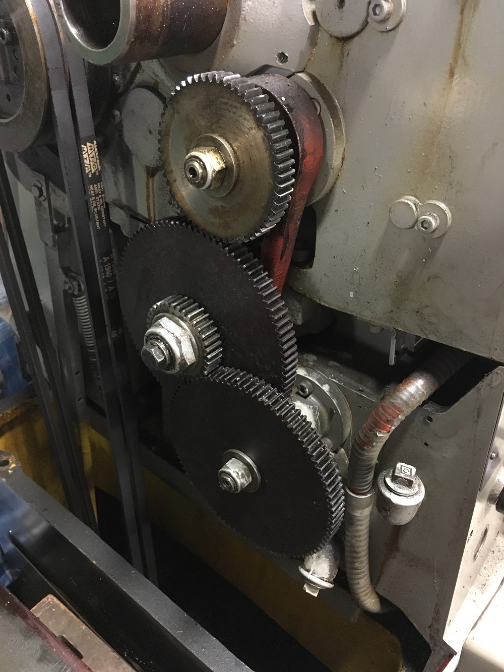

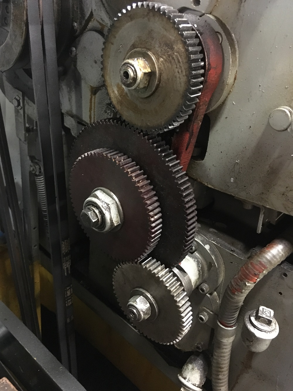

The shaft blank was machined and the lathe gear box/gear train set to the Mod 2 mode.
Attachment 31498
Gear selection chart
Attachment 31506
Mod gear train
Attachment 31497
Standard low range gear train I normally use

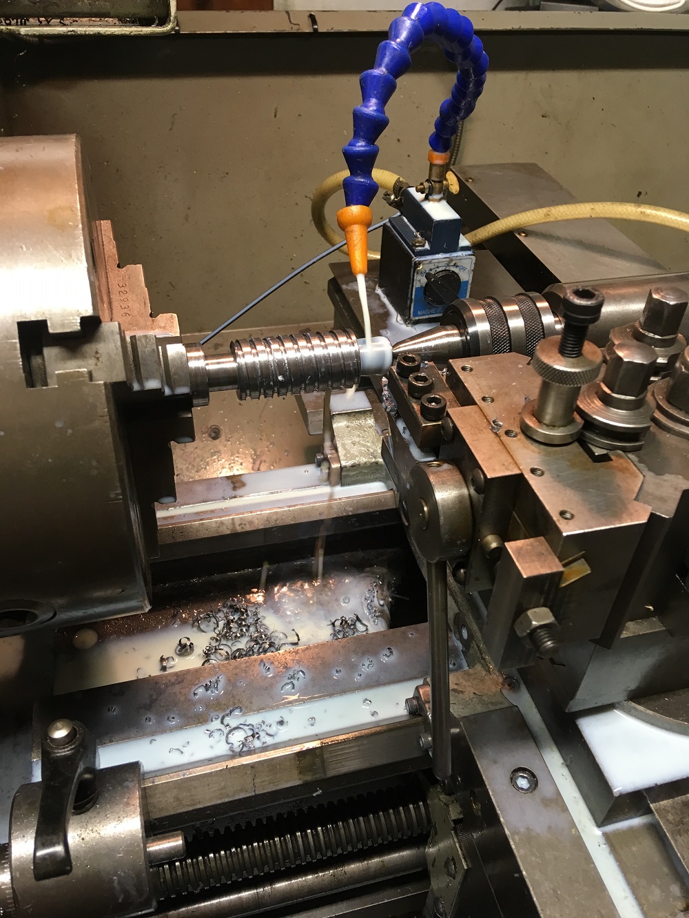

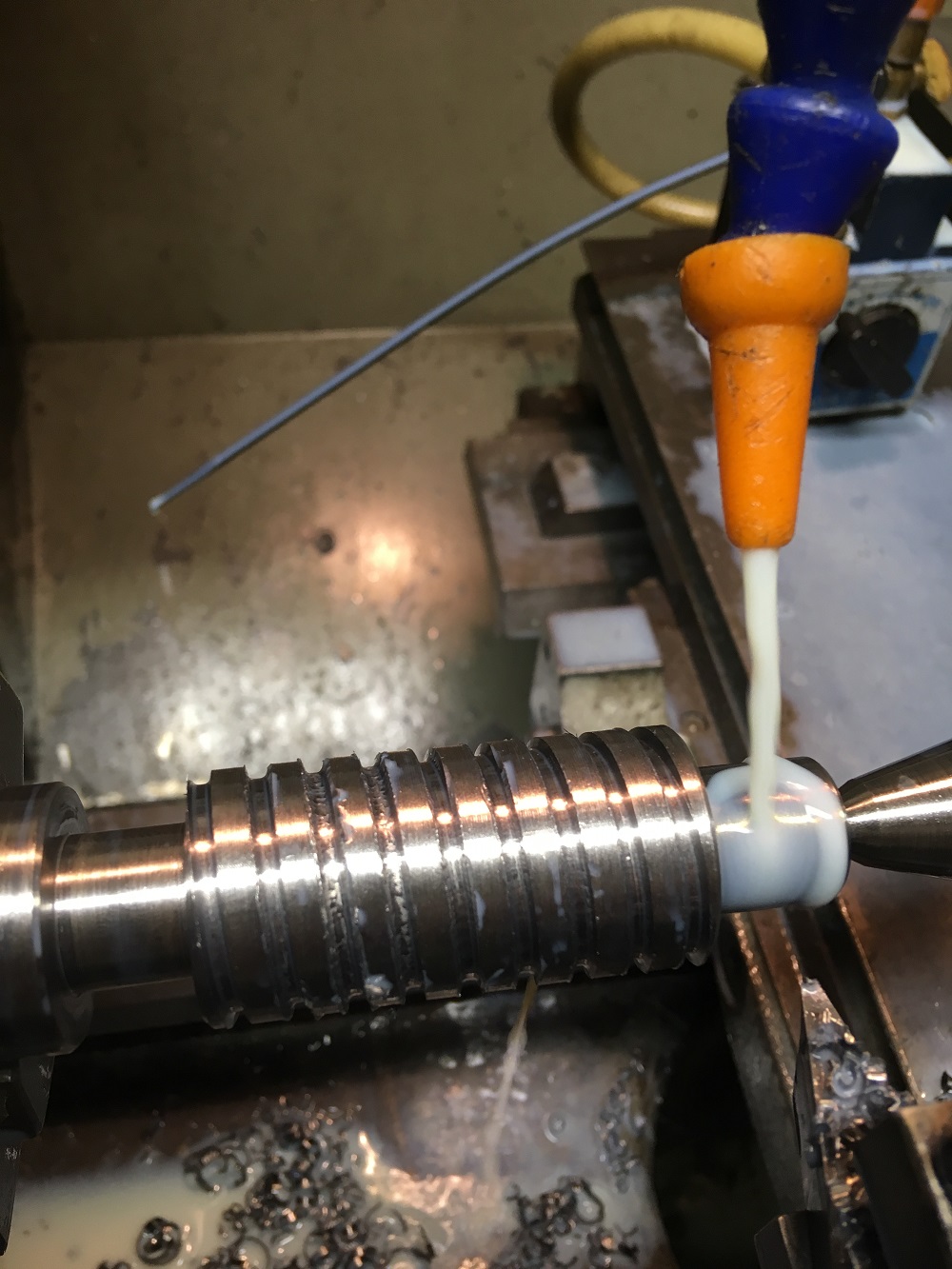

Attachment 31499
First few passes.
Attachment 31500
Retracting tool makes the process a lot easier

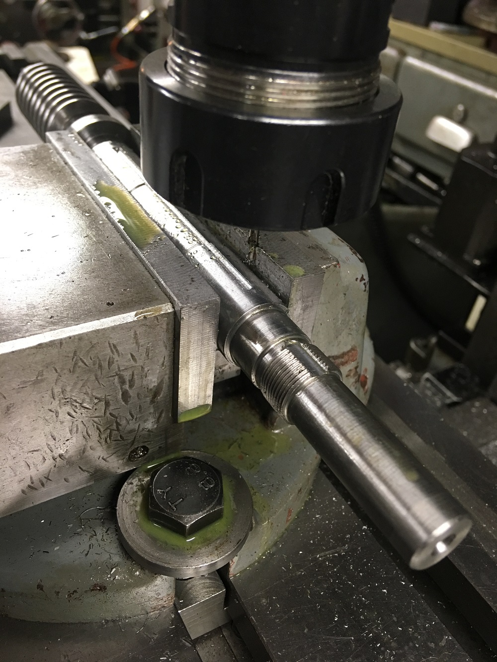

Attachment 31501
Milling oilway and lock washer tab slot

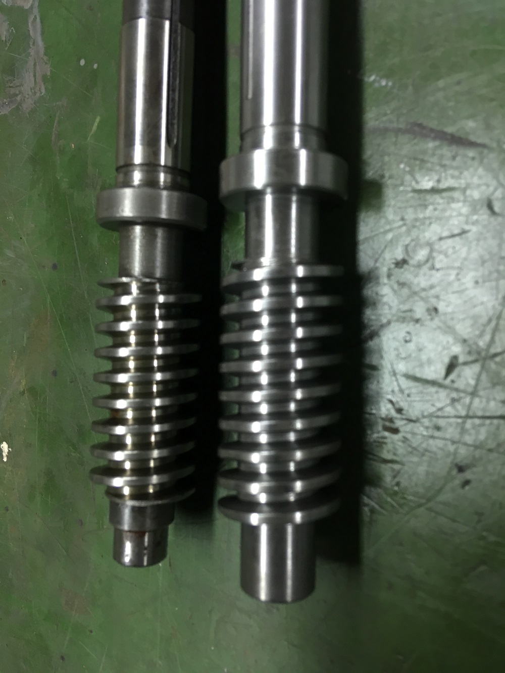

Finished worm
Attachment 31503
Both shafts
Attachment 31504
Assembled new shaft assembly

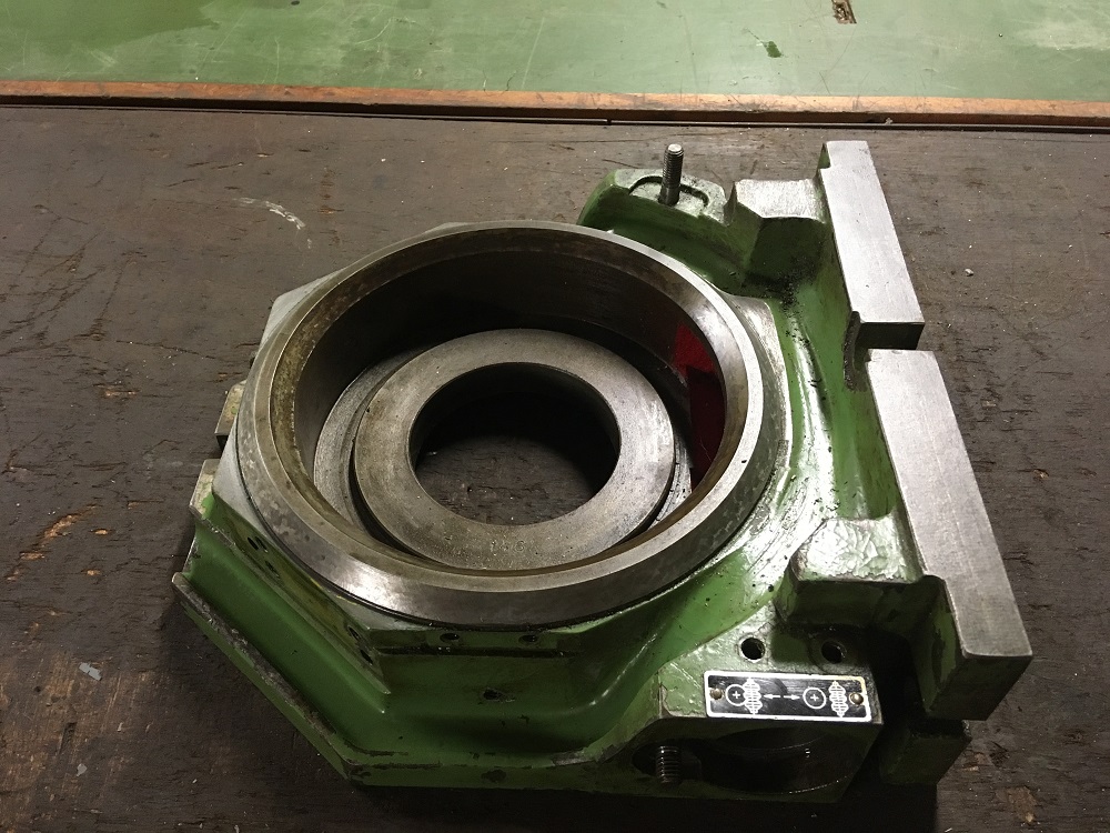

Attachment 31505
Rotary table casting
