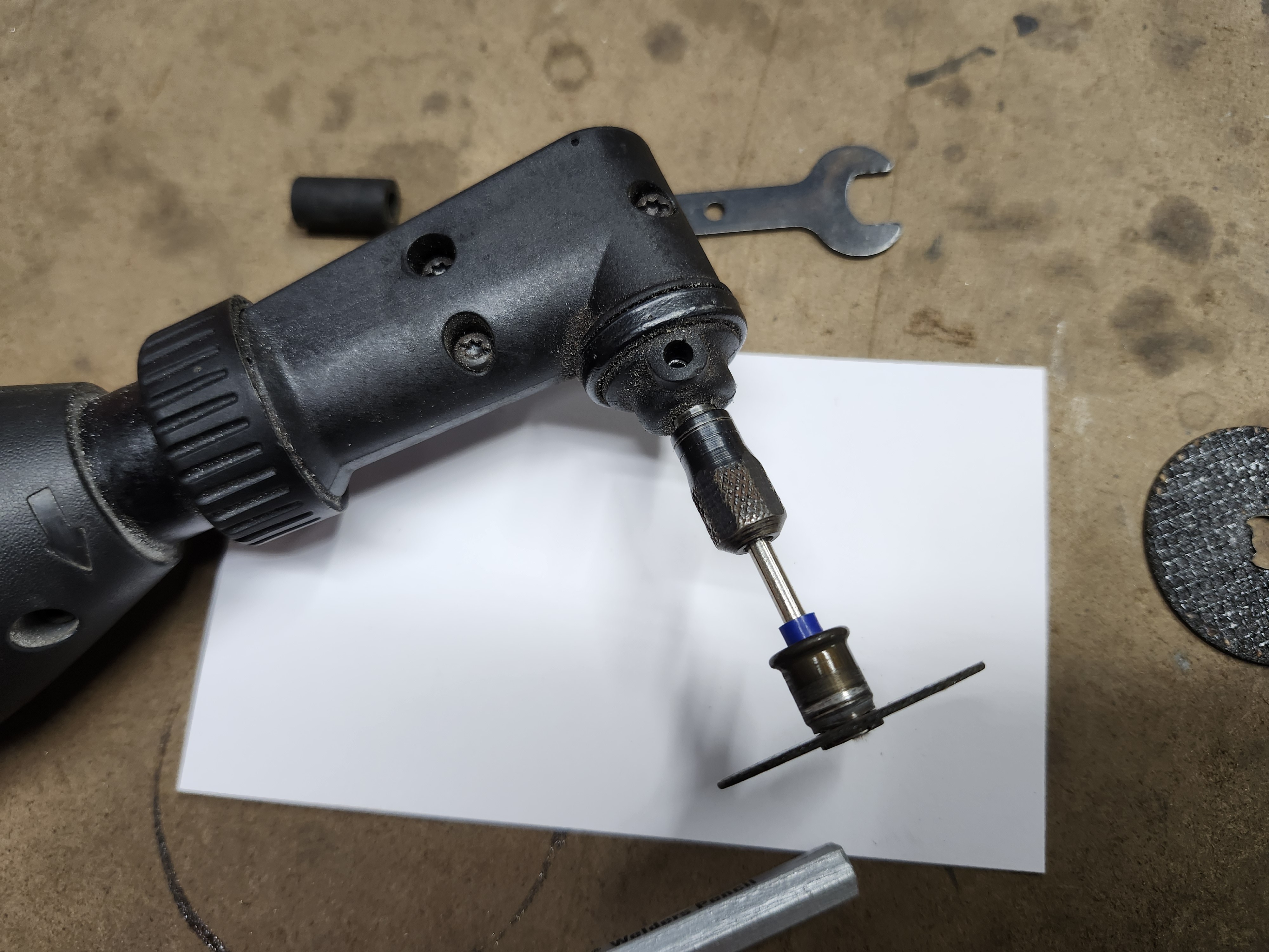

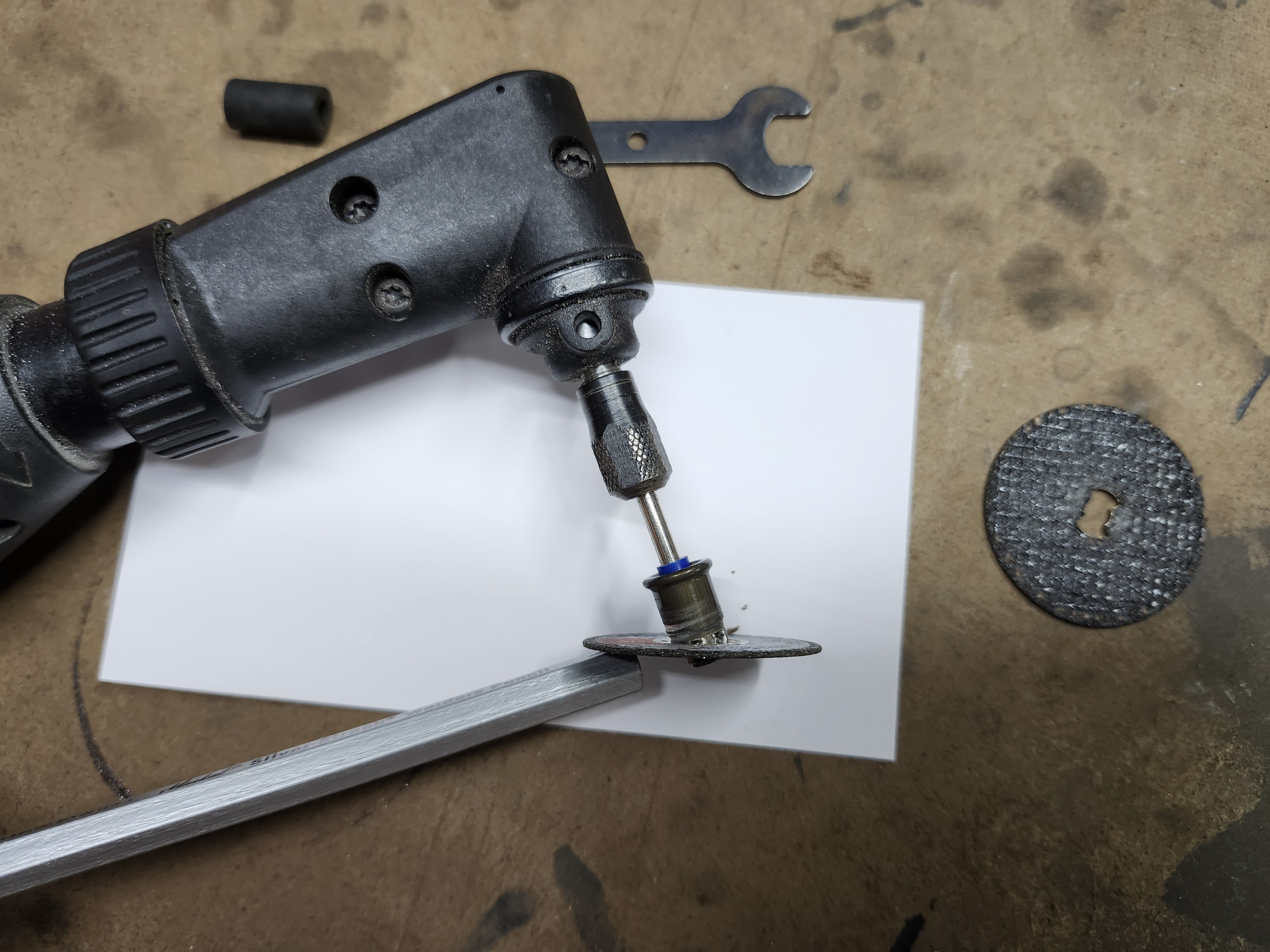

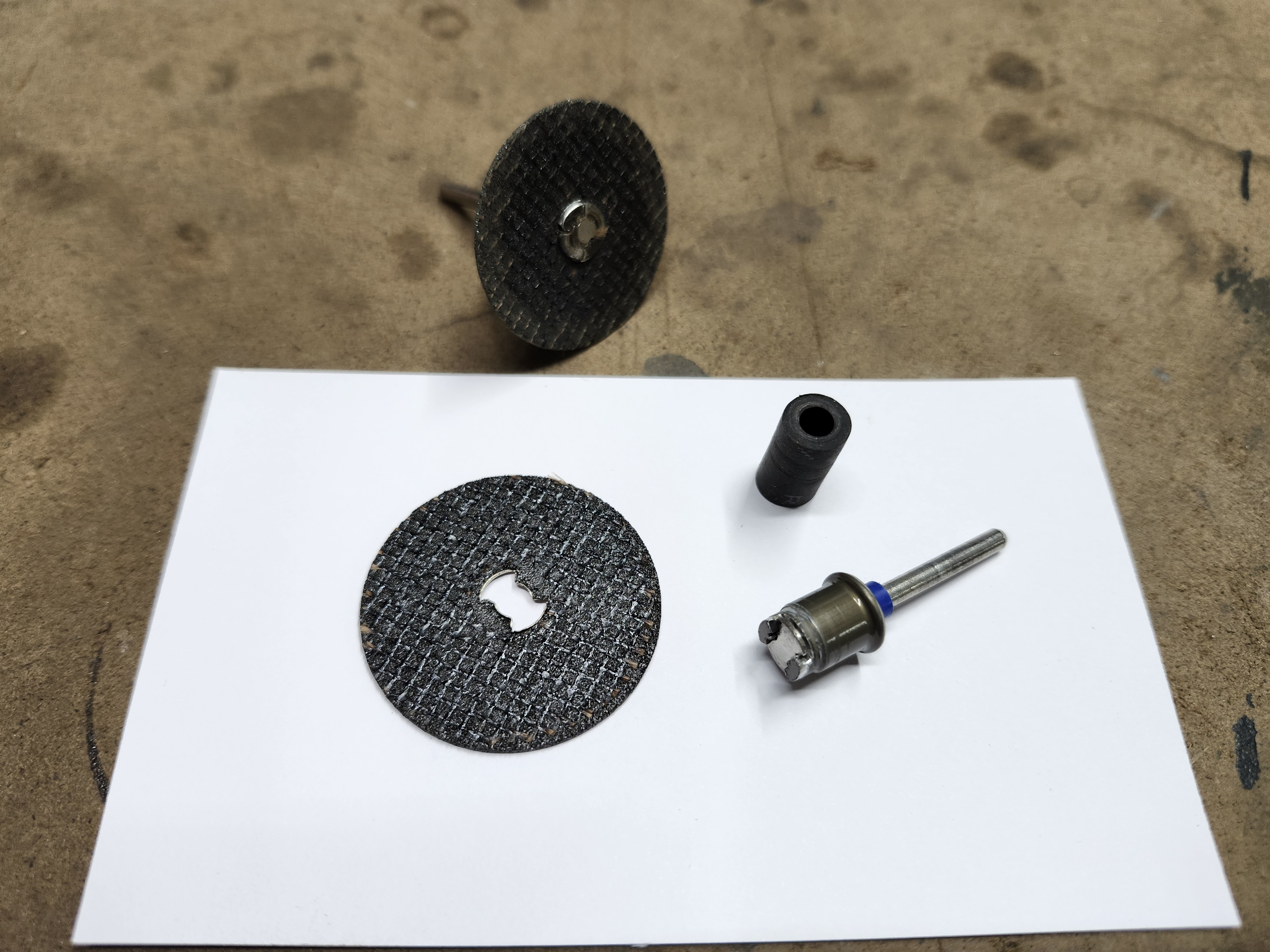

Some readers may be familiar with Dremel's EZ Lock setup for cutting wheels and other attachments. It is a spring-loaded keyed mandrel/arbor that accepts keyed wheels. The spring is soft enough to allow the cutters to be easily changed without tools, but not really stiff enough to reliably hold the wheel perpendicular to the shaft in some situations. This can result in a broken cutting wheel.
Attachment 47622 Attachment 47623 Attachment 47624

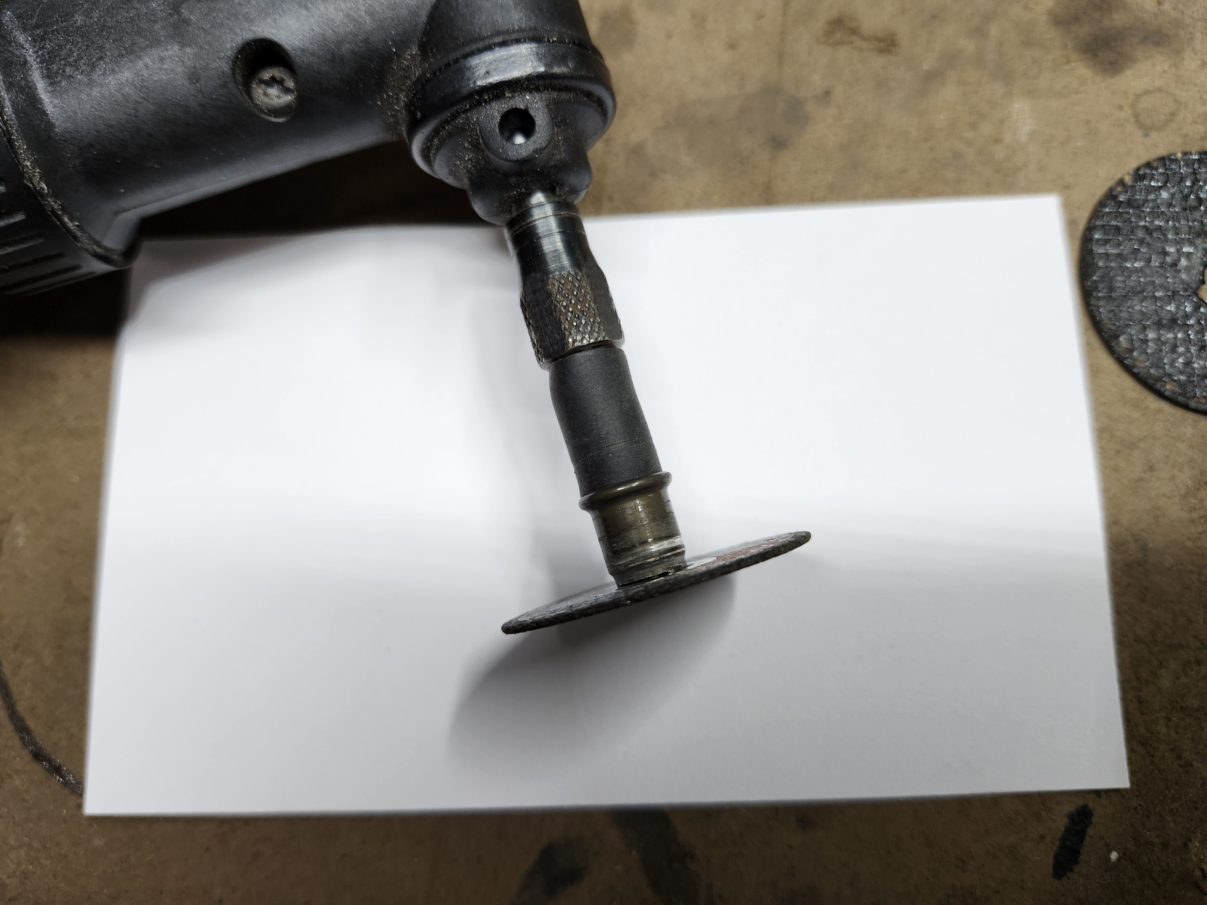

A small piece of rubber hose between the collet nut and mandrel helps. This one is 3/16" (5mm) ID and 5/8" (16mm) long.
Attachment 47625
