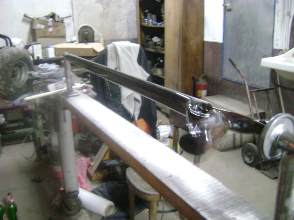

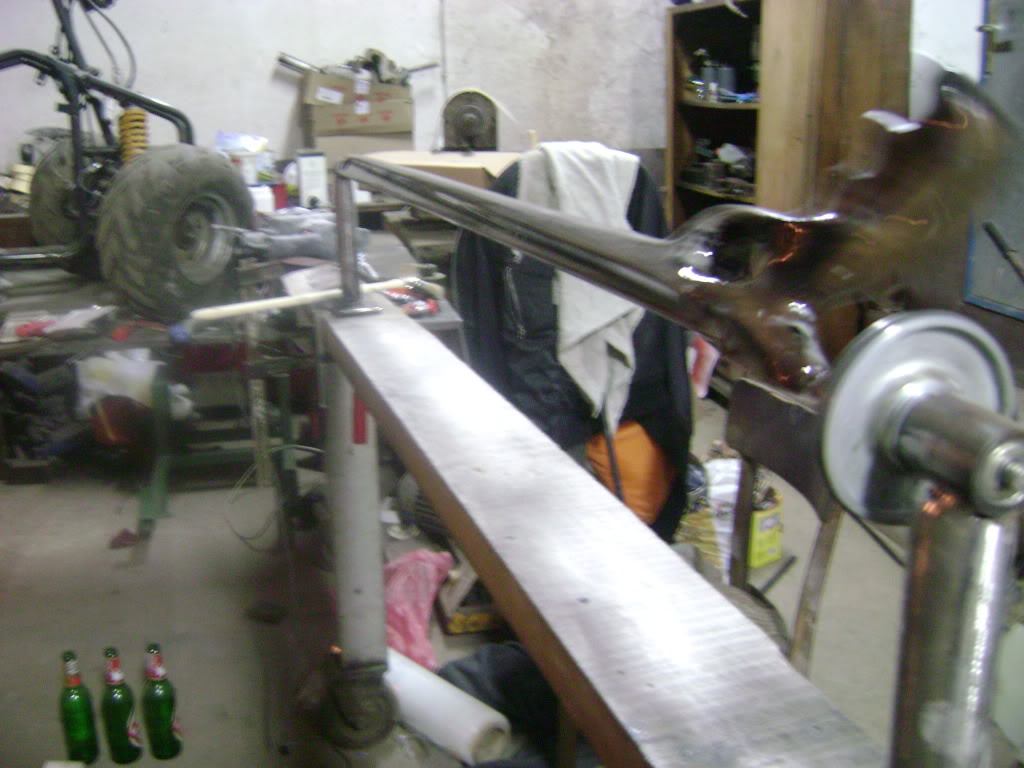

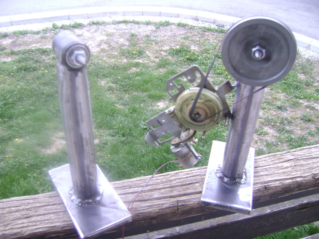

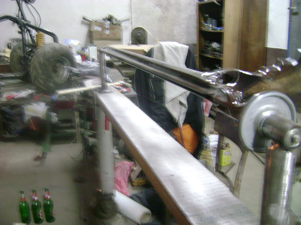

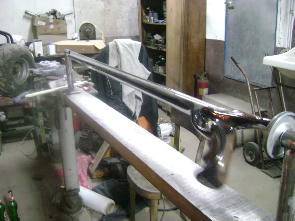

Old VHS DC motor, small tubes, bearings and battery 12V:
Not clear how do you apply a resin ??
Help please..
The epoxy resin is applied to the brush and the rotation creates an even layer of resin in circular shapes.
I guess that rotational speed is low to avoid centrifugal forces impact on paint collecting on the tip.
One short video would be helpful ...
10 rpm is fast rotation.
