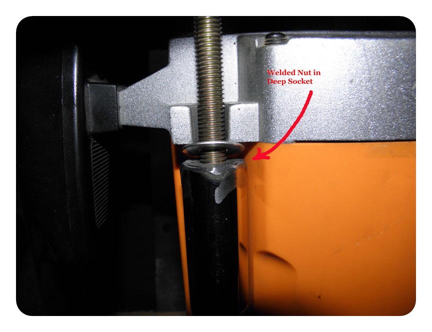

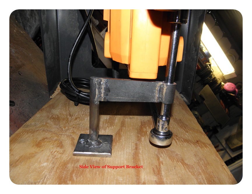

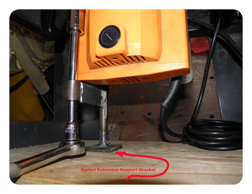

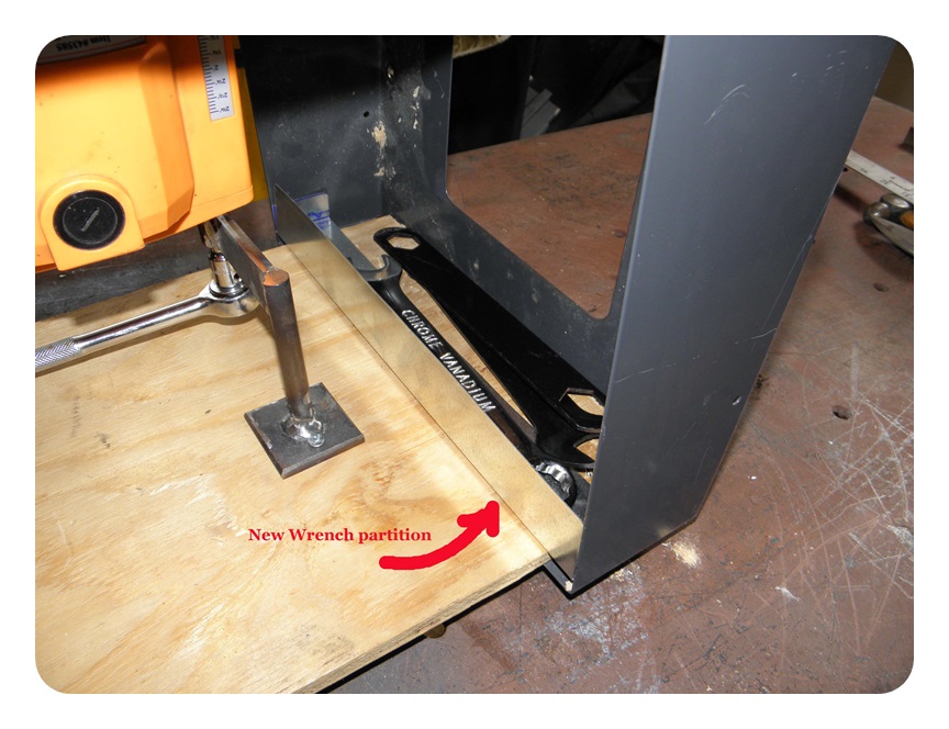

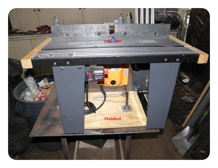

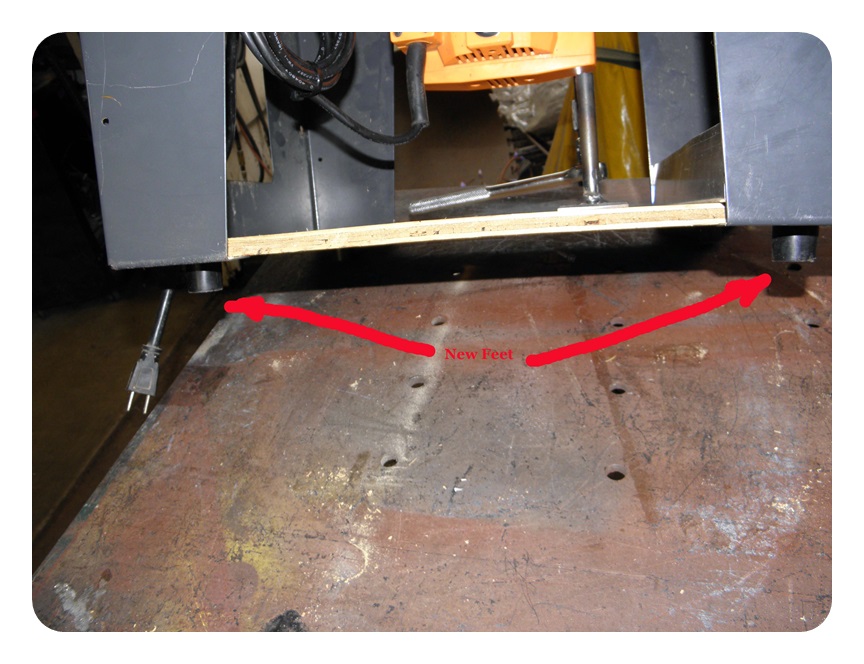

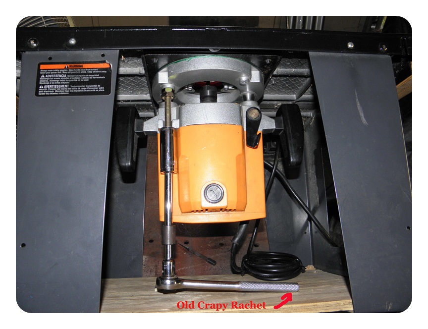

The other day I was routing some boards for my tool boxes and it took me 15 minutes to get the Vertical depth of the router bit adjusted just right, up and down it went never ending up where I wanted it to be hence this Router Mod. This Mod took 2 1/2 hours to make.
Router Table Quick Height Adjuster Modification. Made from 1/4 " steel plate, 3/4 " Round stock, Ratchet, extension, Deep Socket and large Nut.
