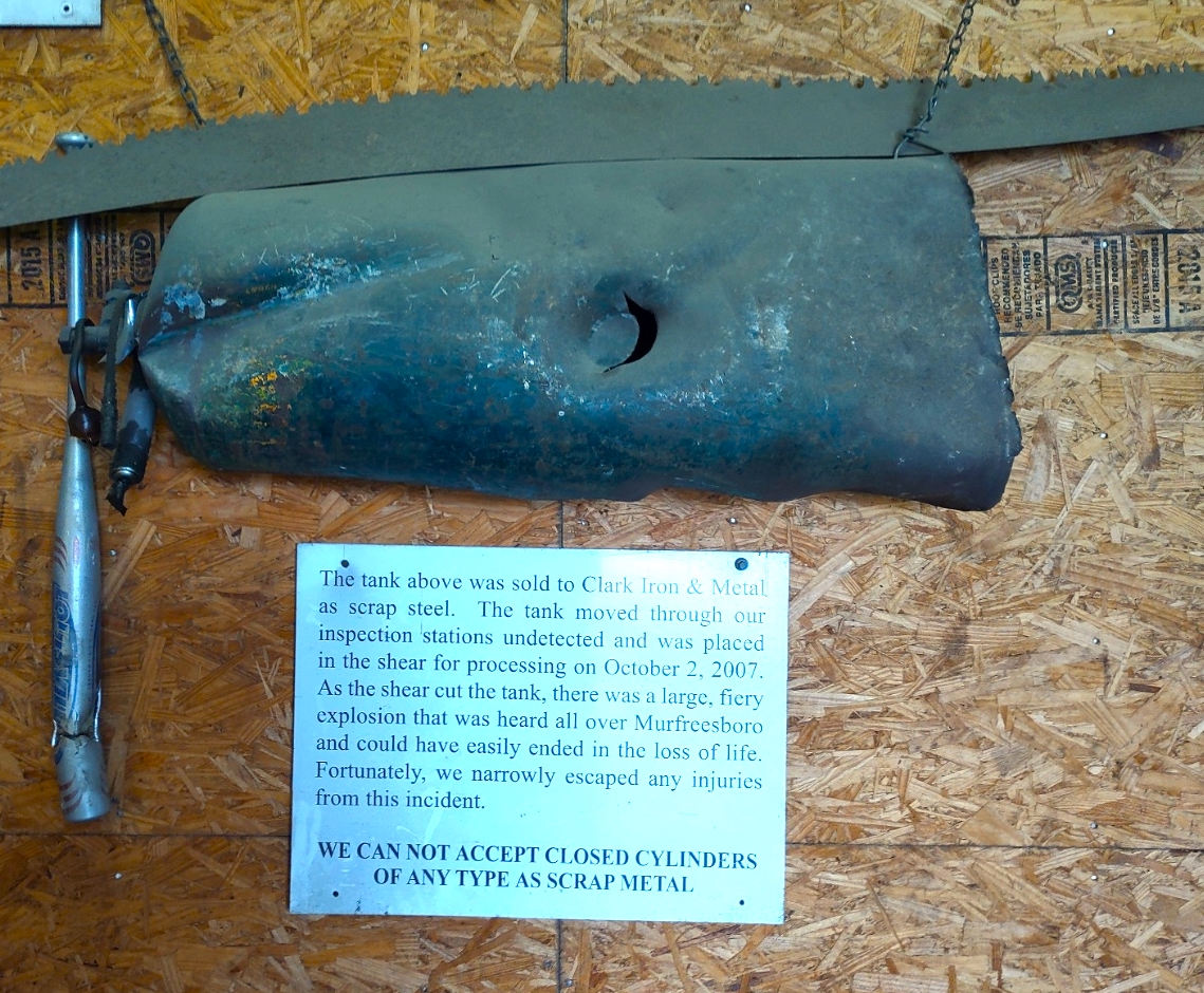

    The scrapyard I go to had one sneak through and go in their crusher. The sign says that when it exploded you could hear it a mile away. I'll try to grab a picture the next time I'm there.

    It took a bit, but I finally got back up there.

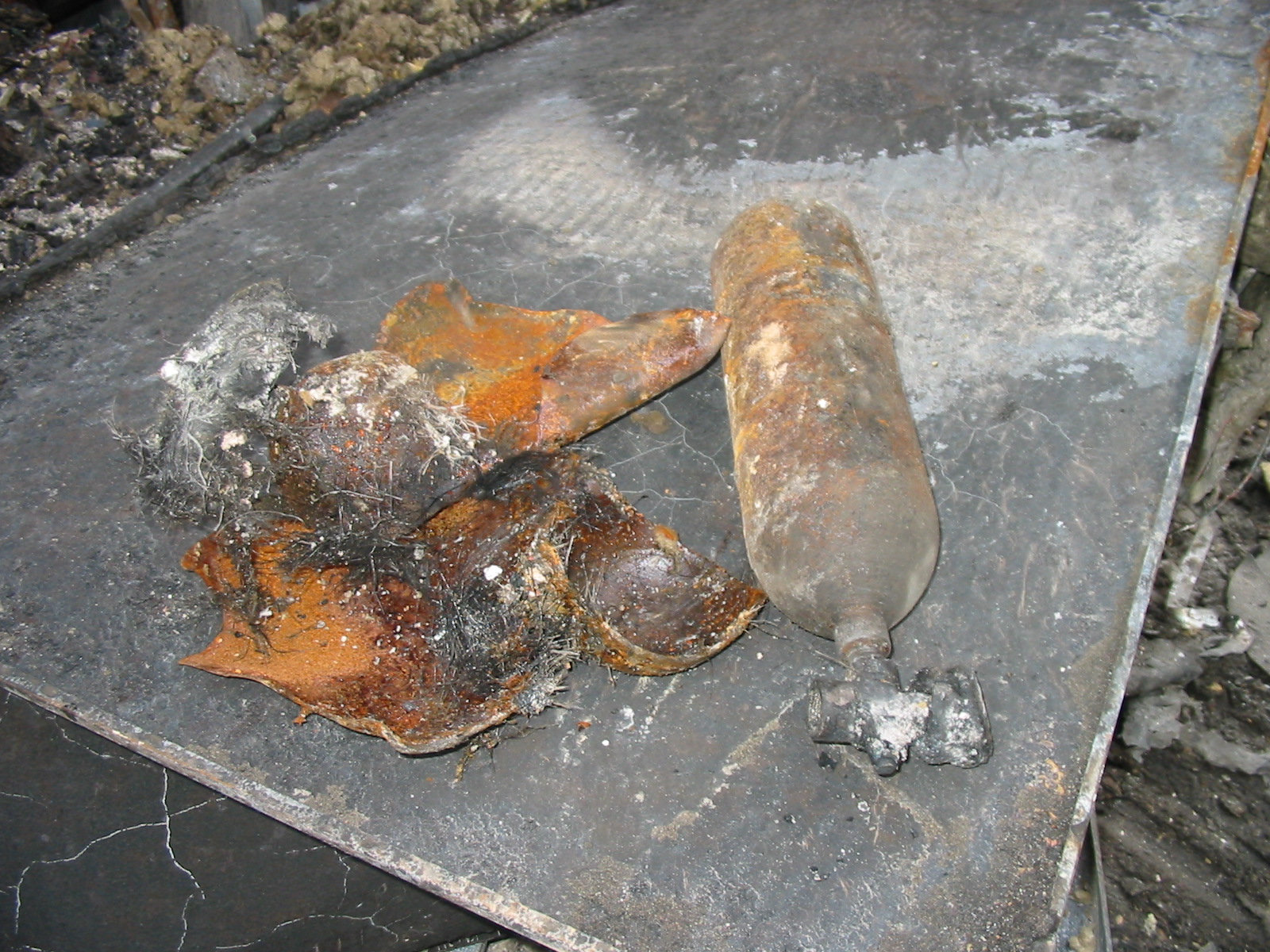

    Ruptured gas cylinder safety warning - photo-picture-039.jpg Breathing Apparatus cylinders involved in a fire at work, I have photo's of others split as above as well, the Dissolved Acetylene 'portapak' mini cylinder that detonated could only be identified by the neck collar, found 150 Metres away.

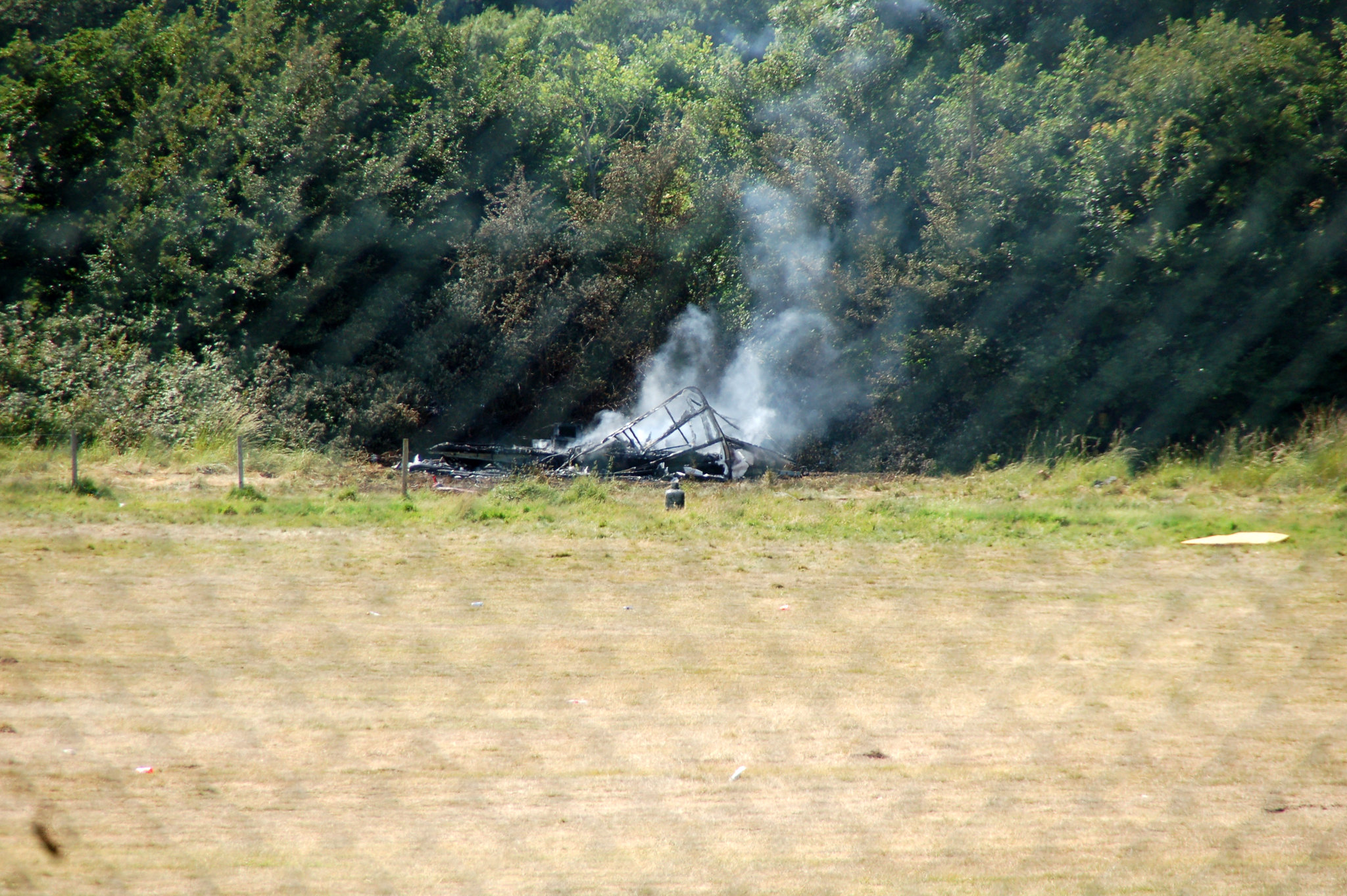

    Here in the UK certain 'mobile thieving b'stard stolen caravan dwelling do as they likeys' regularly leave 15 Kg cylinders in caravans they've replaced with a newer stolen model in the hope of it exploding to totally destroy any DNA evidence, intact cylinder recovered by Fire & Rescue': Ruptured gas cylinder safety warning - photo-5815614566_6959b5baa4_k.jpg
