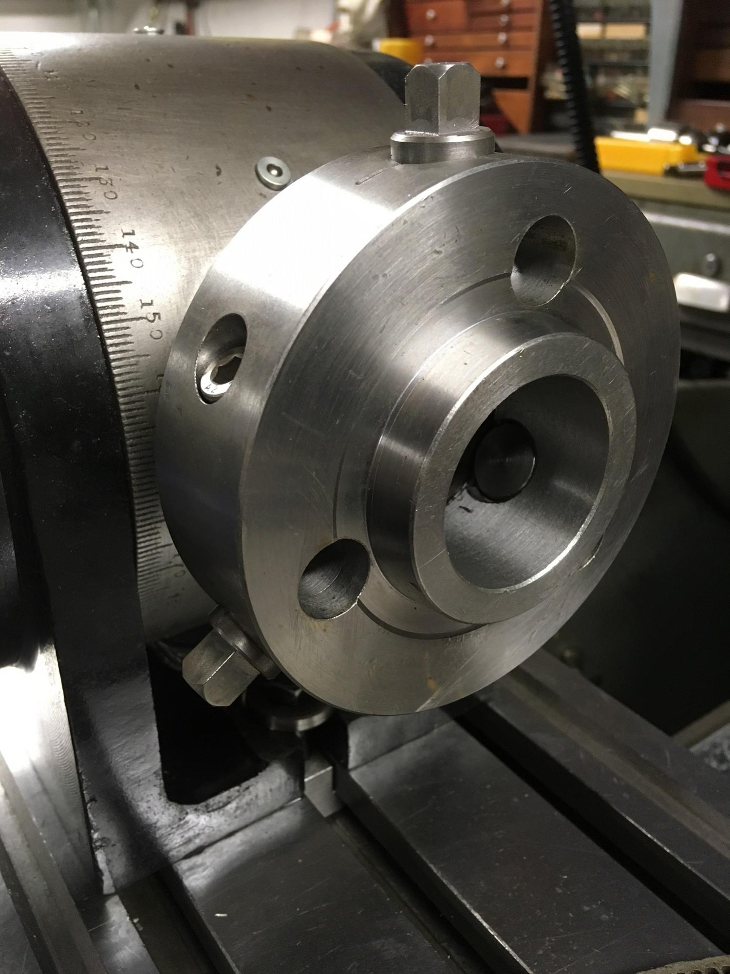

After using the dividing head, I could see the potential it could offer me at home being larger than the Hoffman and the opportunity to fit a D1-4 nosepiece so I could use all the tooling from the lathe 3-Jaw, 4-Jaw, collet chuck etc. So a full strip down clean and a new D1-4 nosepiece manufactured.

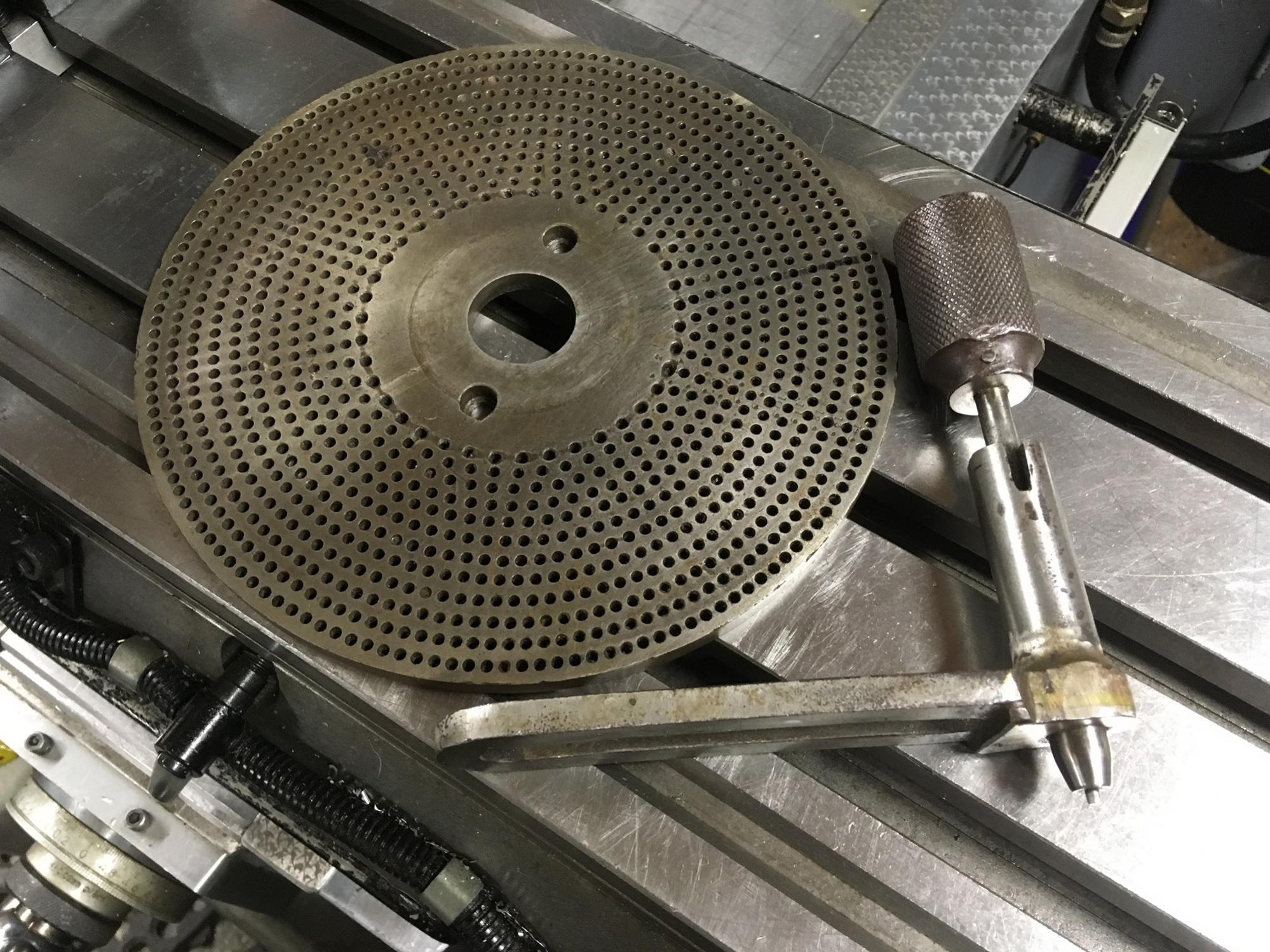

The large indexing plate and handle was very cumbersome and the handle was stiff to operate and had evidence that it had been broken in the past and re-soldered up badly.
A few years before getting this dividing head a had purchased a load of indexing plates at an auction which I was going to us on my rotary table (but never got around to it) So after a quick scout around the workshop I found them in an old cardboard box and decided these would be better. So new bushes and hand crank was manufactured and fitted.

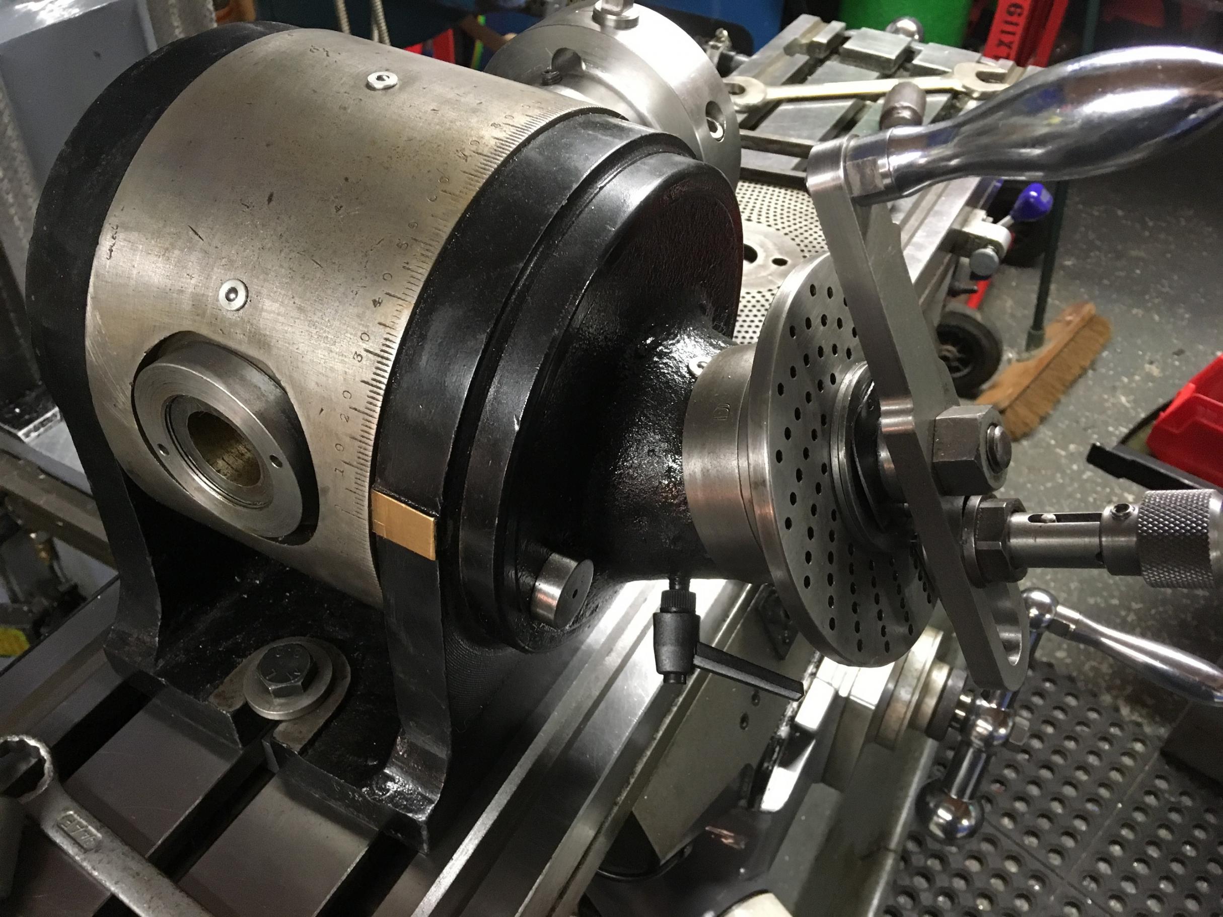

The bottom of the dividing head was flat so I machined a groove 5/8” wide 1/8” deep in the bottom parallel to main spindle, drilled, and tapped two holes to accept dogs to fit tee slot for quick alignment.

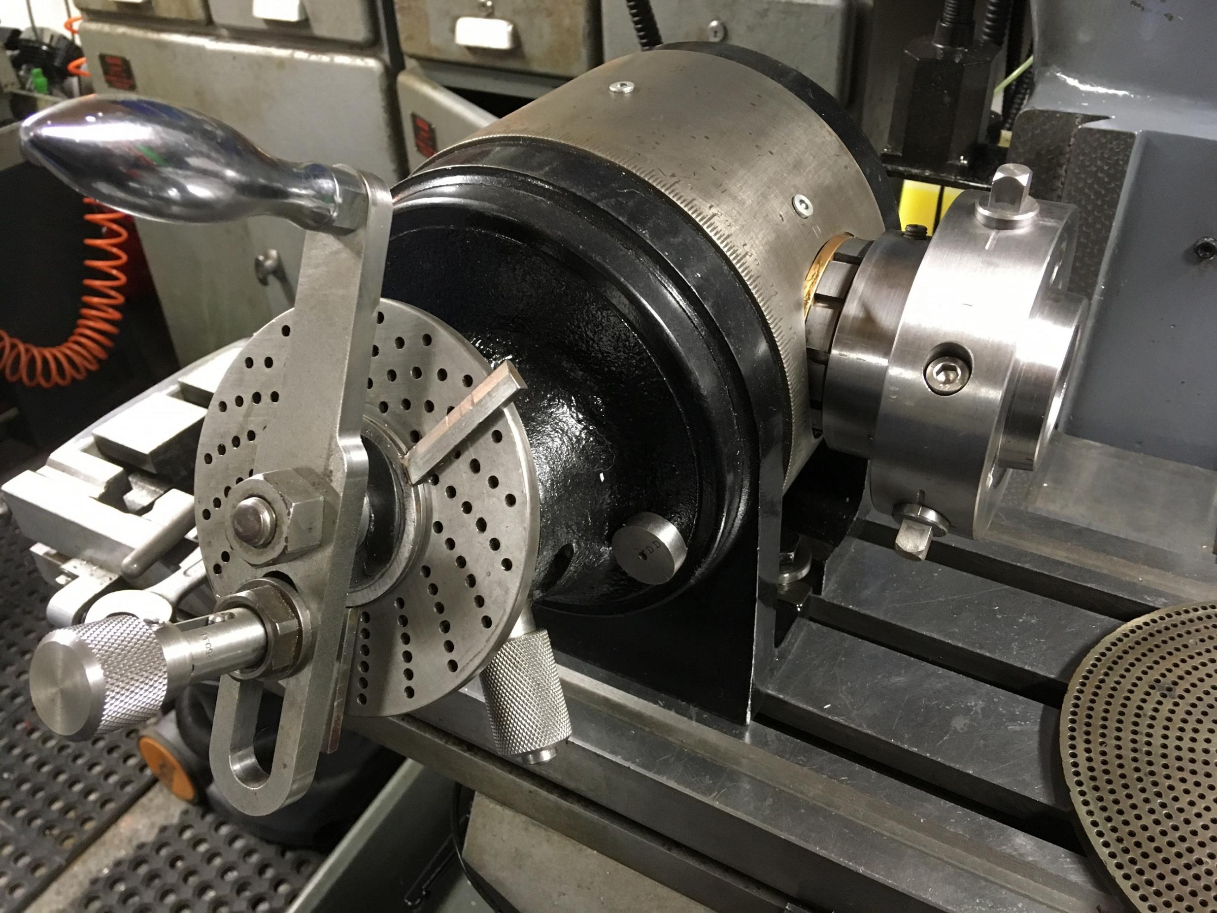

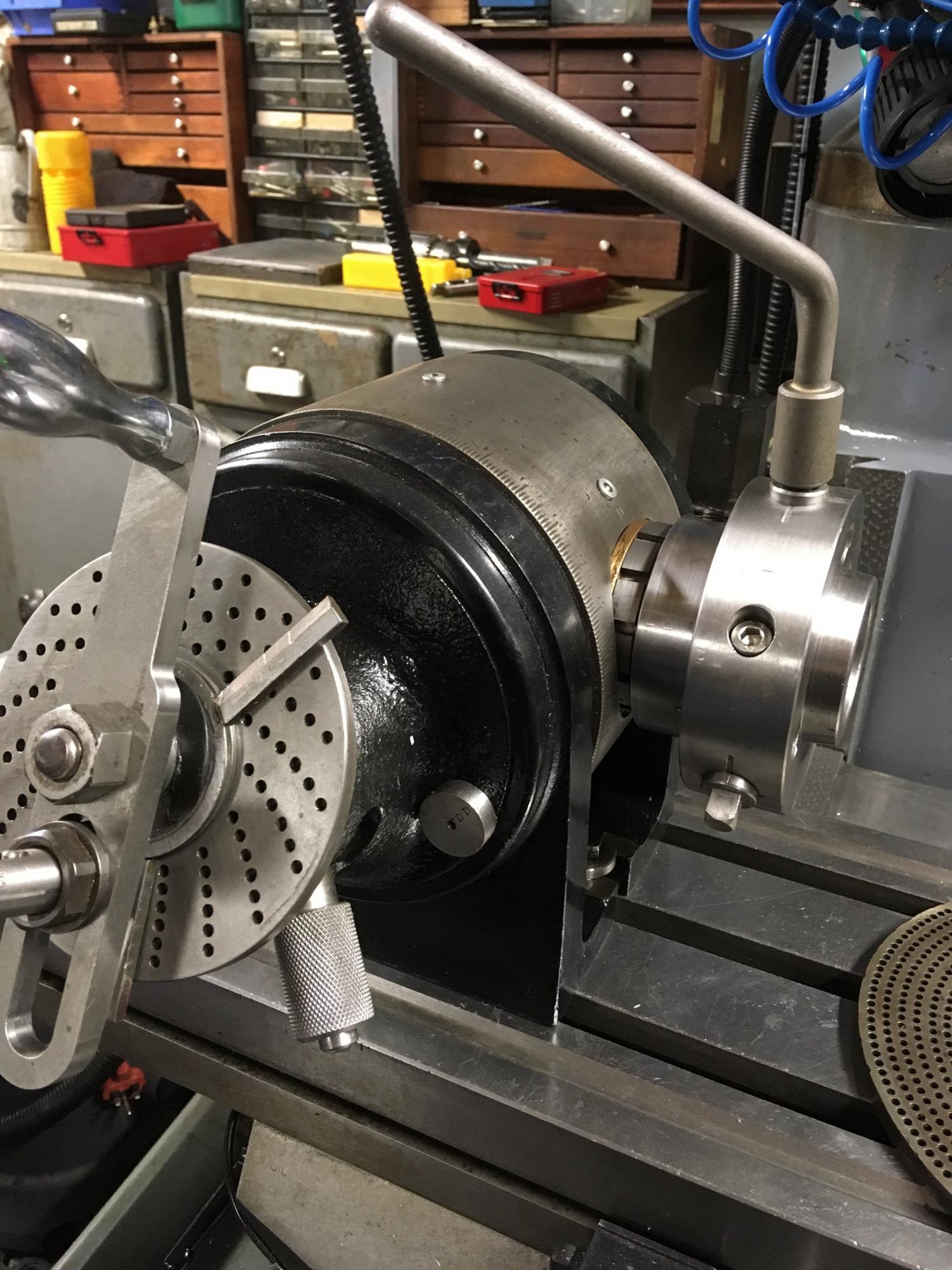

The photos show the dividing head finished but unfortunately, I do not have any pre-refurbishment photos, but believe me it was a sad looking thing.
Old indexing plate and crank handle
Attachment 22566
D1-4 nosepiece
Attachment 22567
New crank handle, bushes and the purchased indexing plate (I have a full set of plates)
Attachment 22568
back view of dividing head
Attachment 22569
Homemade square head spanner for locking D1-4 cams
Attachment 22570
