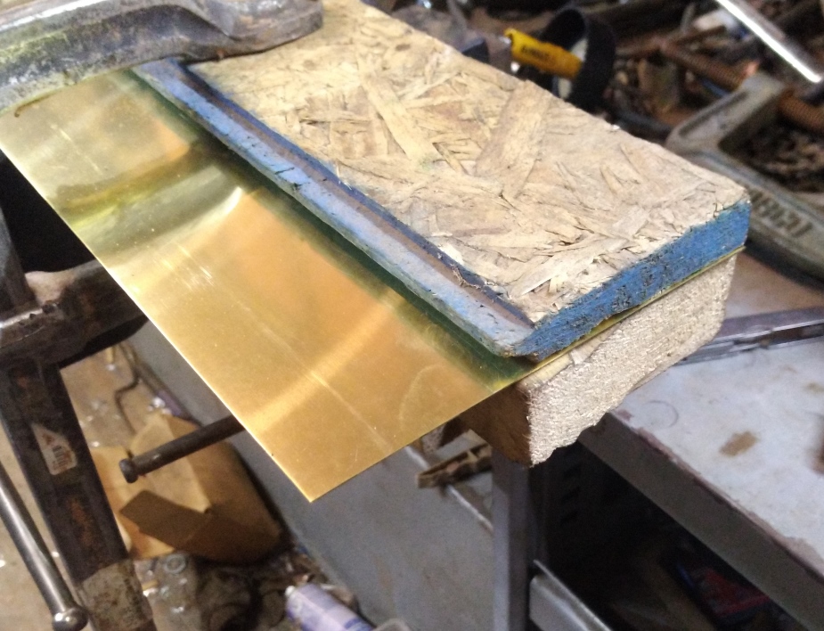

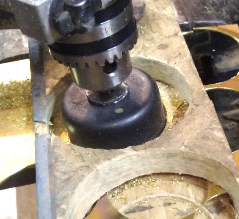

I find the best way for me to cut holes in thin materials is to clamp them between 2 pieces of wood as a sacrificial drilling fixture
Attachment 42493

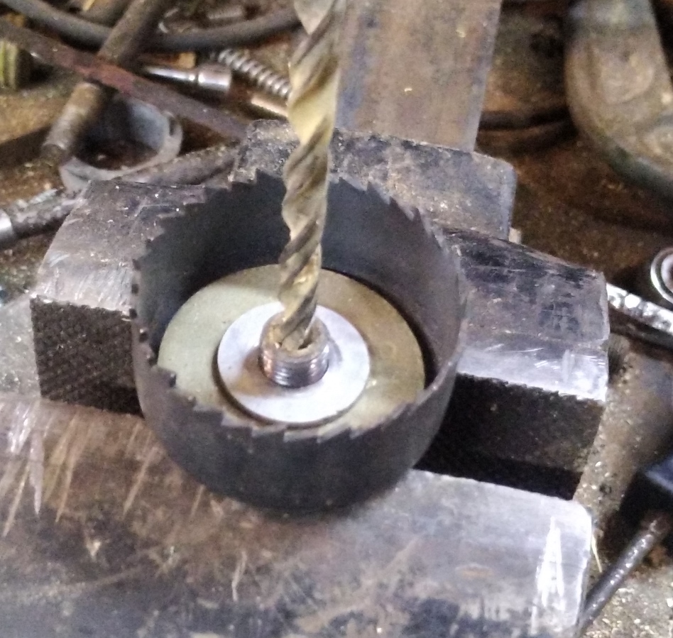

In this case I need to drill 2 sized holes in the brass shim stock

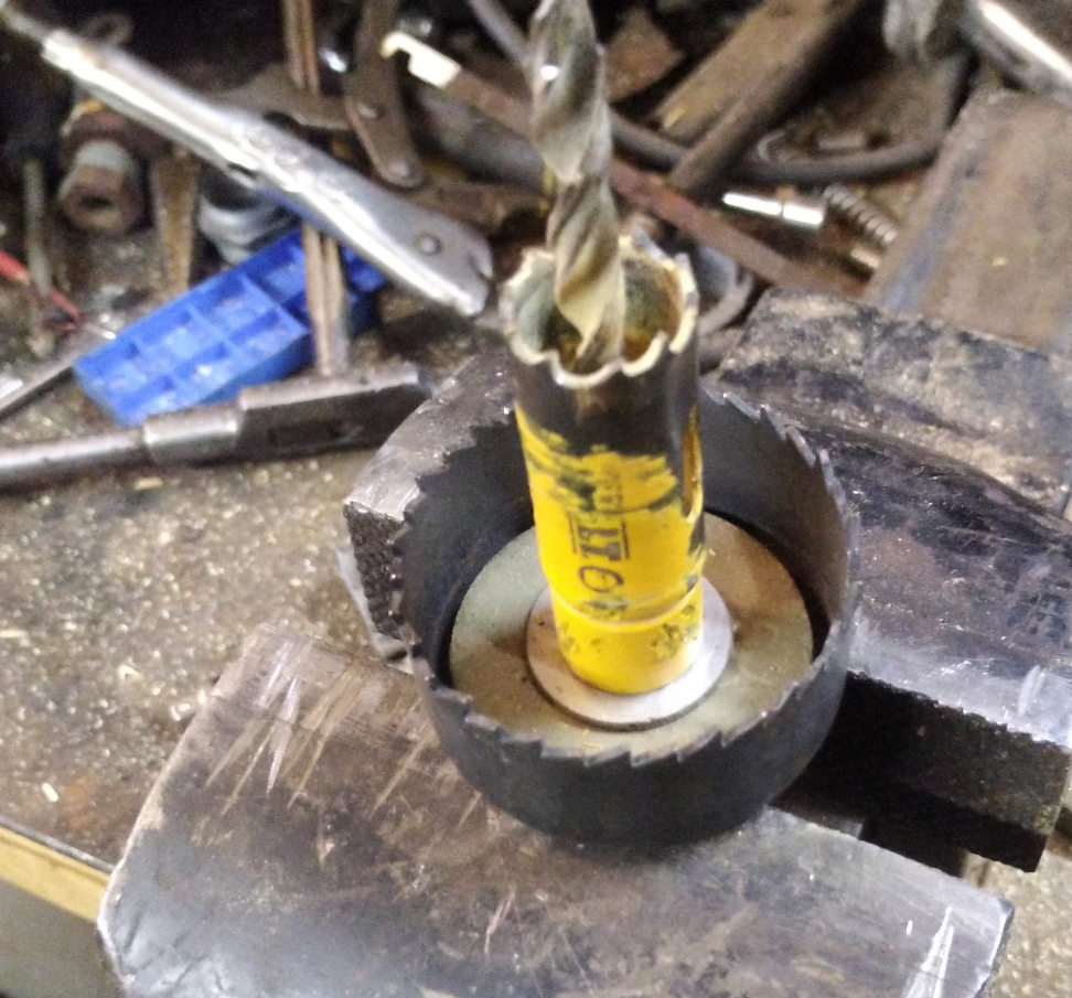

First the small hole
Attachment 42494

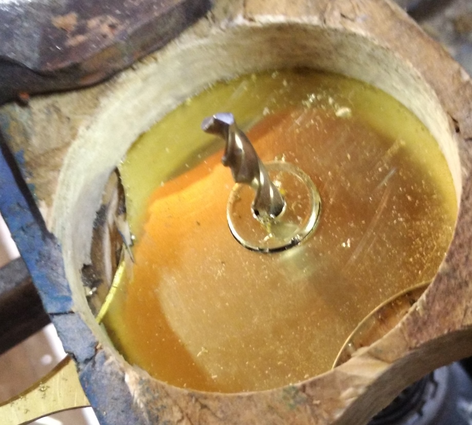

then the large hole and drill through the stock to create the part
Attachment 42495

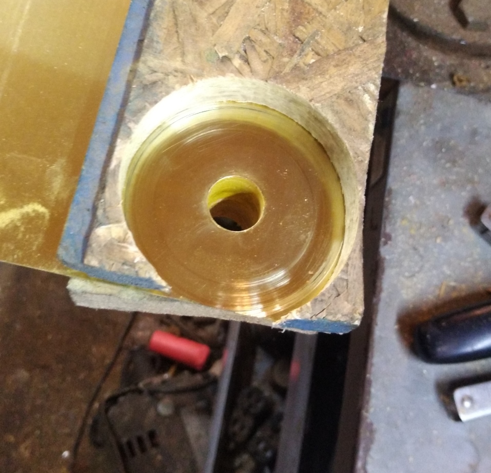

Since I needed multiples of what I was making in 2 sizes after making the large diameter shims
I changed the 3 1/2" hole saw out for a 2 1/8" so I could make 2" shims
Attachment 42496
Attachment 42497

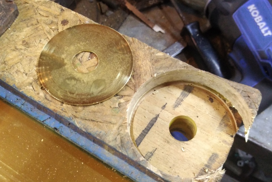

Now drilling up from the bottom the 2/4 becomes the guide for the 3/4" hole saw
Attachment 42498
I then finish off by using the 3/4" hole in the shim and the 2x4 as the guide for the 2 1/8" hole saw
Attachment 42499

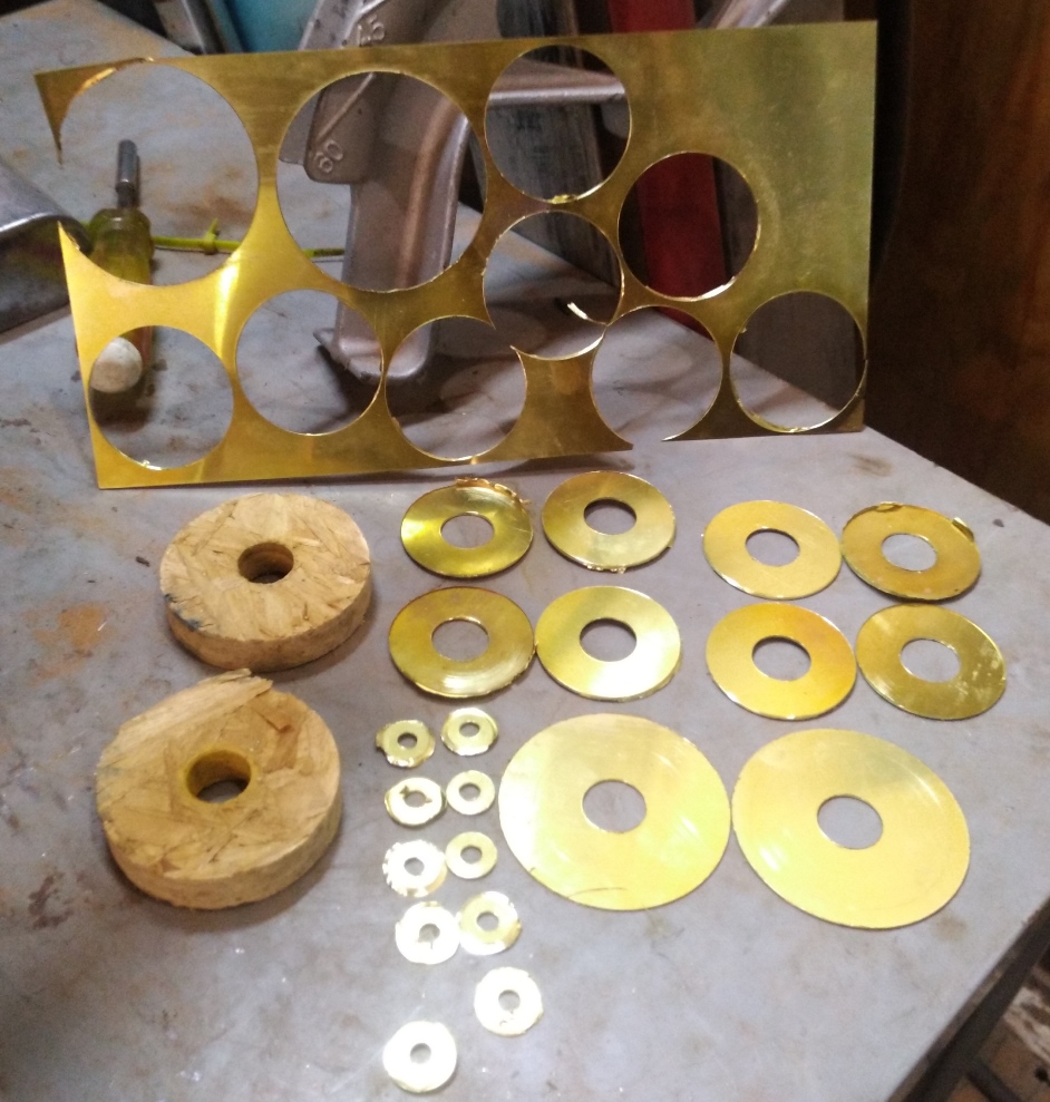

Large & small brass shims plus a bunch of 1/4" brass washers as an added benefit, with a couple of OSB disks thrown in for good measure
Attachment 42500
