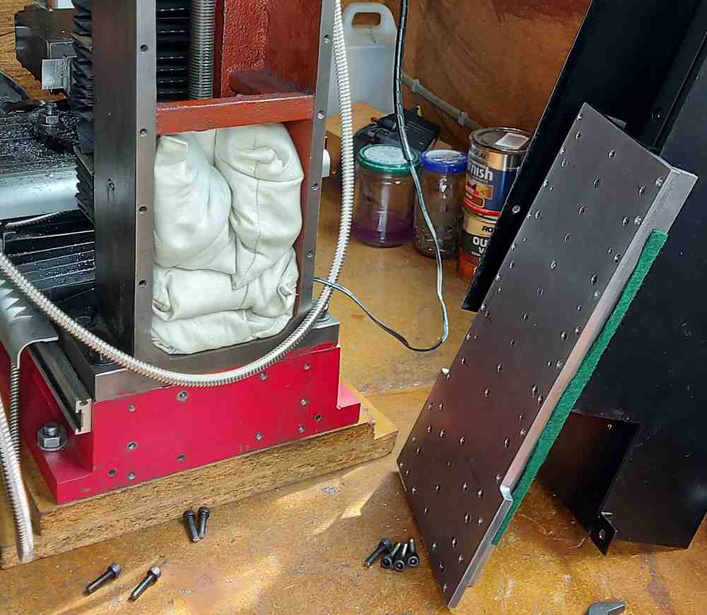

Just made up some small sand bags to fit in a cavity of my milling machine and damp down the vibration.
Attachment 39819
This idea though could be applied to other machines. Just take care that the sand and bags are secure and cannot get caught in any moving parts.
