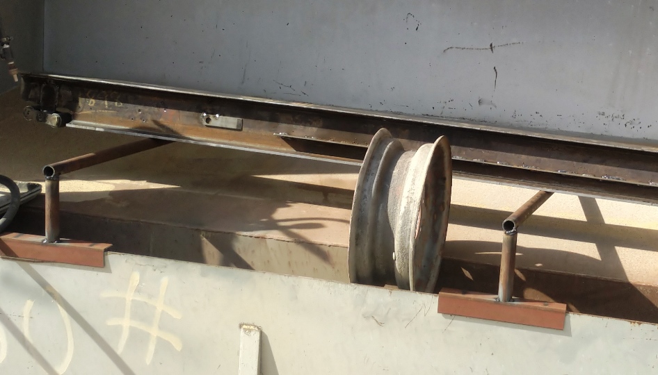

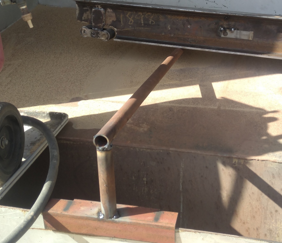

When media blasting it is best to have what ever is being blasted supported away from the surface
Here are my support bars for my media blast booth

There was a compound reason I made and put the bars in the booth. First and foremost, to have a smaller surface contact area of the parts being cleaned.
Secondly, by having the parts elevated from the bottom of the booth this allows the media a clear pathway around the parts to fall into the collection trough.
Must make it easier loading and unloading larger parts as well I would think. I made a table out of square tube, angle iron and open mesh treadwalk that does essentially the same thing but for smaller stuff. All breaks apart for storage on a couple of nails hammered into a roof cross brace.
Handy for painting multiple small items at once as well.
