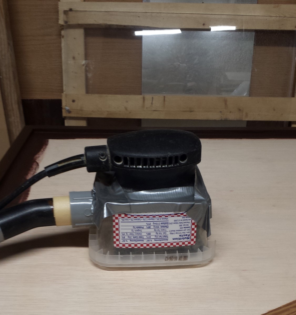

Sander Vac attachment
I needed to sand some patches on the walls in the bathroom and didn't want dust all over the place. The vacuum hose is stuck into a 1 inch PVC threaded connector. The connector is fastened by a locknut through a hole drilled in a potato salad container. Duct tape closes off the gap around the sander.
