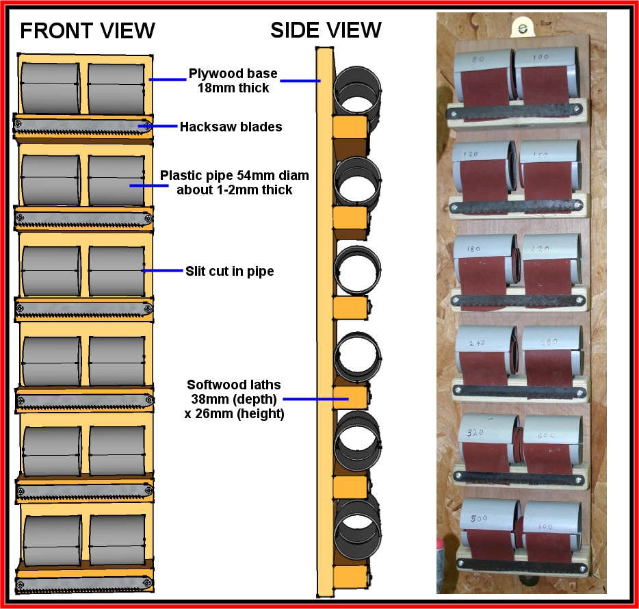

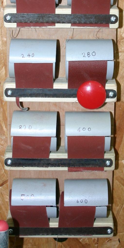

Have just made myself a sandpaper dispenser for sanding lathe work which both makes the various grades accessible and dispenses by using tear-off plates made from old hacksaw blades. Adapted from an original idea which once appeared on the Laymar Crafts website. Click HERE for construction details.
