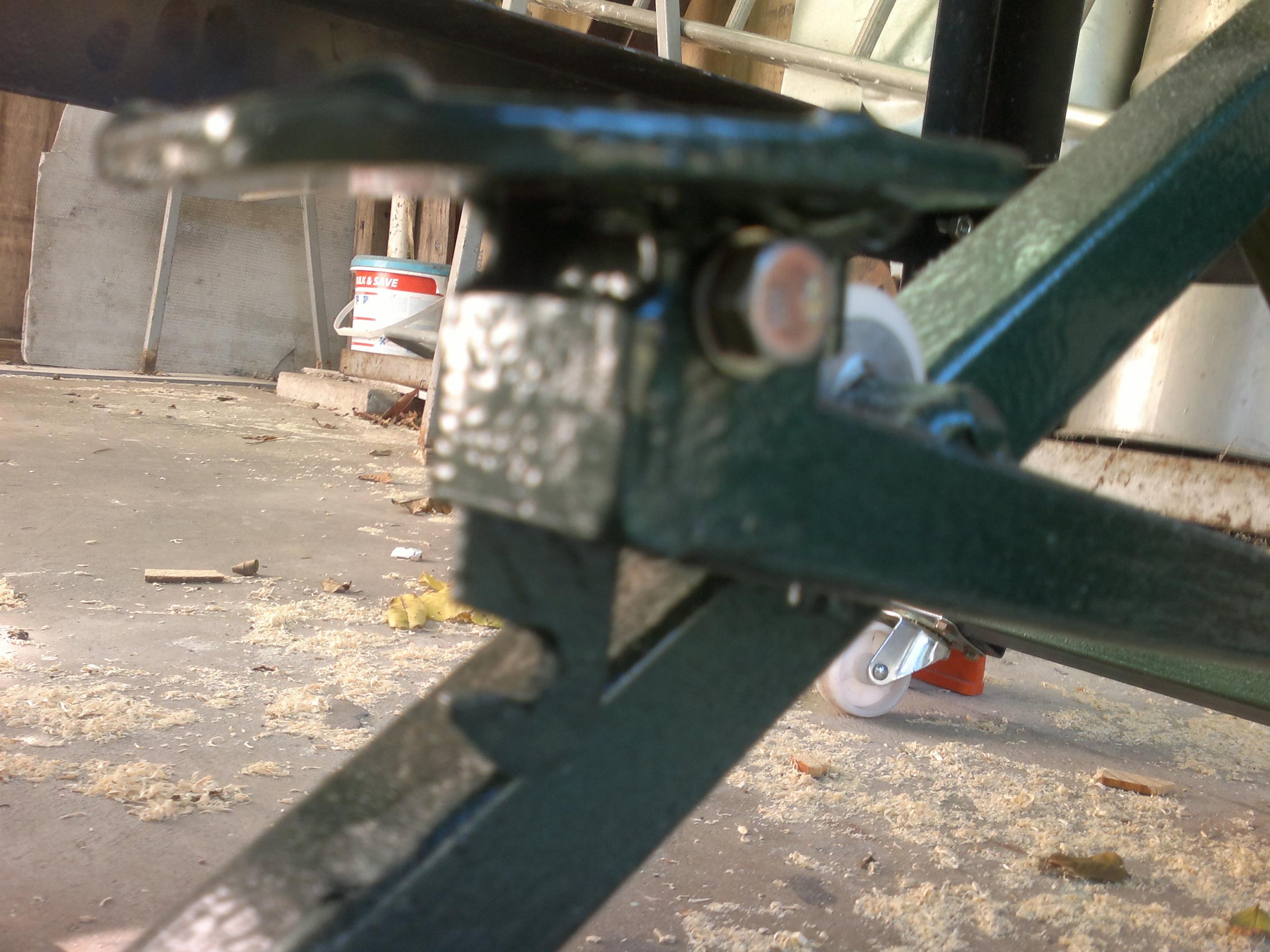

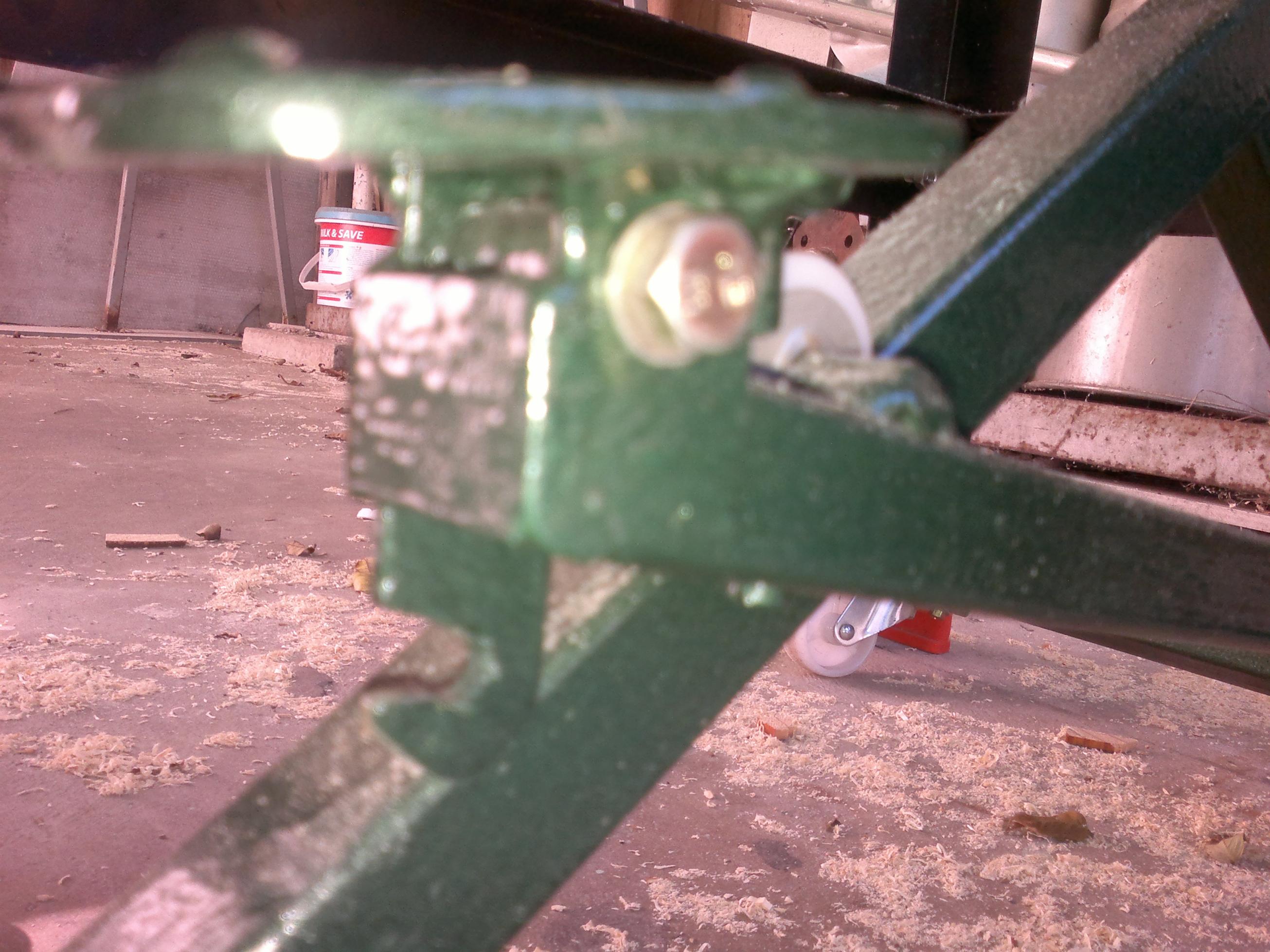

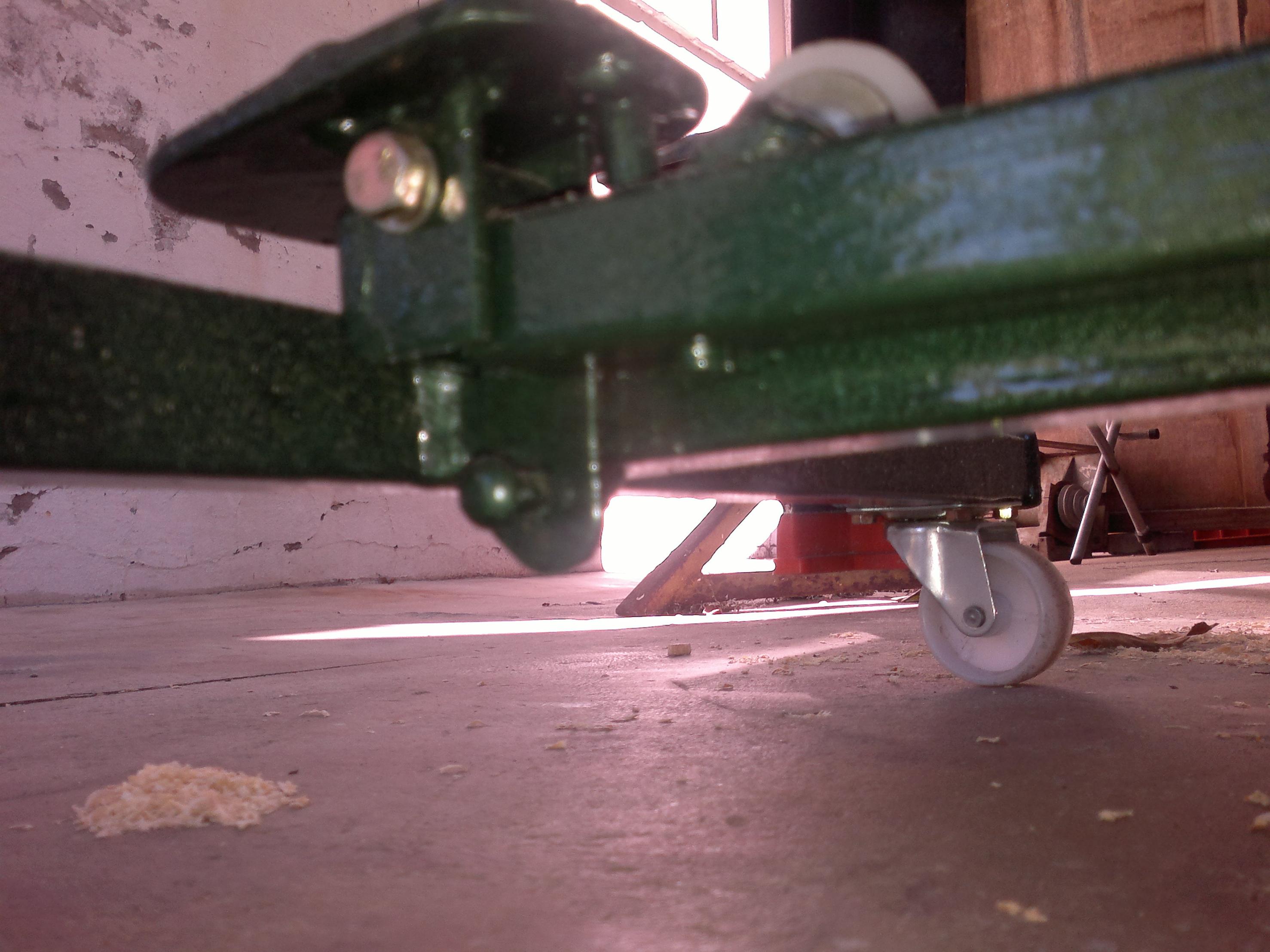

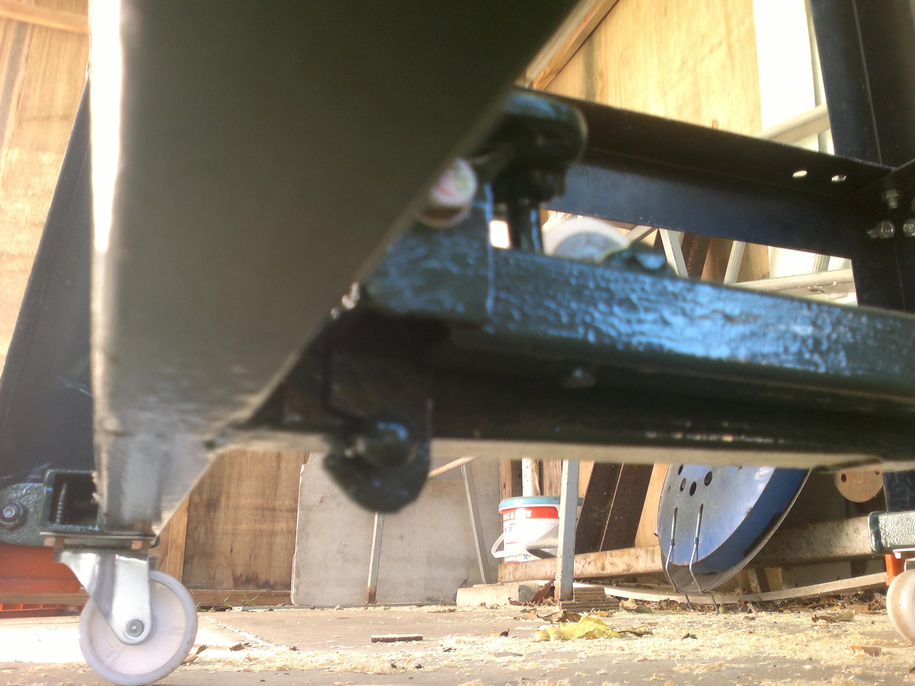

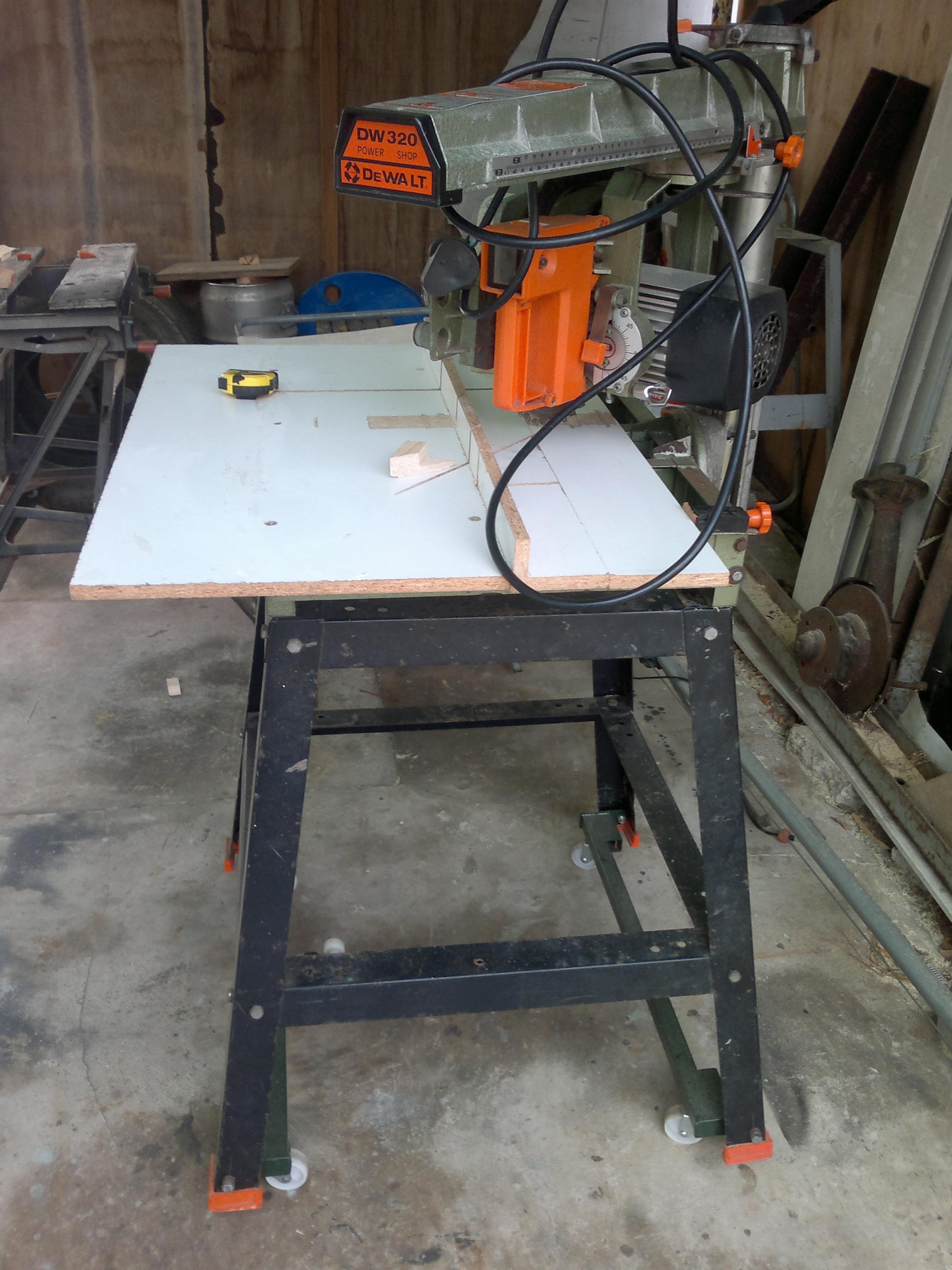

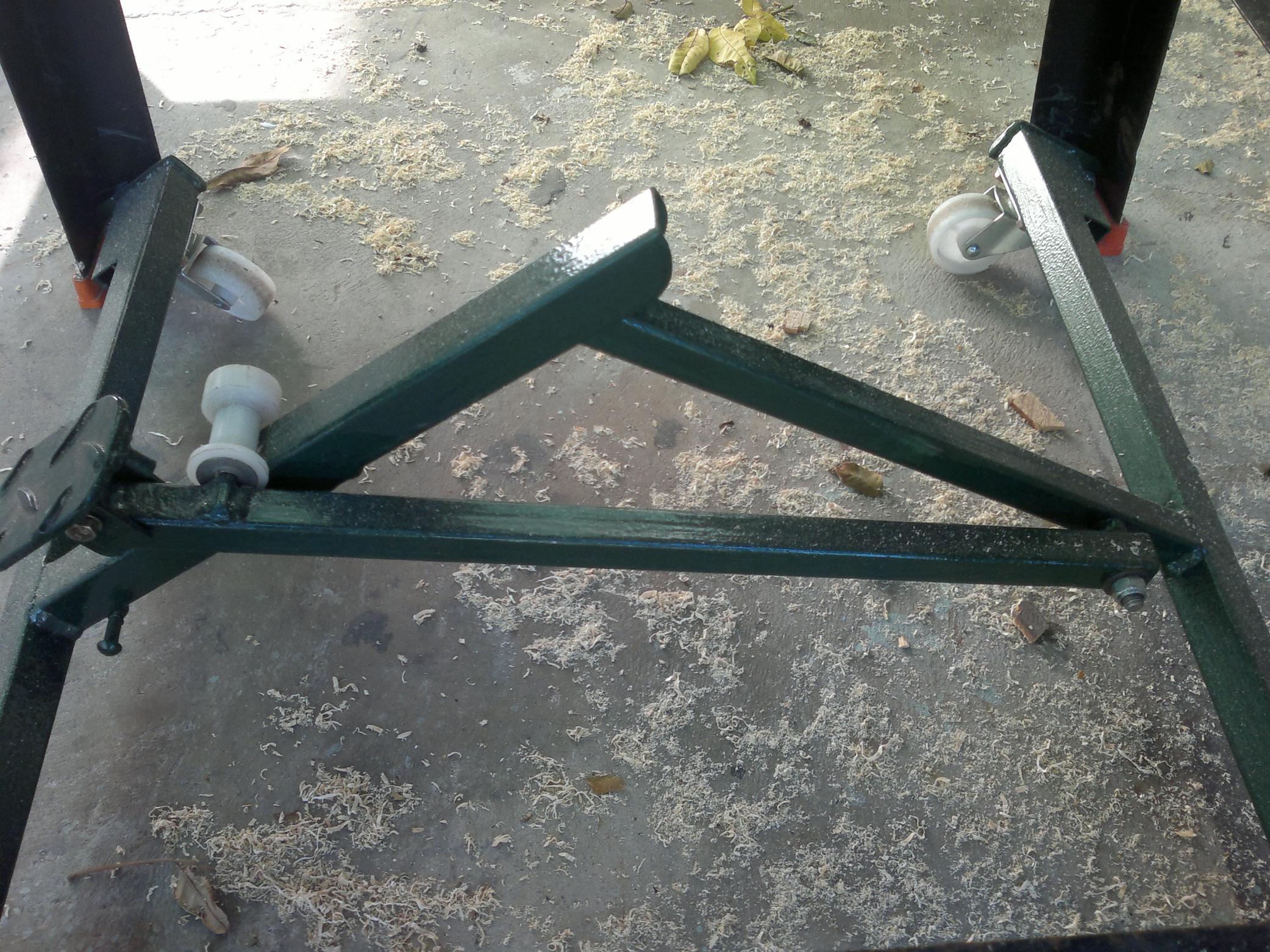

    So I made this some 2 years ago but just did'nt get to upload - my shop space is tight so I put everything I can on wheels!
    To further the problem , I do a mix of things , paintwork , machining and of course a bit of wood work amongst a myriad of other things , needless to say , dust from wood work is a problem , so I prefer to move my saws etc outside.
    Latest addition was a light radial arm saw and this is where the issue came in , to be able to move it into working position on wheels but have it stand stable enough to use , then wheel it back into a size fit space allocated to it's storage.
    Also with enough ground clearance to wheel it across the lawn when required.
    This is what I came up with , works well , save for the fact that I used 4 swivelling , lockable castors which at some point I will change out to 2 fixed and 2 swivelling.
    Oh , and it needs a spring to keep the ramp from disengaging should it be suddenly dropped.
    Will post a video in use as soon as I access the machine again.
    Maybe useful to someone out there!

    What I like most about your design is the single point step on pedal to lower the casters raise the saw and lock in place all in one smooth motion then to lower the saw back to the ground you merely have to step on the pedal and rock it to unlock. No having to bend over or raise each corner one at a time.
    Great job this really gets a thumbs up

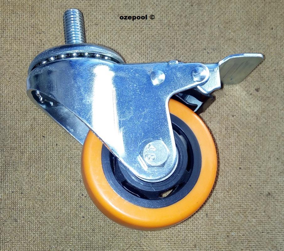

    Nice one, I'm making a square stand with a bench grinder, a buffer, a linisher and abrasive drop saw, i also need it outside for the dust. I have the Chineseium wheels, 2 with brake, just could not work out how to elevate the stand. thank you for the idea, I may have to lengthen the pedal arm as the 4 machines maybe a bit heavy to push up, Bob
    PS, do you have a better pic of the lock?

    I've pondered solutions to a similar issue, but instead of weight, bandsaws have little ground clearance. This elevator is better than what I've mulled so far. Instead of lengthening a fixed pedal.........telescopic!

    Yeah , one of my biggest issues around this build was indeed ground clearance , which is a function of the centre of rotation around the diameter of the wheel / castor used plus it's cantilver bracket.
    With this setup I get almost 2 inches of clearance , and that can be extended slightly by wheel choice and position of wheel mount on the cantilever.
    The obvious is , the square size of the frame plus the wheel arrangement determines the apex of the lifting cantilever.
    Some marginally better pics of the lock - if need be i'll upload some fresh ones. Maybe dis-assemble the pedal for some better detail though it's quite simple , has no spring or anything , works a bit like an old fashioned gate latch - sorta!
    Oh , erroneously, I said I used locking castors , that was saw # 3 , because of the design , locking castors are inveneral to the stablilty as it is standing firm on it's feet!

    Frank makes a valid argument here and it must be said that it would be ill advised to use this system on a piece of equipment that is inherently top heavy.
    I have my Sprunger saw on wheels as well and it's not something you want tipping over.
    It has to be moved with extreme caution and only from the outrigger style motor side. The casters on this are very much outboard as well for a degree of stability.
    Some pieces of equipment are not meant to be moved around and indeed should'nt be!
    Let common sense and good judgement prevail!
