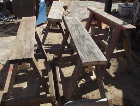

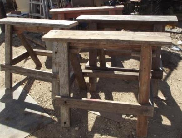

Saw horses from scrap wood
I was down to only 1 wood saw horse and need 2 for an upcoming project
My steel work horses are too heavy and would cause damage to the project since it to will be made out of wood

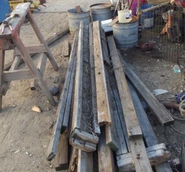

I started out with some scrap 2x4s from a pile that I have been using as fuel for a shop heater they were not good for much else other than maybe a chicken coop
So I pulled the nails and cut 12 pieces 32" long to be the legs
then 9 pieces 34" long to be the braces and top bar
then 6 blocks about 6" long to hold the legs at their angle.
the end braces were just marked and cut after the legs were screwed in place I didn't bother to measure them I just marked 1 then cut 5 more just like it
I like having a wide flat top so U ised some scrap 2x8s for this cut to 42" long
