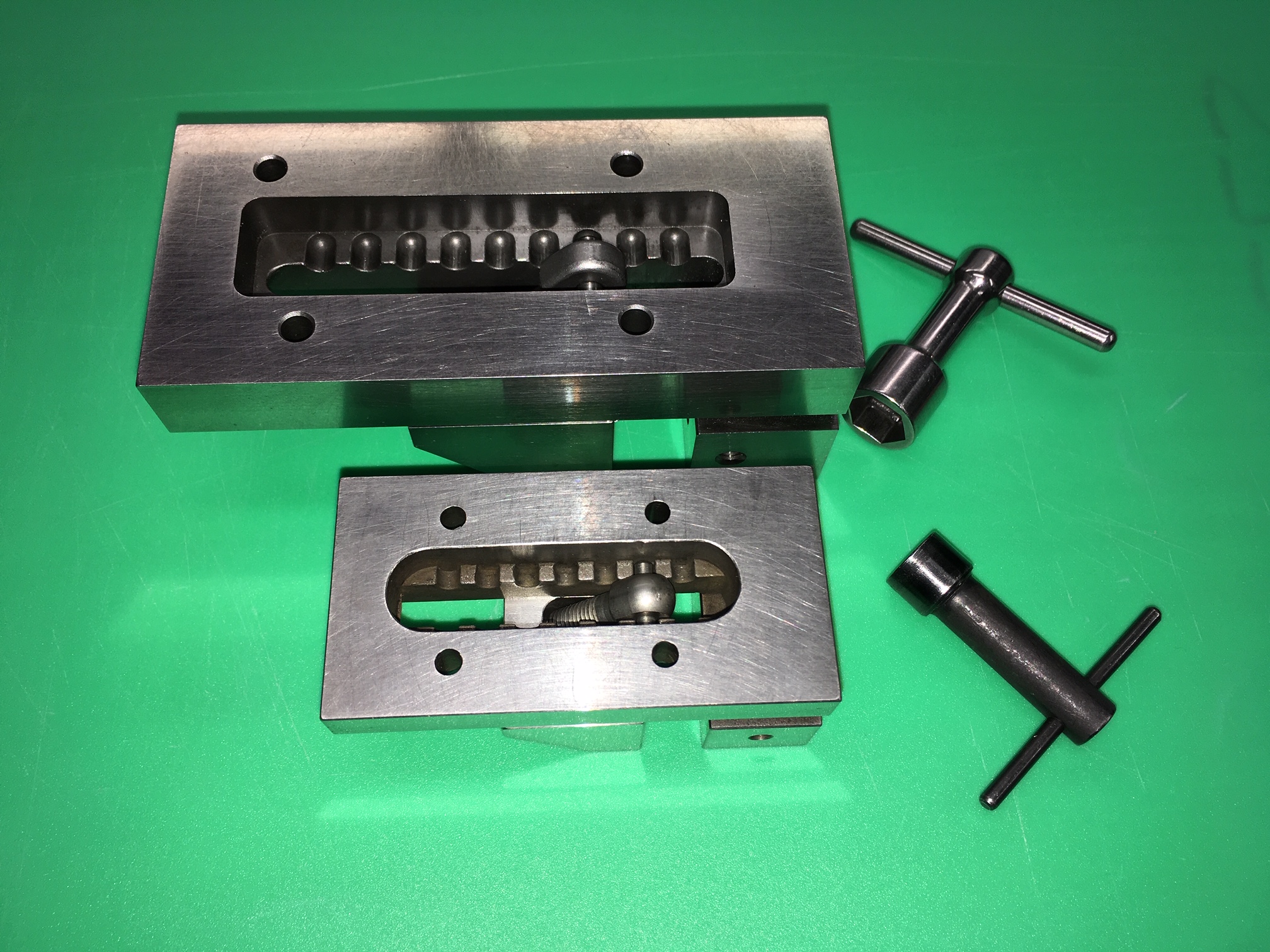

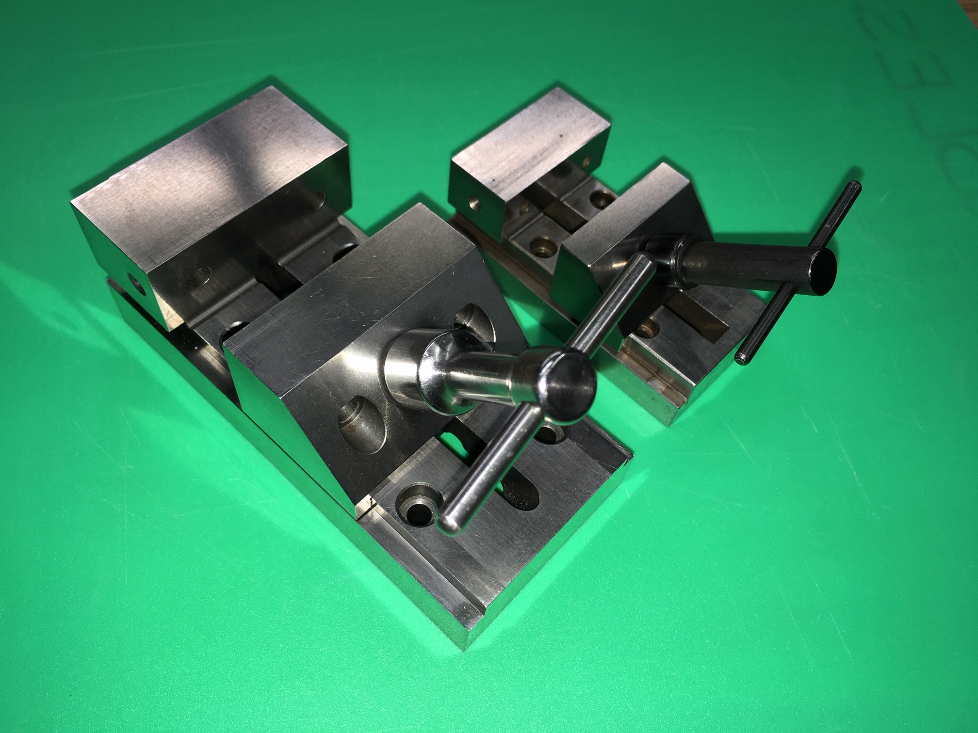

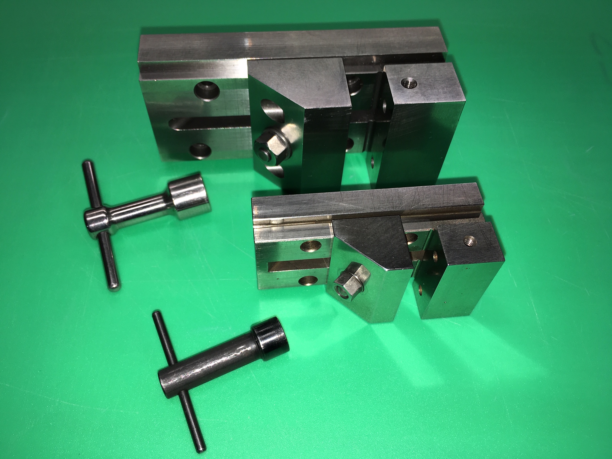

    This is my first attempt at posting on this site for over two months since I suffered a stroke and seizure back on 10-31-2018. I am slowly recovering and It sure feels good to be back on this site although I am not yet making chips out in the shop.
    I built this set of scale model precision grinding vises about 50+ years ago based on the well known Herman Schmidt vise. The larger vise is 2/3 scale and the smaller one is 1/2 scale. I have used them since they were built and they still serve me well today. They are precision ground to size and square to within .0002". Enjoy!!
    Attached Thumbnails Attached Thumbnails Scale Model Precision Grinding Vises-dick-vise-.jpg   Scale Model Precision Grinding Vises-dick-vise-b.jpg   Scale Model Precision Grinding Vises-dick-vise-c.jpg
