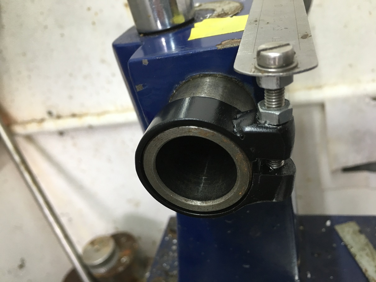

Always wanted one of them, but no 12mm Ali lying around of DRO vernier, So what is in the scrap bin?
Piece of 32mm Pipe and some 10 x 10 sq bar.
After some welding, drilling, tapping and painting and it is done.

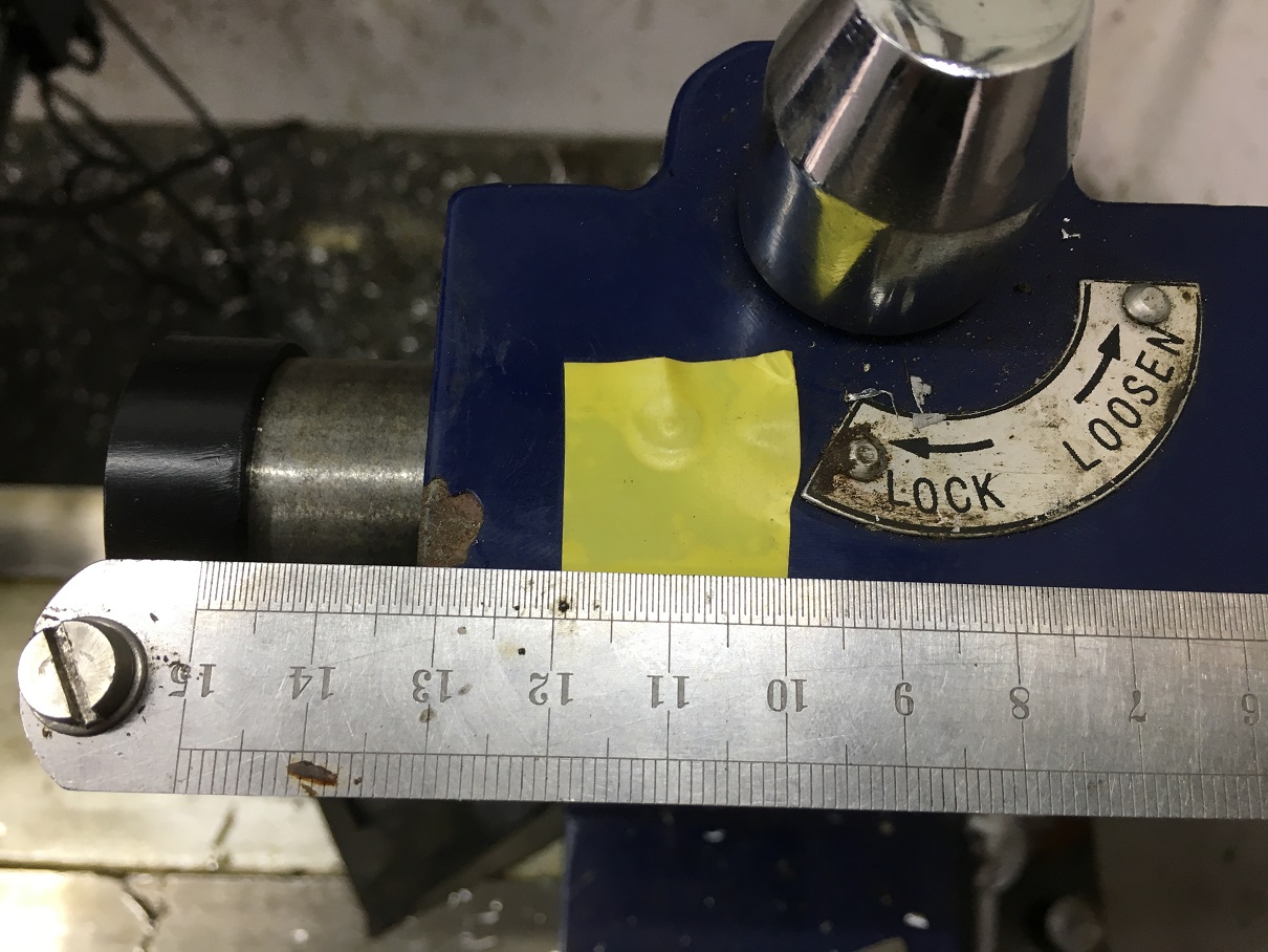

Attachment 30756
Setting to "0" is moving the piece of yellow tape.
Attachment 30757
Crude but a lot easier than counting turns. :lol:
