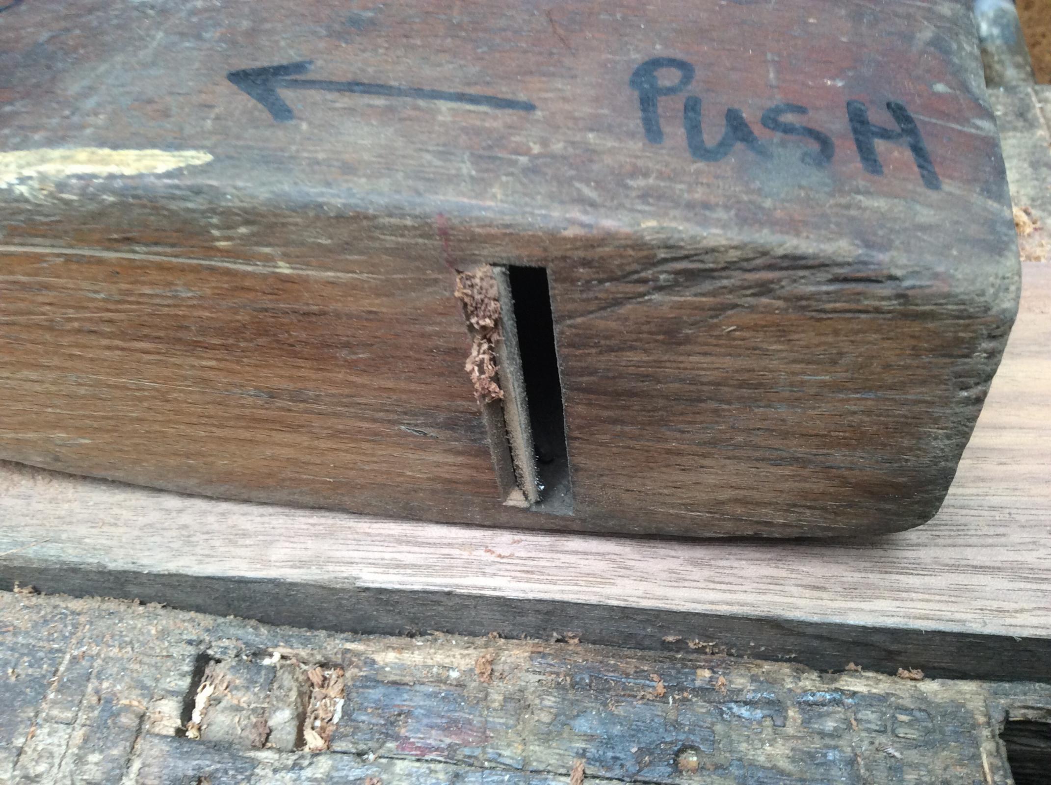

Attachment 31020

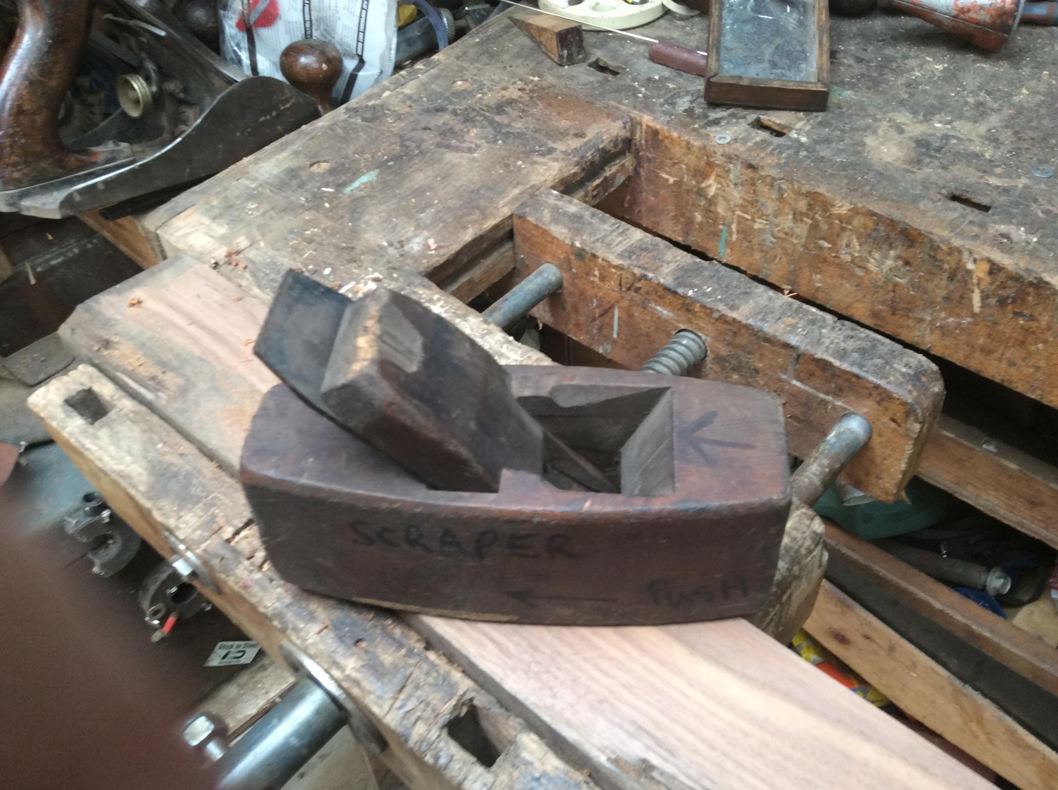

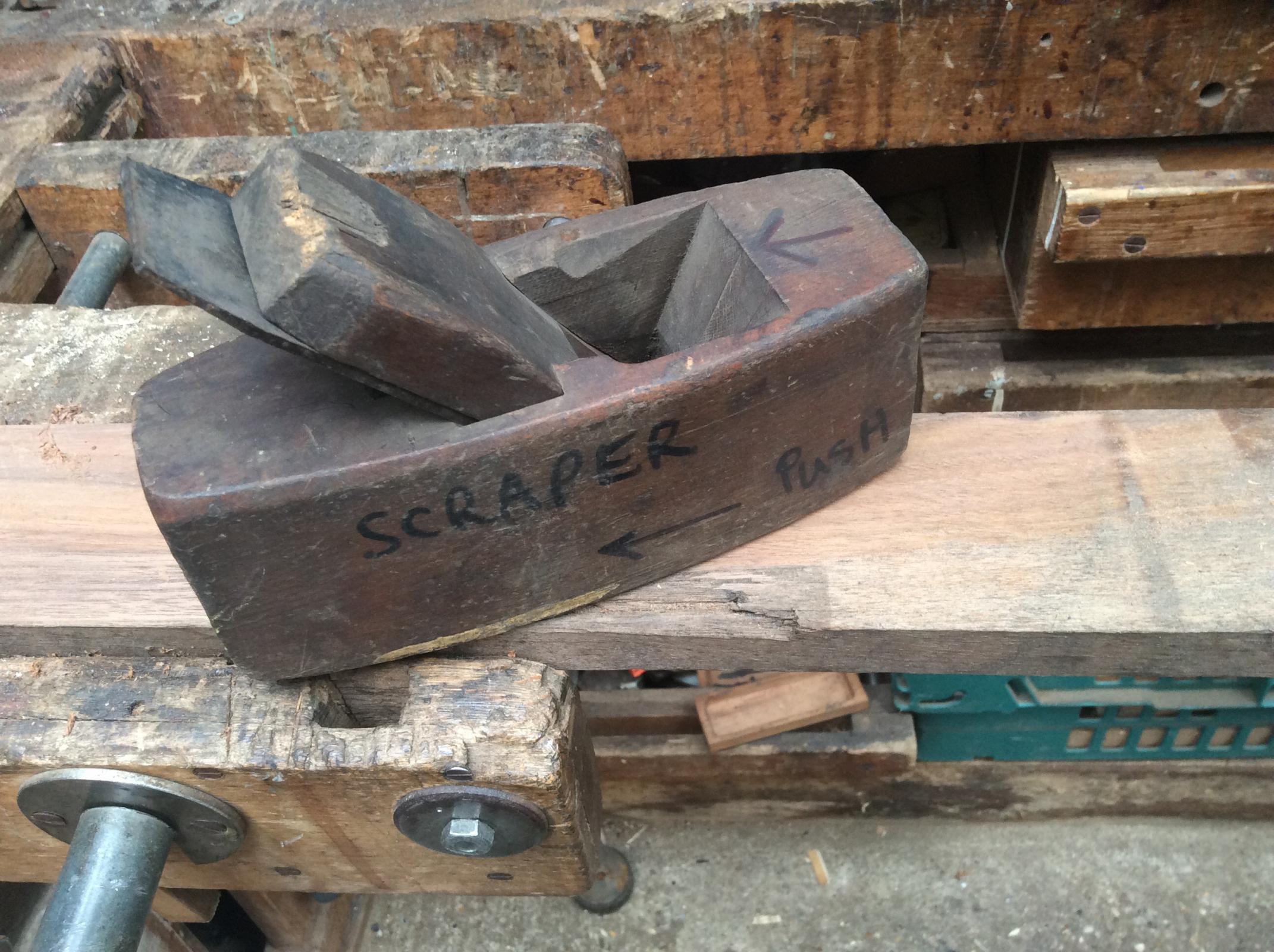

If you take the blade from an old coffin type smoothing plane, grind it square and hone as you would a cabinet scraper, then by using it back-to-front, you have an effective scraper plane, providing you pare a bit off the mouth so that there is an escapement for shavings.
Attachment 31021
Attachment 31022
