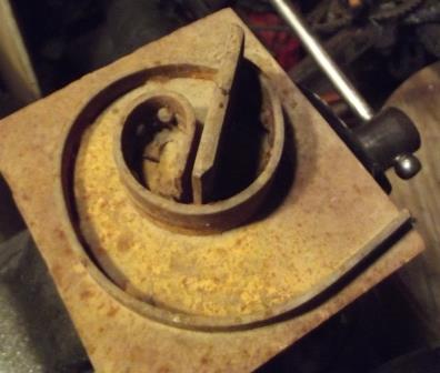

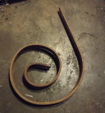

scrolling jig
While digging through some of my reclaimed re processed otherwise absolute usable junk I found 1 out of 30 of my old metal scroll jigs . they are so patently simple to make we often neglect to give them much consideration. But the fact is 1 jig such as this one can make dozens of slightly different scroll shapes
Attachment 9607 Attachment 9608
