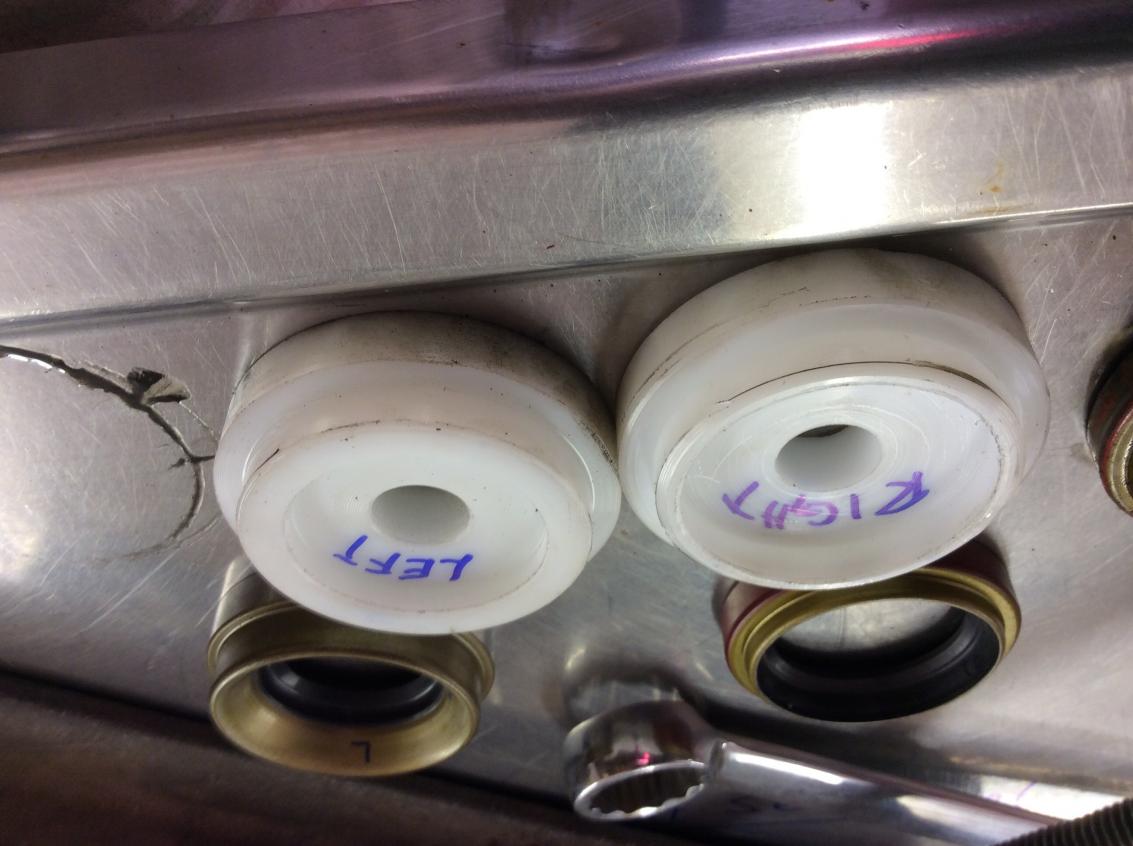

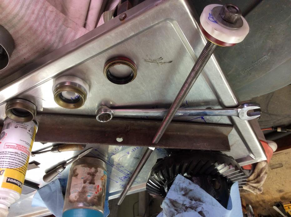

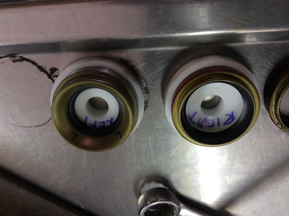

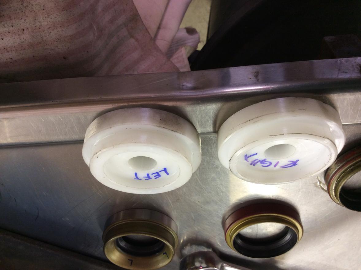

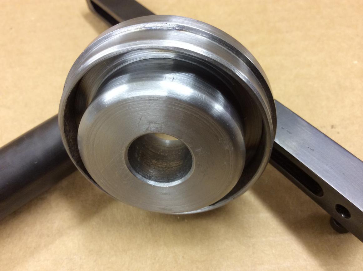

I used HDPE plastic, measured the new seal for dimensions. The seals must be pulled into place from the inside, you must completely disassemble the axle to change seals. I will post a drawing of the tools.Attachment 1732Attachment 1733Attachment 1734Attachment 1735
