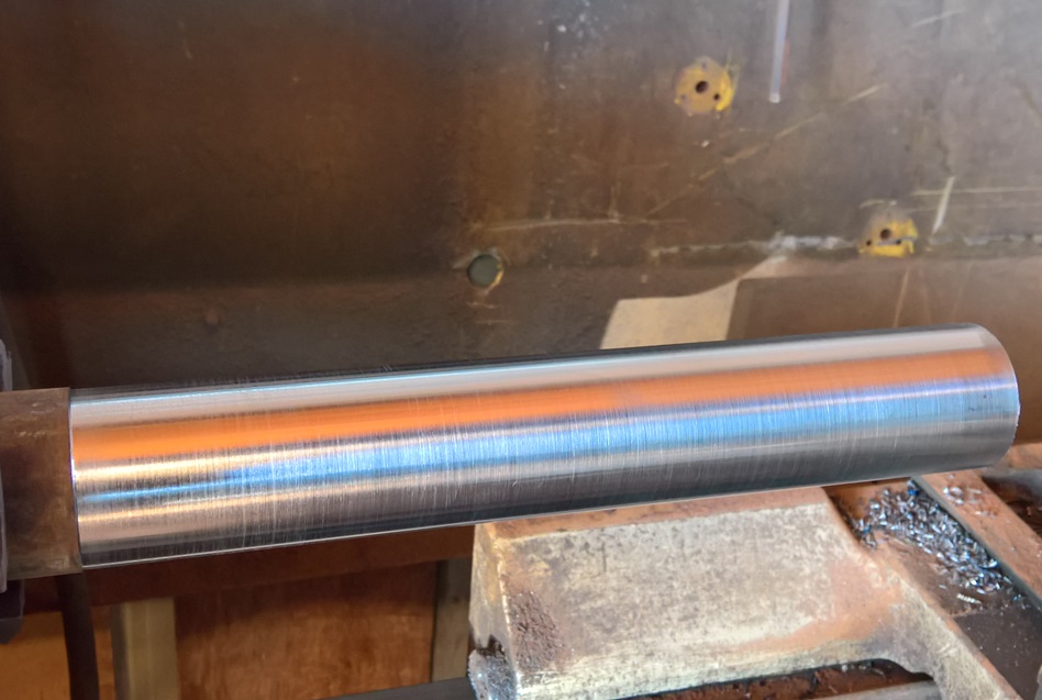

Here's what I did I turned and ground a piece of tubing to a .020" undersize OD of compared with the new plastic bushing this was to allow for the finished bore of the repair to give the proper crush on the bushing
Attachment 36516

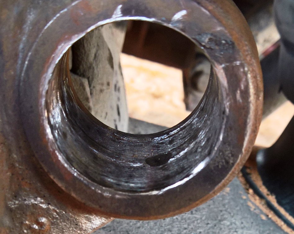

I then used a Dremel stone in a drill to grind the ID of the locations leaving it rough and in the shape of the wear.
Attachment 36517

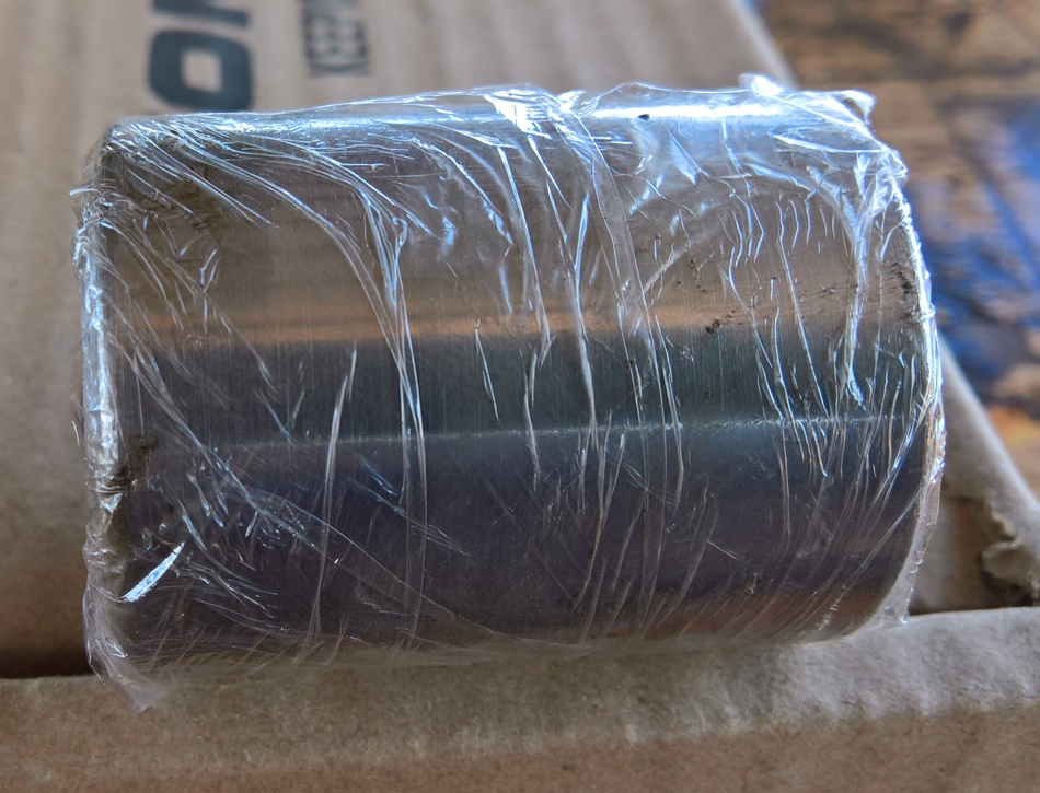

Then after making a full set of arbors or sizing mandrels I wrapped them in plastic kitchen wrap this was to insure the epoxy could not fuse with the mandrels don't worry about a few wrinkles in the plastic wrap it is so thin they wont matter very much anyway.
Attachment 36518

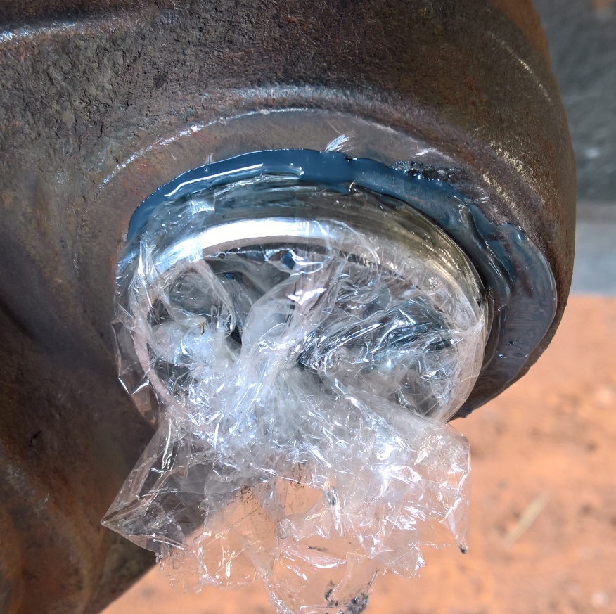

Next mix the epoxy fill the bore and inset the mandrel
Attachment 36519
leave the mandrel in until the epoxy is fully set but not completely cured, the Epoxy I used said set in 6 to 10 minutes hard in 6 hours machinable in 24 hours
I removed them after 20 minutes and was able to trim the excess with a sharp knife saving me a lot of grinding or sanding later
