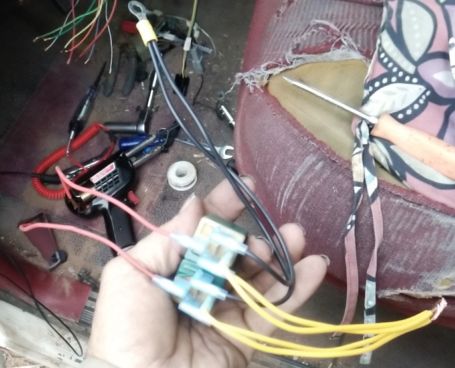

separating the brake lights from the turn signals 91 f250
This will work on other vehicles as well if you want to add separate brake lights to your vehicle, but the reason I had to do it was because the steering column I installed in my 91 F250 came out of a 93-ford ranger and did not have the wire to the turn signal switch for the brake lights it only had 6 wires and the 91 required 7 wires to be able to connect the stop light switch to it
What I did was I used a pair of relays since I did not have a single relay with double poles I wired the hot side of both coils and the hot side of the relays all together these 4 wires would connect to the stop light switch next I grounded the other coil terminals I then wired the #30 or the nortmally open terminals 1 to the left rear and one to the right rear
Attachment 44605
