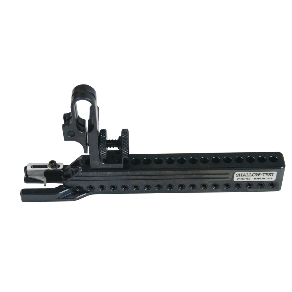

So I was cleaning out some folders on my work computer as I am moving to a new company and came across something that I was asked to reverse engineer for our inspection department. We have several plant locations and they wanted to make a bunch of these to have on hand. I would have created a solid model, but at the time, I did not have NX or Solidworks on my workstation at the time, so these are done in MasterCam drafting.
I know a some of you would probably have a use for these things and it would be a fun project.

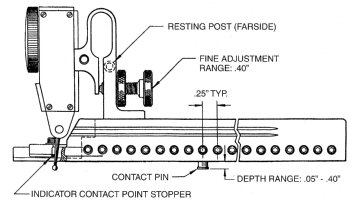

This is the gage that I copied, and below are the drawings to make said gage as well as dimensions for the dovetail used on test indicators.
Well for some reason I am having trouble attaching jpg files as inline images, so I the pdf files are below.
Attachment 43369
Attachment 43370
Liking the idea of a rail based device.
I often use 'Indi-Cal' which is a great little tool, provided you've a ring gauge or sample target part. A little tedious with micrometer, I usually start with a vernier/ digital caliper, being a member of the 4:1 (tolerance:resolution) crowd.
The rail makes repositioning less iffy.
