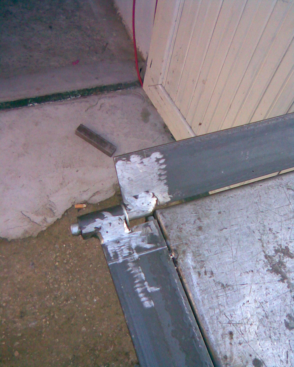

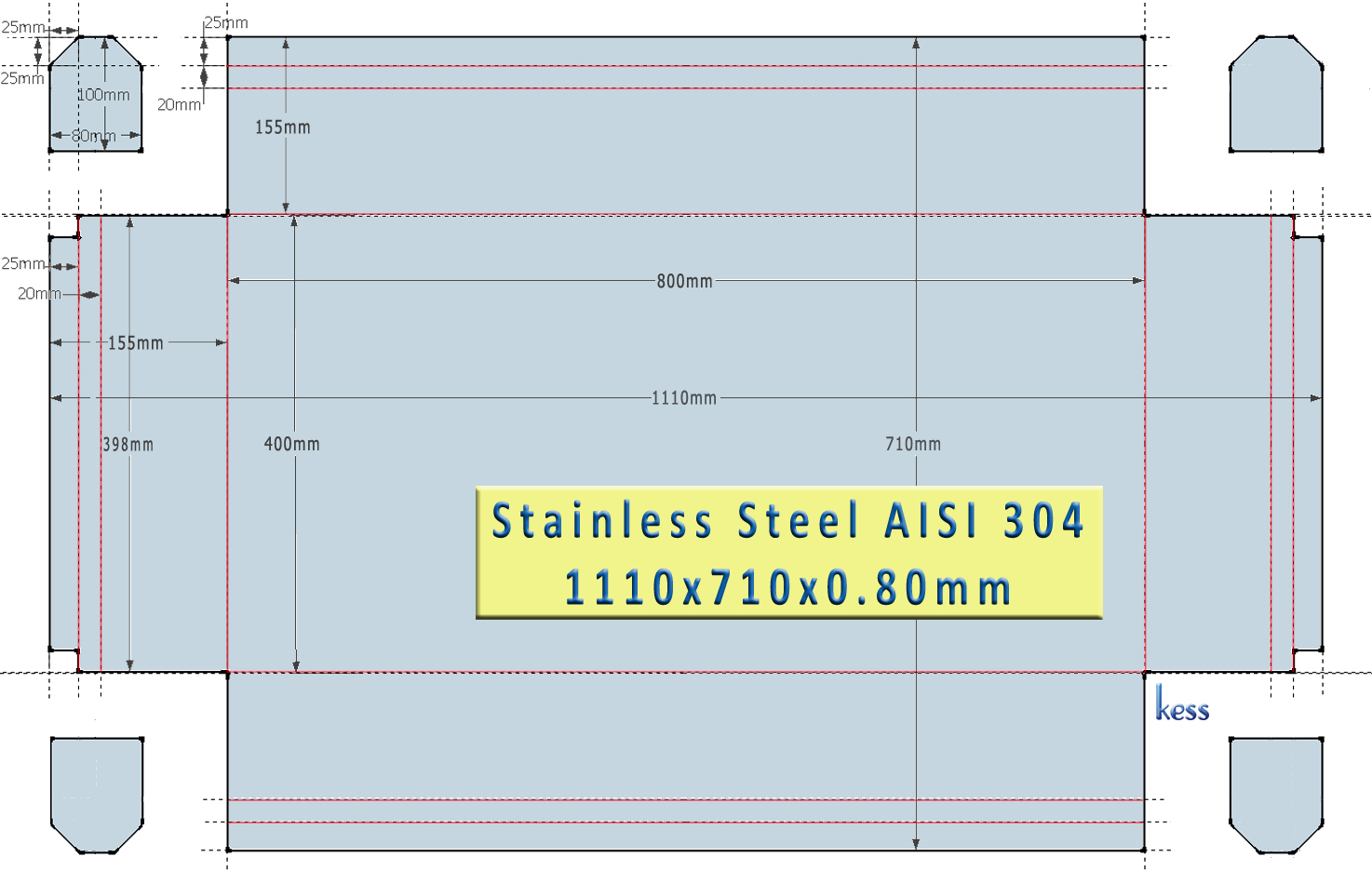

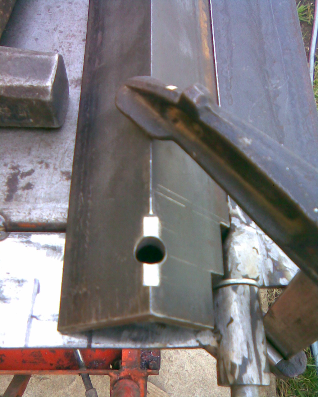

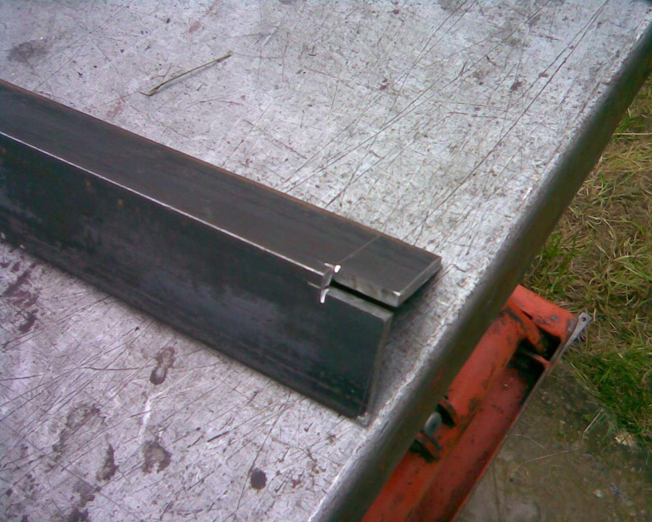

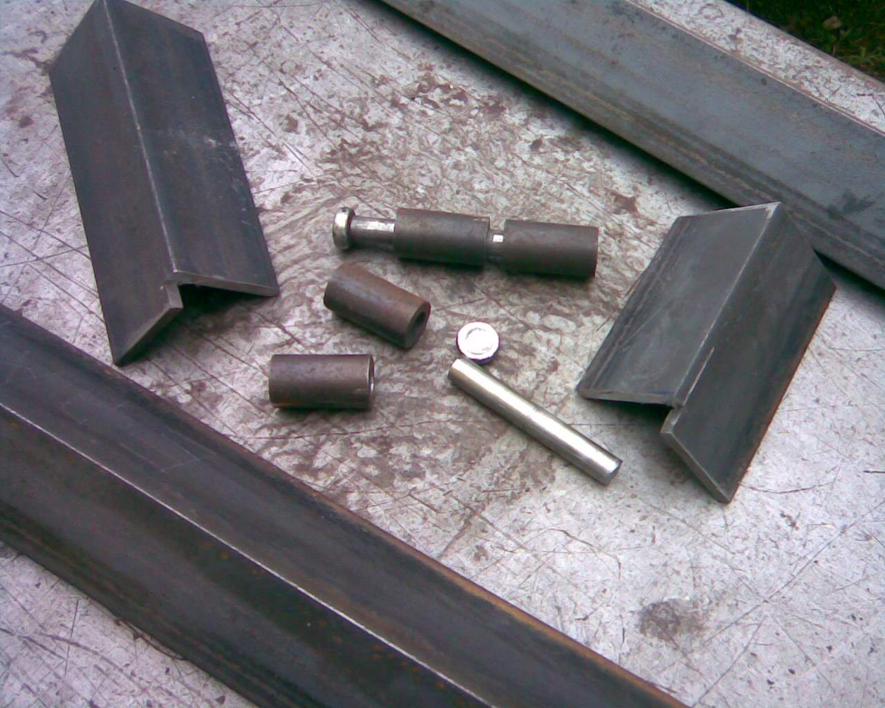

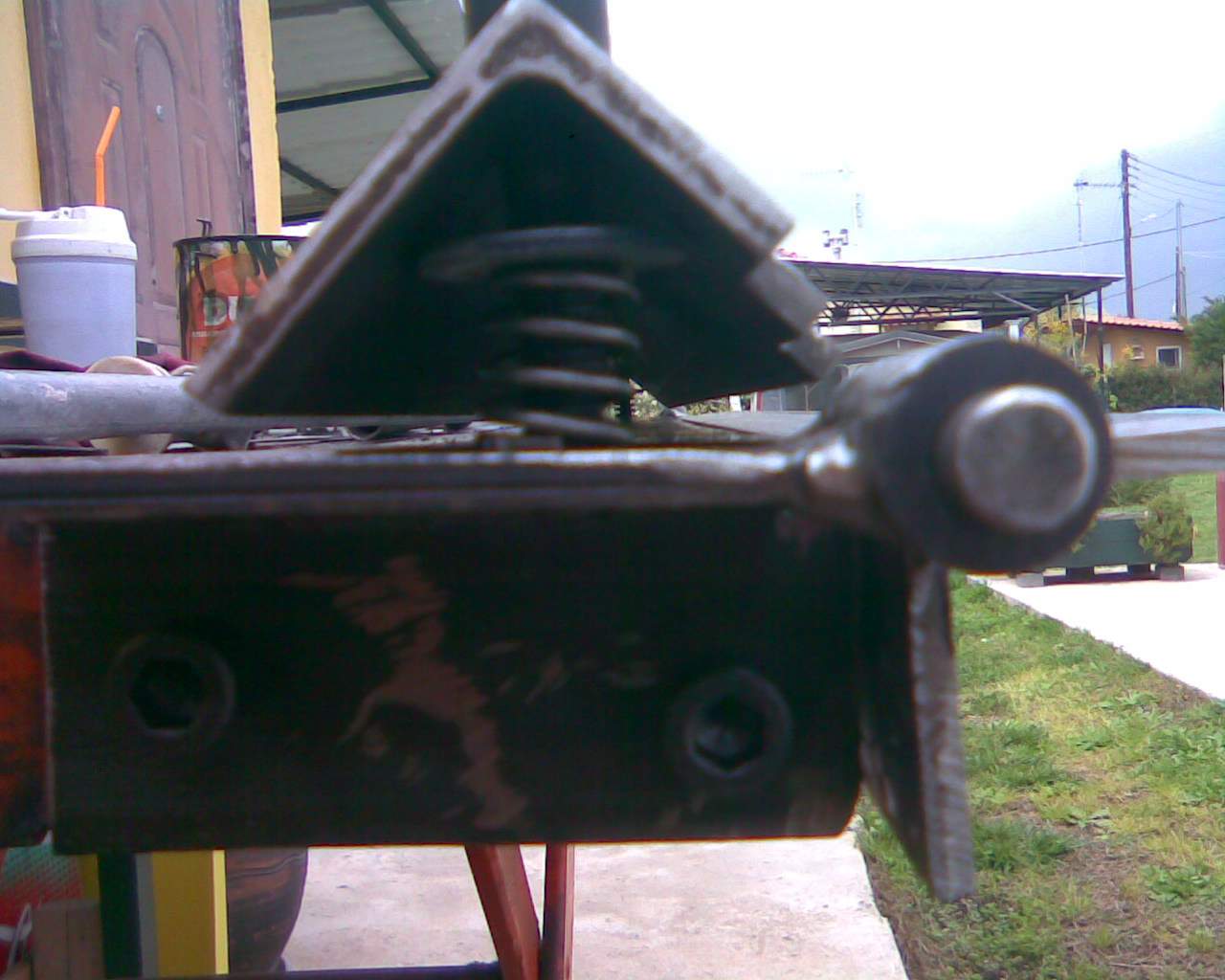

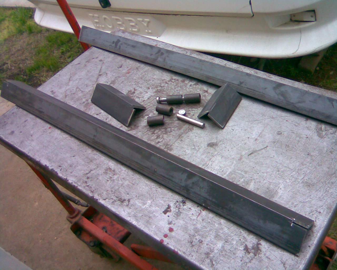

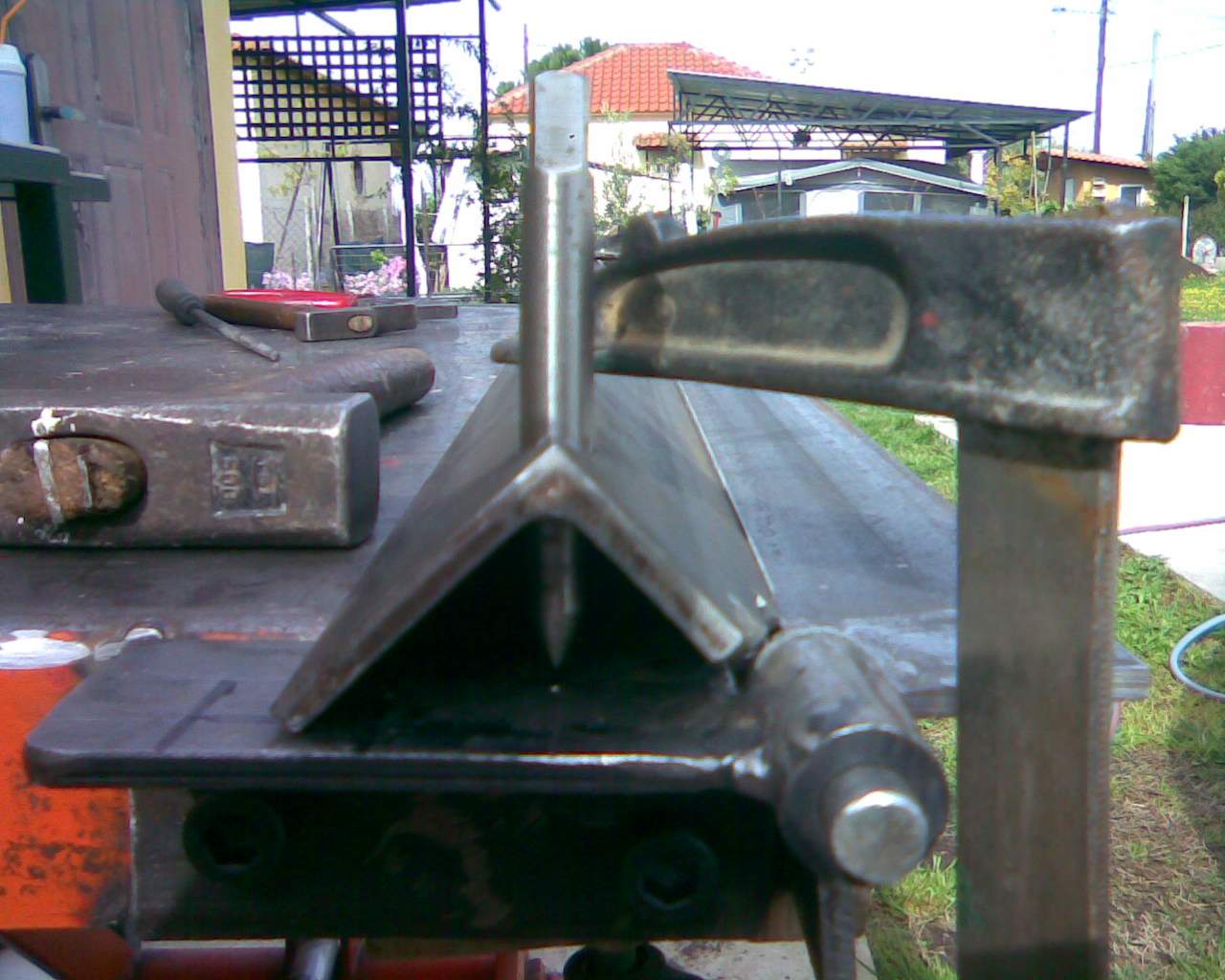

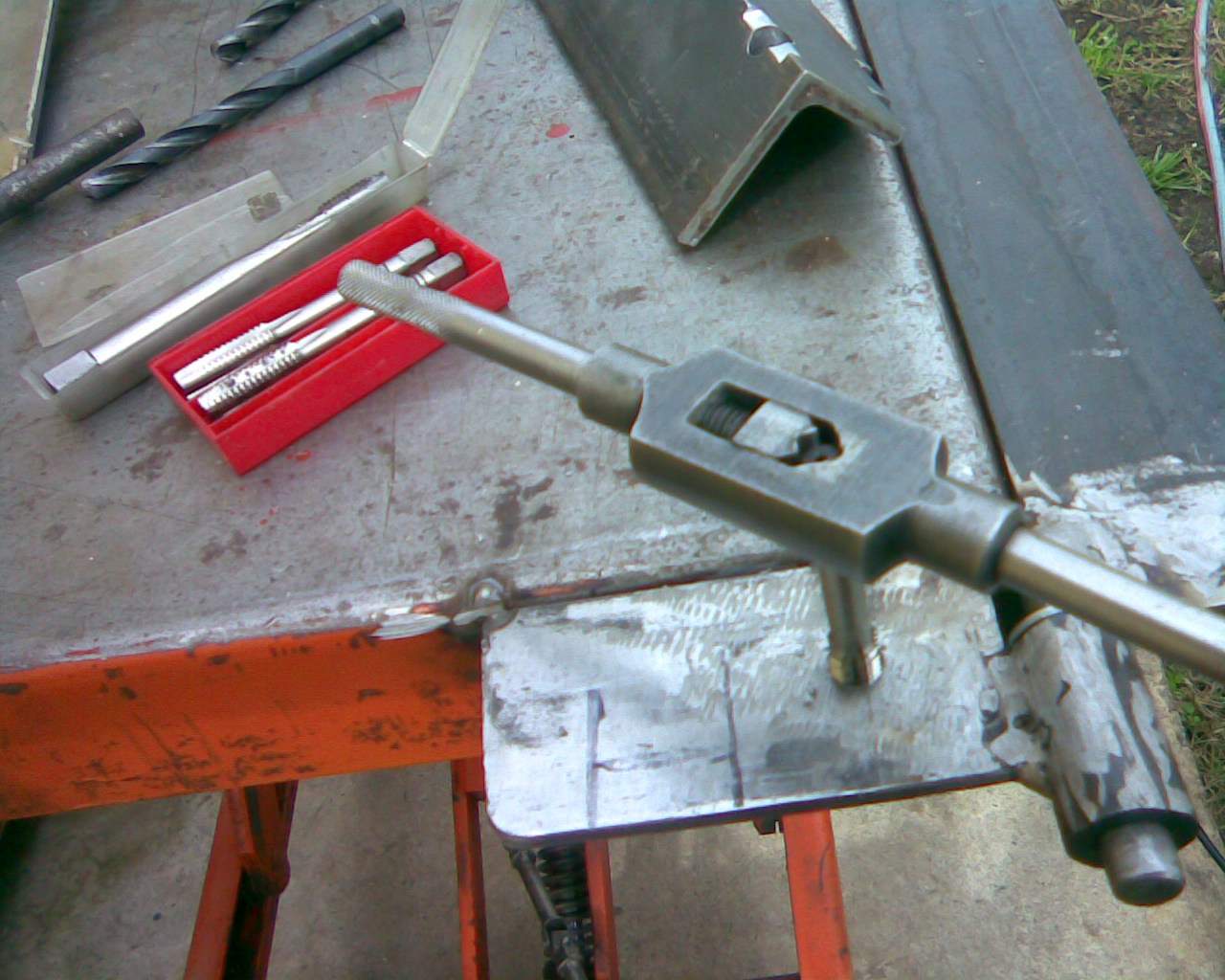

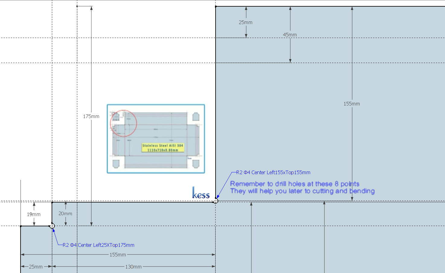

    Homemade sheet metal bender brake 805 mm length.
    Step by step guide, materials, dimensions.
    First use and testing with stainless steel sheet (AISI 304)
    0.80mm thickness for the making of a BBQ 800x400mm.
    This is the first part of a series of three videos.

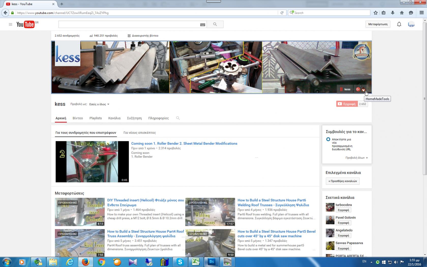

    Hi Ken,
    I've added a link at my YouTube channel first page to forword my visitors to my HMT.net page.
    I think that is a good method to drive in people with the same interests at the right place.
    Also I've added the HMT.net logo at the same place (up/right corner).
    If this is a problem for HTM.net, notify me and I'll remove it, immediately.
    (see attached print screen)
    Regards
    Bill
