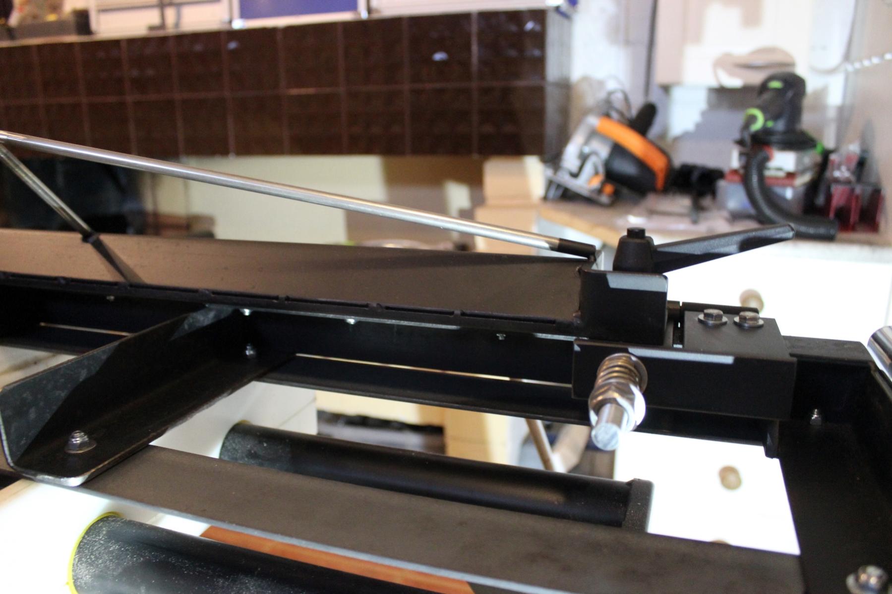

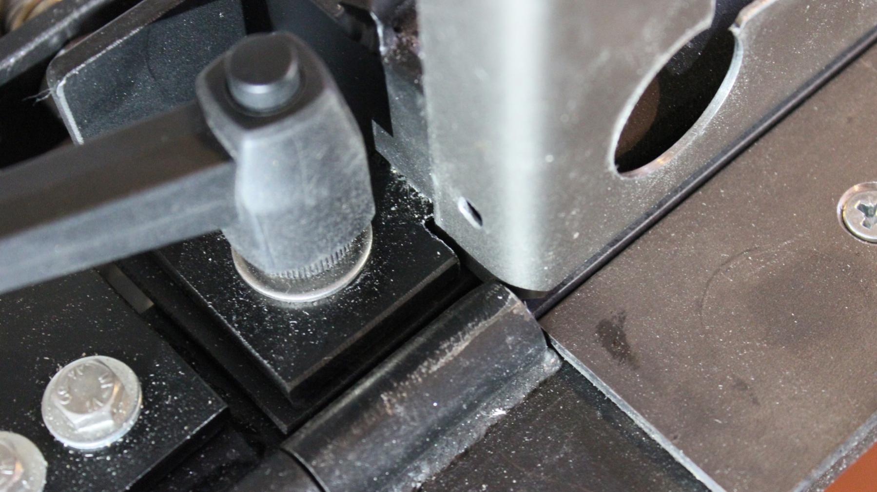

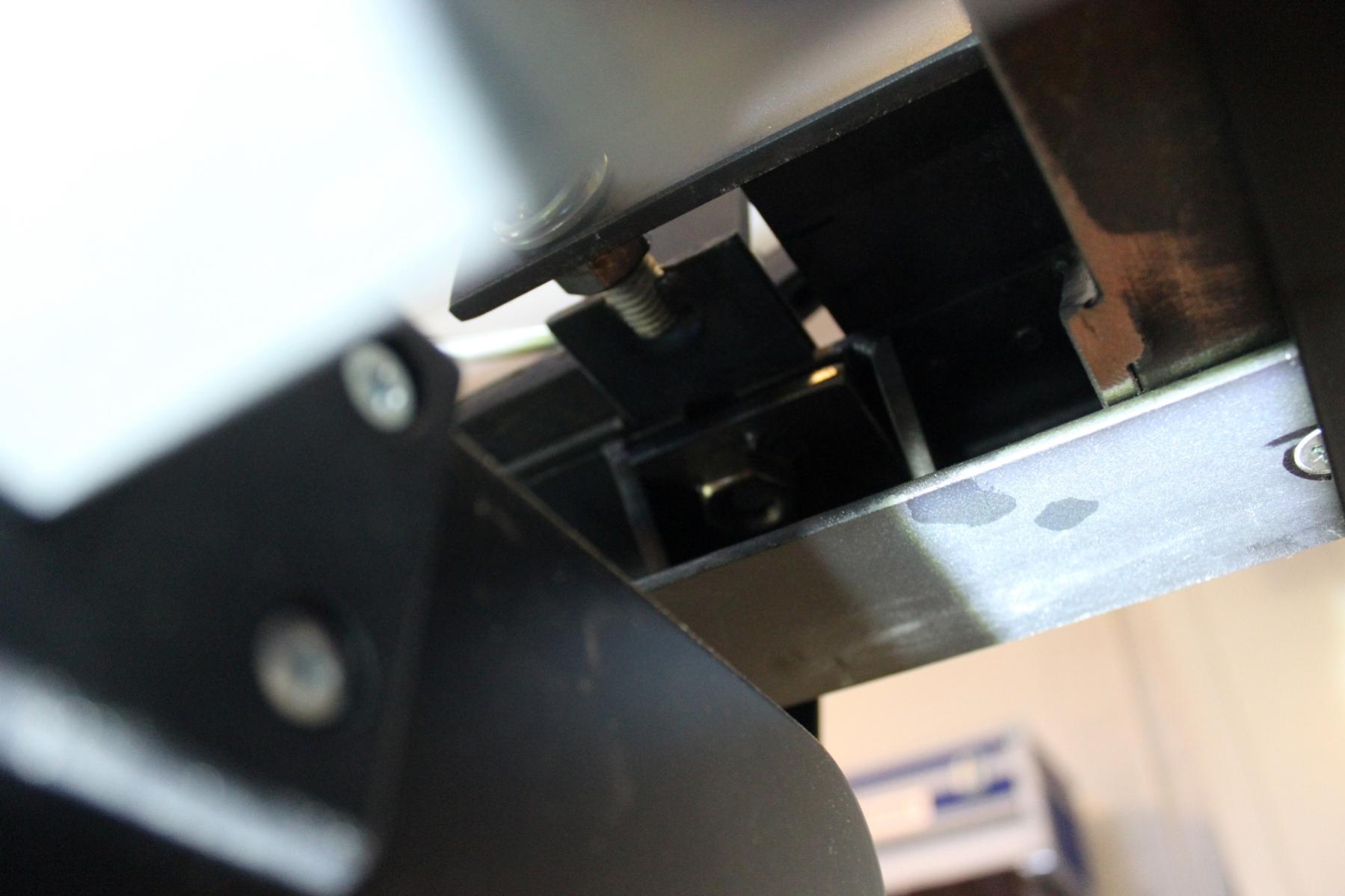

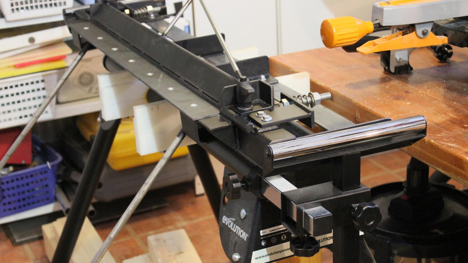

This is my bending brake.
I made it from 4mm thick 40 x 40mm L-profile
6 and 12mm steel bars.
And 3, 4 and 6 mm thick flat bars.
This short video shows my space saving idea in it:
https://www.youtube.com/watch?v=kapZ...ature=youtu.be

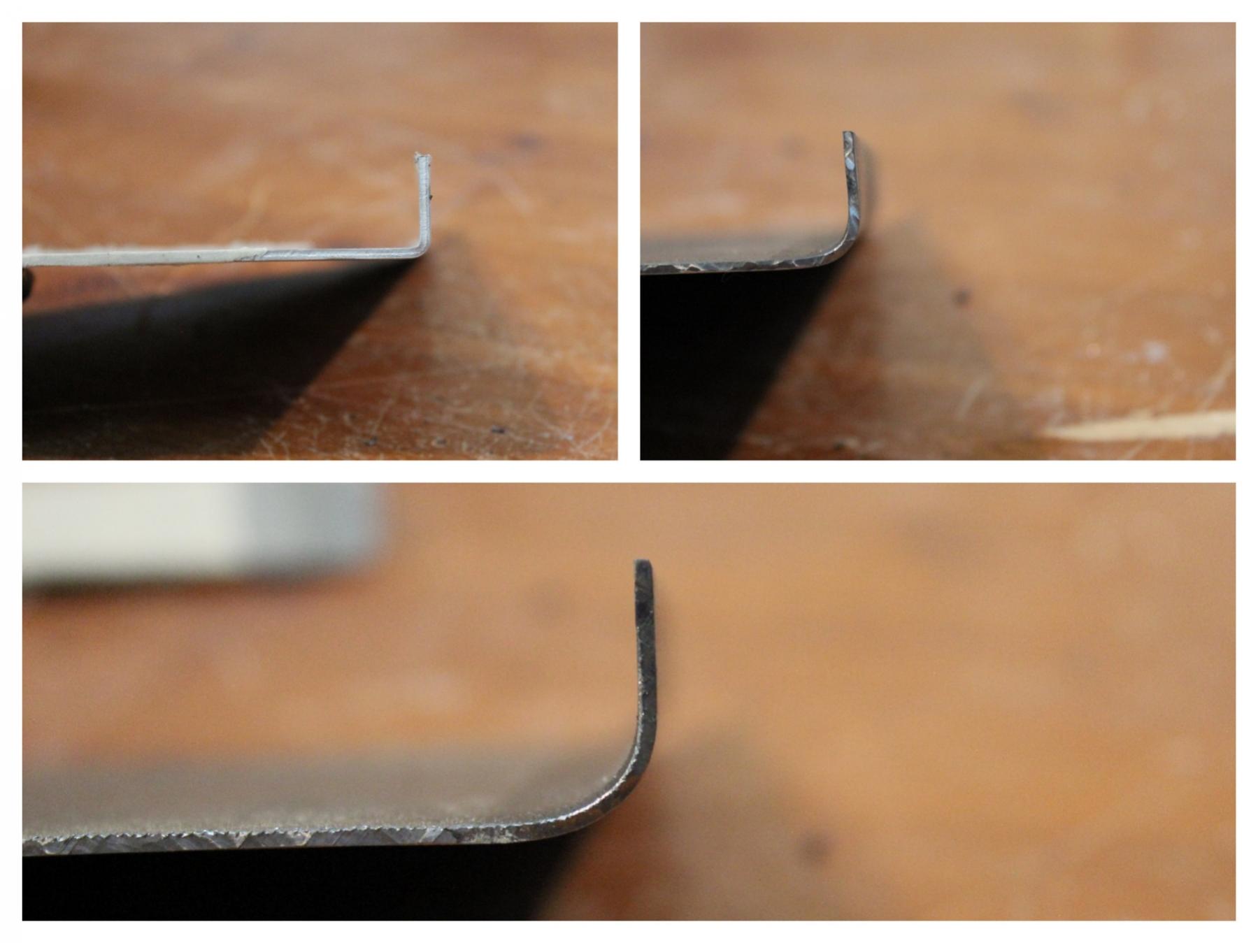

I wanted to get brake that could bend 2-3mm thick steel. Also i wanted to be able to do some bends with bigger radius, without noticeable marks. That's why i made bending radius adjustable.
This video shows the actual making the frame:
https://youtu.be/KBcsWos_ONg
You can see the main idea of the structure and the radius adjustment from these pictures.
Attachment 16737Attachment 16738Attachment 16739

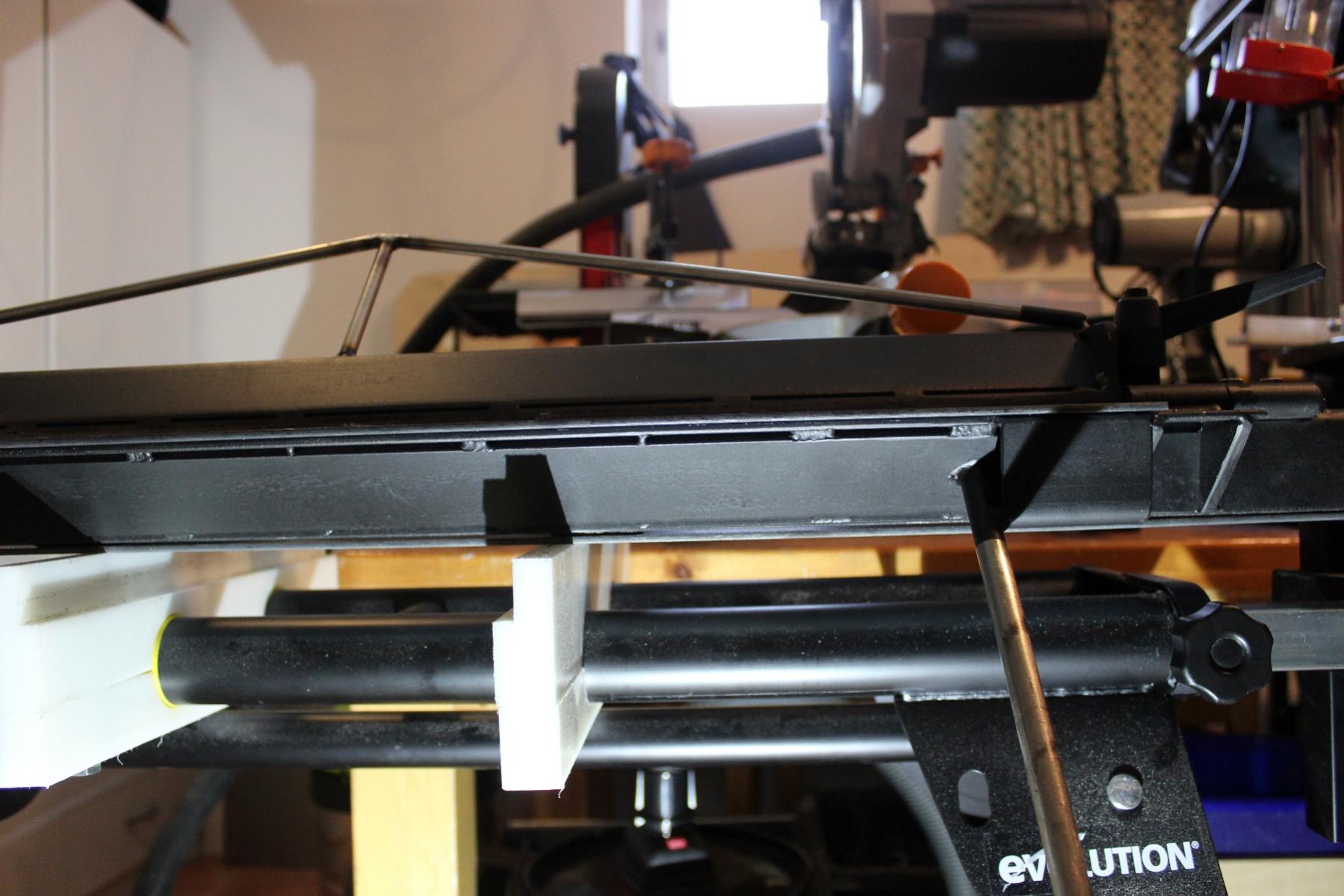

I bought hinges, screws and nuts from my local hw-store. Those costed 5 euros.
All other material is from the recycling center and costed 30 euros.
Used tig for welding, but it could be done with mma, mig/mag too, of course.

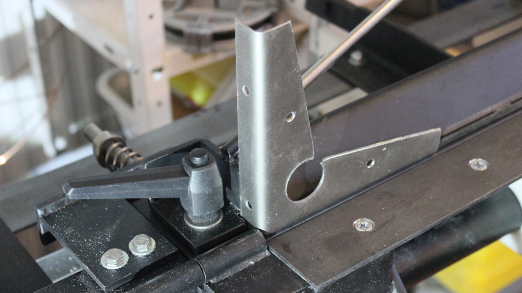

Closer look for the "corners" little groove allows to make brackets and stuff like that.
Attachment 16905
Attachment 16906
I like to use tig, it doesn't make splatters. Build was very simple process, all parts are cut straight.
I used chop saw and angle grinder for cutting. But that's optional.
Drill press and hand drill.
M6 threading tap. M12 threaded rod. M6 nuts and bolts.
2 pieces of tight springs. Washers.
This video shows the radius adjustment:
https://www.youtube.com/watch?v=ZLtHTLvzuSw
