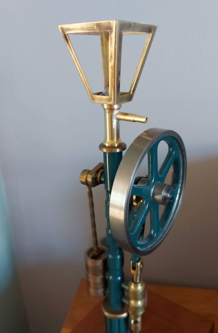

I've been making a lantern folded out of brass sheet and wanted an accurate edge to file to.
Attachment 35451

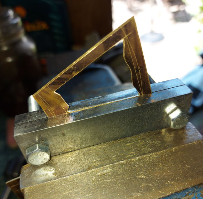

Just 2 pieces of 1/4" mild steel, edges case hardened and 2 6mm bolts.
This allows me to align the edge against the marked line and then to file to it.
Attachment 35452
Work in progress for the lantern on the lamp post engine...
