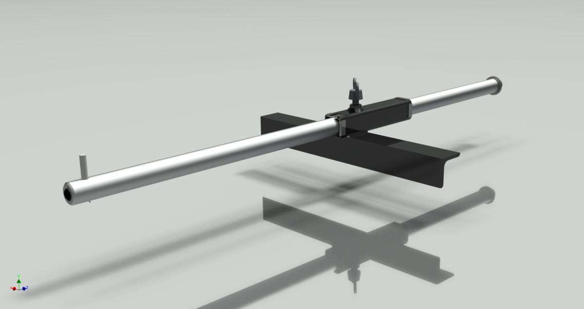

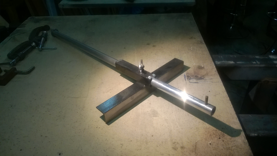

Sheet metal marking gauge, my personal design and constructed and regularly used :) May not be as nice as my previous design posted but does the job very effectively:).
This is a welded construction of EA and 20x20 SHS with aluminum 2011 Round the scribe is a reground drill bit plus the fasteners.
