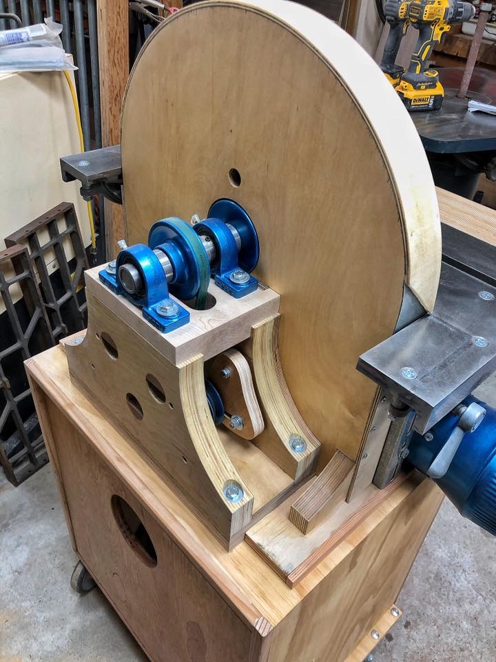

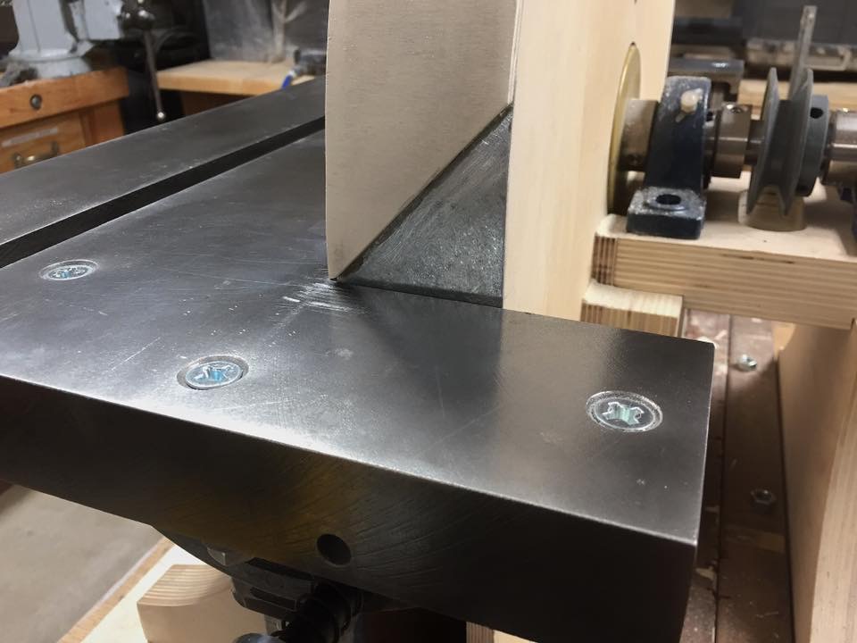

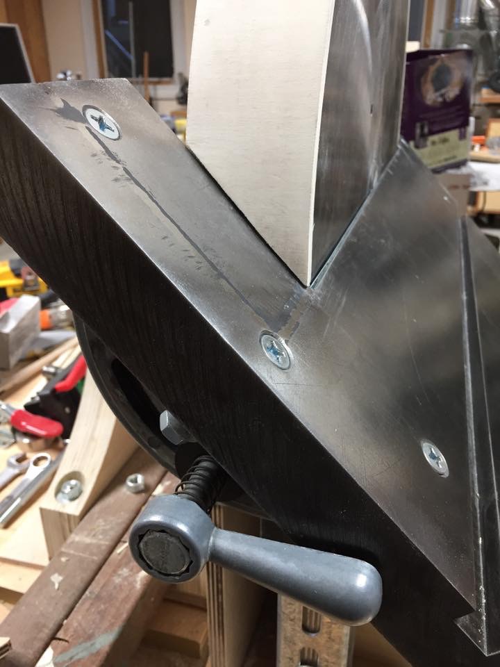

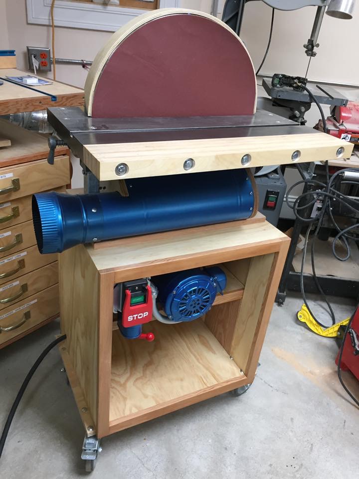

I built this from a Craftsman table saw by using its cast iron top and trunnions. The top was modified and patched. The disc and hub are replacement parts from a replacement parts supplier. Pulleys and blocks are internet sourced. The blue tube is the exhaust manifold and is connected to a 6” line from my DC. There’s a direction switch below the power switch.Attachment 30015Attachment 30016Attachment 30018Attachment 30017
