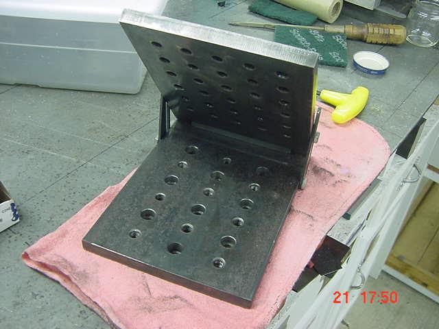

I then cleaned up the angle plate parts and dunked those.
http://images12.fotki.com/v254/photo...MVC004S-vi.jpg
The top plate. NOW... you can see around the tapped holes where the stain didn't take... That's on me. When Caswell says the "parts should be clean. Oil and grease free. I think they mean "squeaky"... I cleaned the parts after sanding off the mill scale BUT I didn't clean out all of the threaded holes... What you see is tapping fluid contamination keeping the oxide from working correctly.
