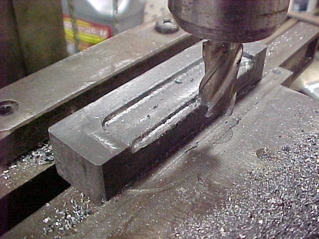

I have gotten started on the build. The punch die is milled out and has holes laid out for drilling and tapping as well as the lower support plate that carries the punch die and shear plate.
The punch die.

Continued in next post.

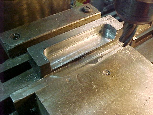

All milled out and ready for screw holes.

I have a few pieces cut out but that is where I am at with this project.
