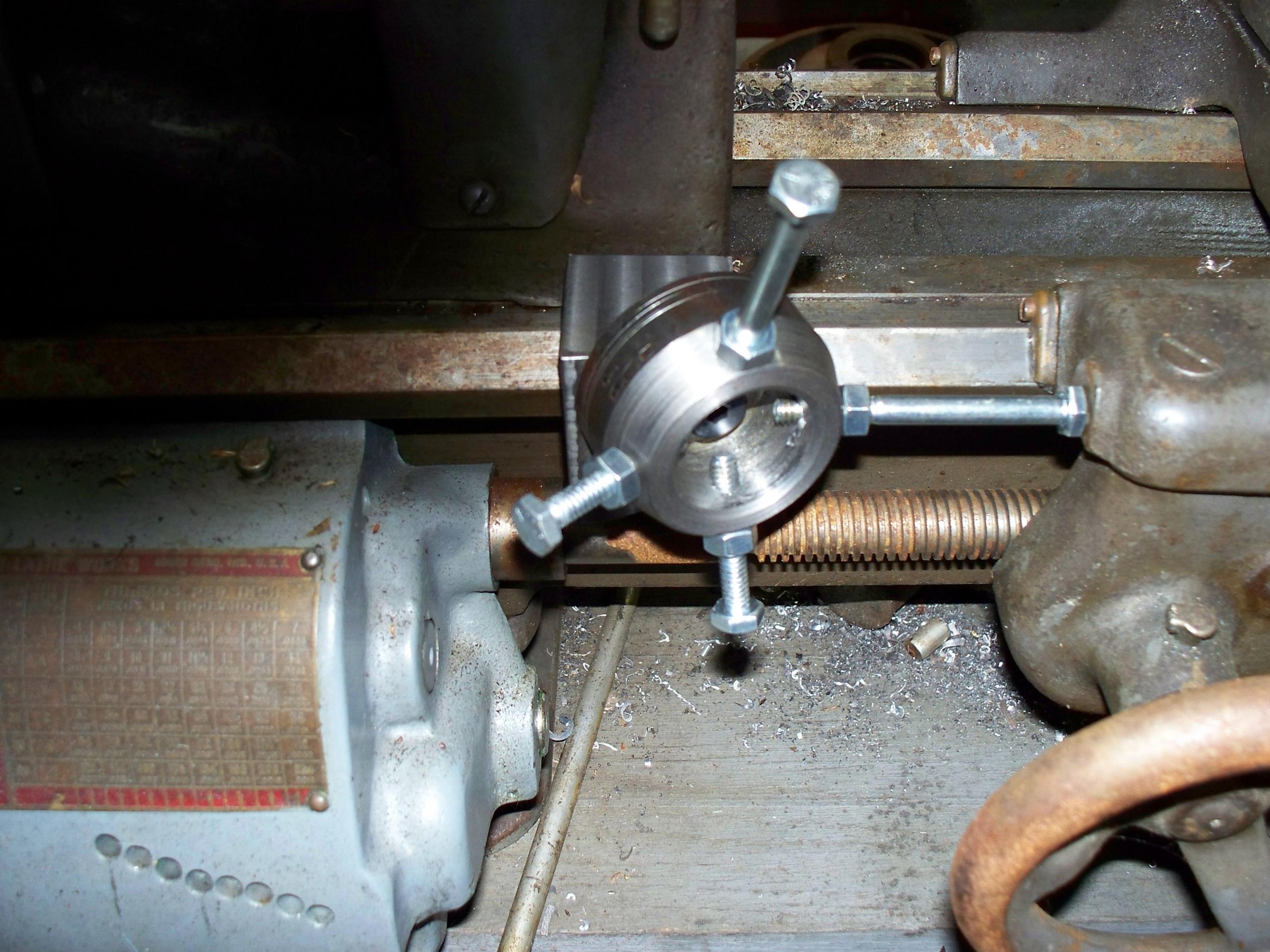

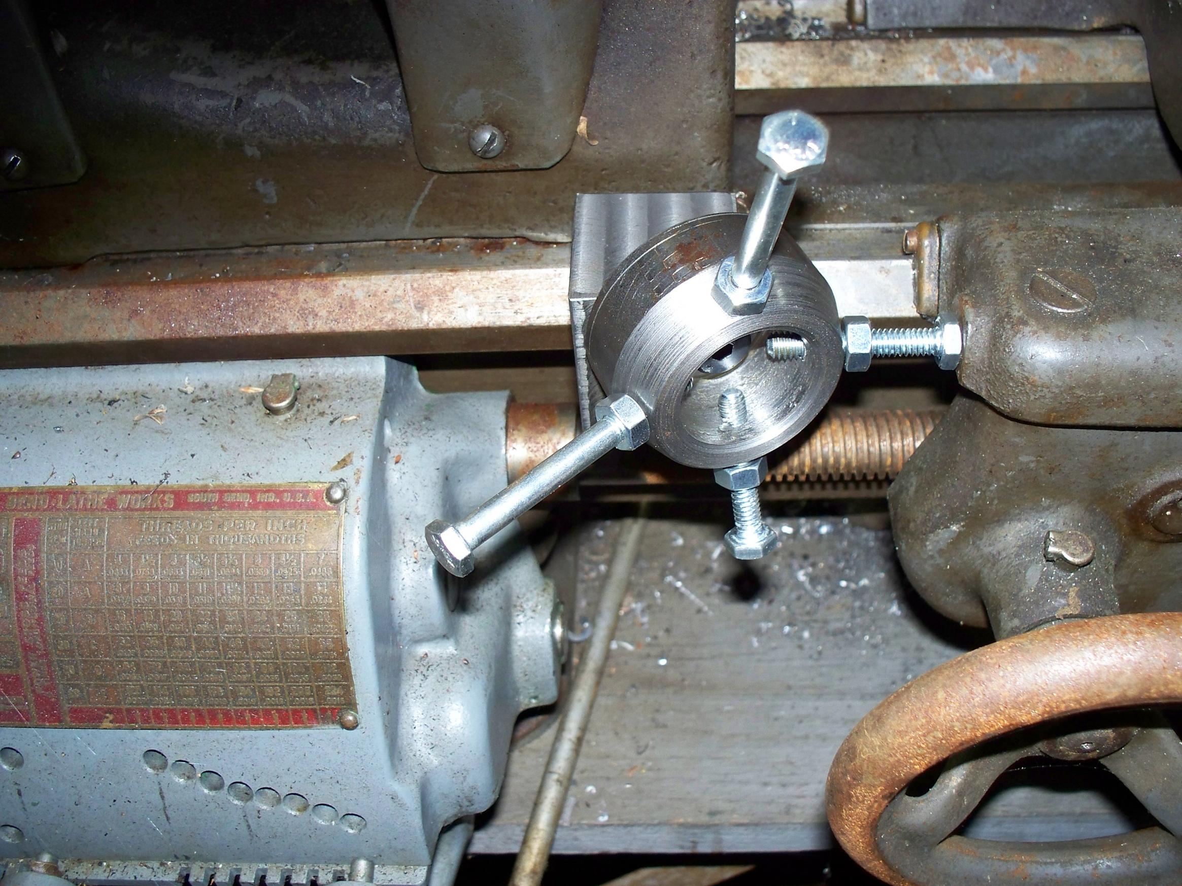

    Shop made 4 way carriage stop for South Bend 9 lathe.
    Here's a new way to make a 4 way stop for your South Bend 9 lathe. Instead of being inline, I made it to offset at a 45 degree angle. I'm using simple 1/4 20 screws as stops. Each stop has a ball and spring detent locator. It sure makes turning small parts a lot faster. Might be a good week end project.Shop made 4 way carriage stop for South Bend 9 lathe.-south-bend-4-way-stop-001.jpgShop made 4 way carriage stop for South Bend 9 lathe.-south-bend-4-way-stop-002.jpg

    Very good idea. Thanks for posting.
