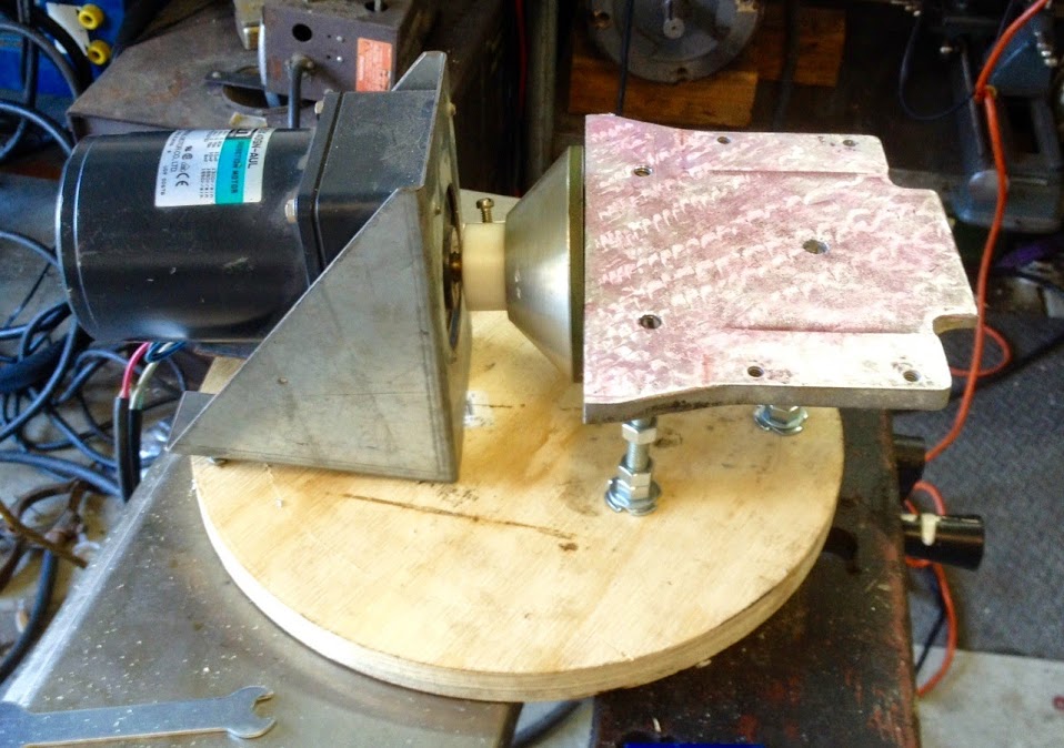

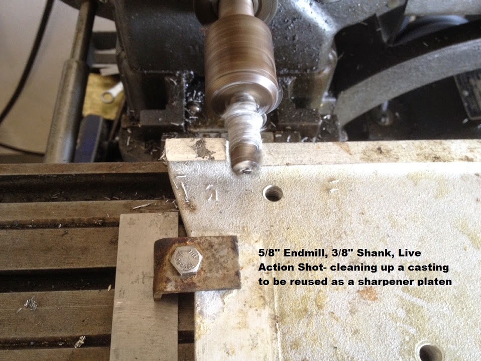

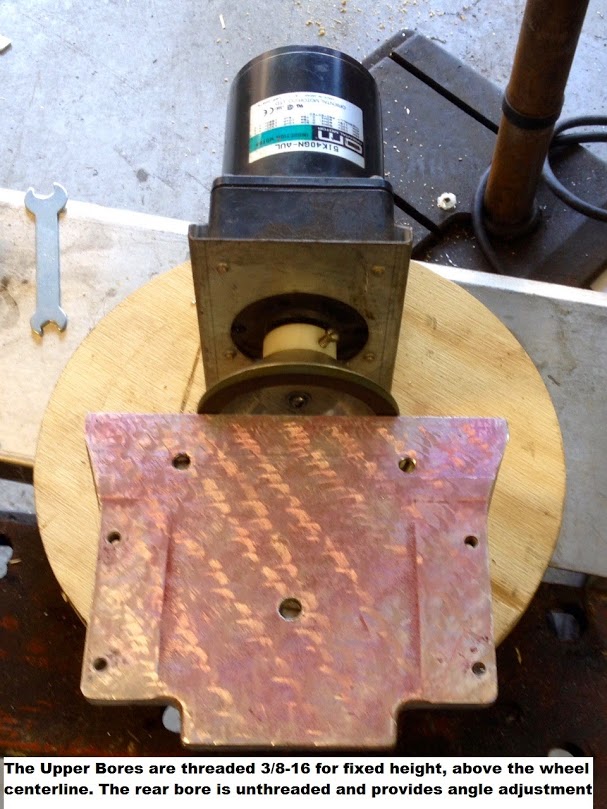

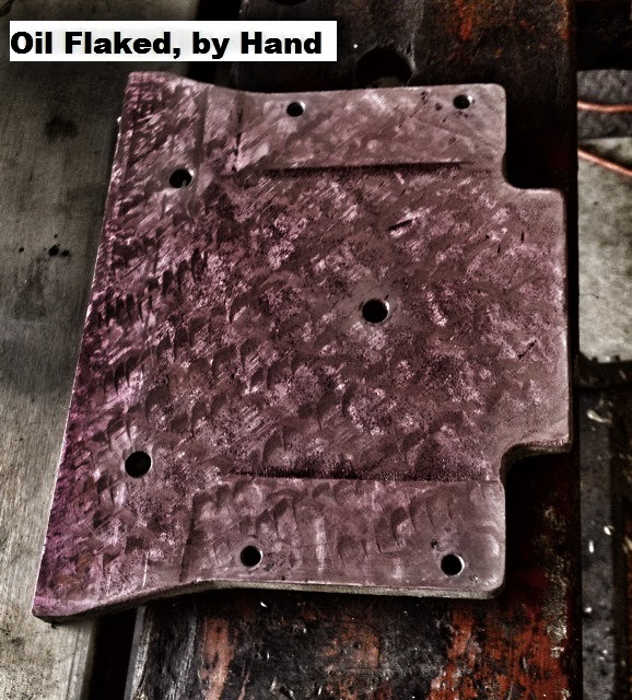

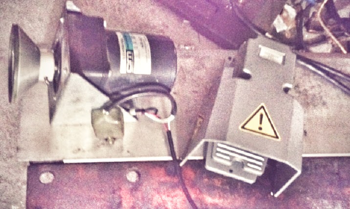

i made a diamond tool sharpener for sharpening carbide metal scraper blades and biax carbide blades.
Attachment 4014
Attachment 4017
Attachment 4018
Attachment 4015
Attachment 4016
it turns at approximately 280 rpm.
the wheel is 75% concentration diamond 600 grit, 3" diameter.
i use a few shots of windex to cool the carbide during sharpening operations.
the platen is flat and level, the motor is tilted 3* and is adjustable.
thanks for reading
