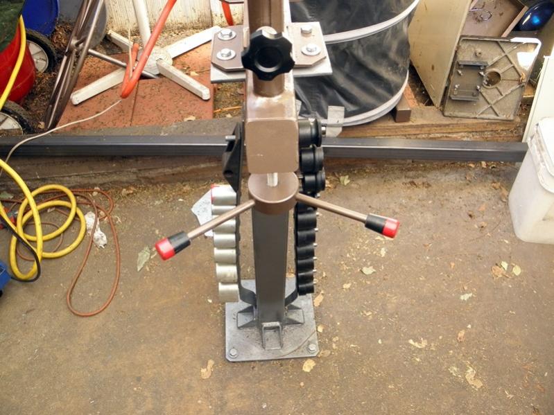

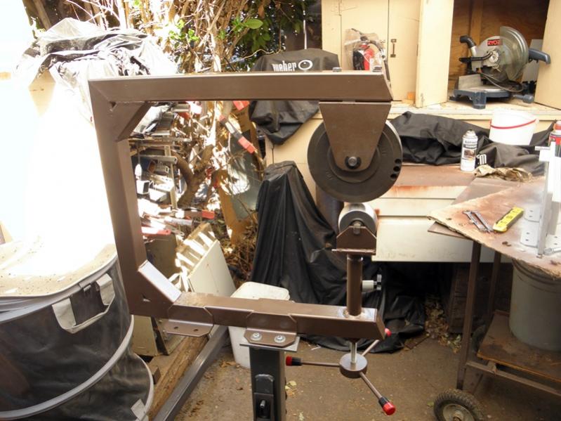

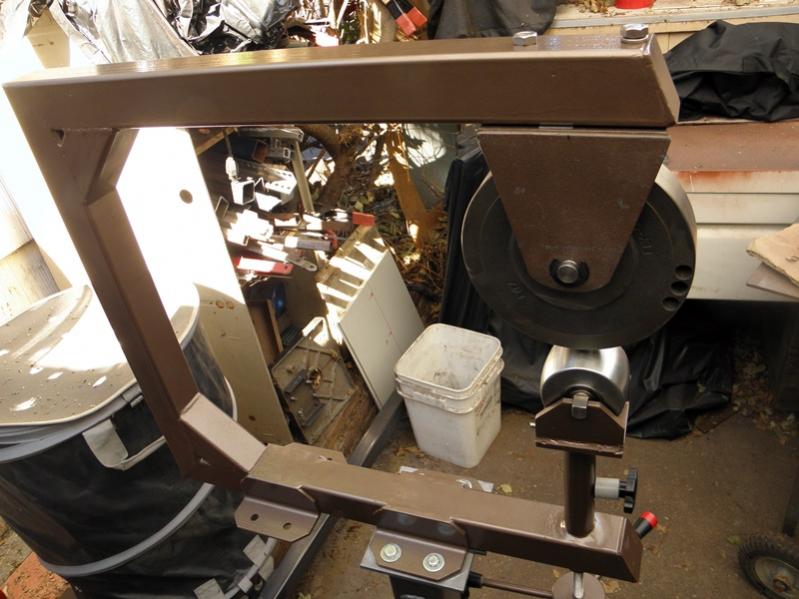

Shop Made English Wheel. I re-purposed an tread mill motor flywheel for the upper wheel and purchased the bottom anvils from HF. Constructed from 2x2 x1/8 inch square tubing ect.
