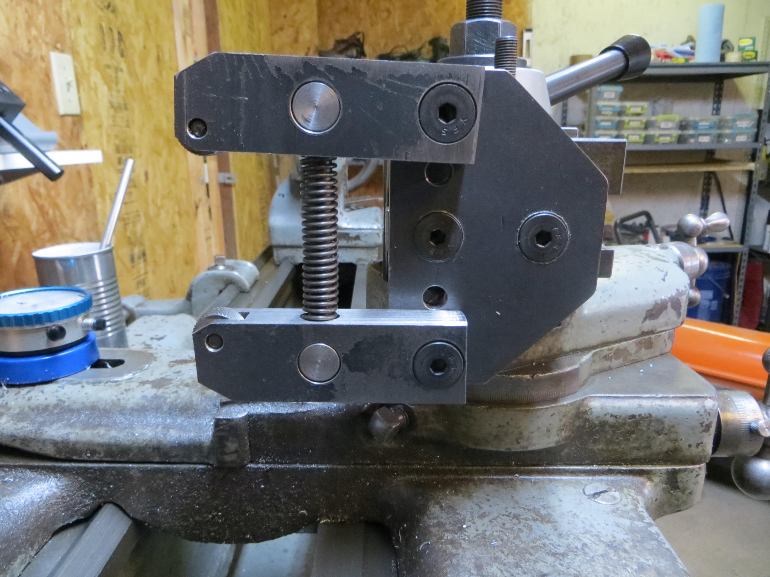

Shop made large diameter knurling tool

I like your use of the flat head socket screws and looks like the knurling tool can handle some large stock. What did you use to hold the knurl wheels in place? I have an import scissor-type knurling tool and it is a real pain swapping out the knurl wheels. Thanks, Paul
For the pins that hold the knurls, I just drilled undersized holes to use a press fit...pressed the pins in...
Nice blog :hattip:
Nice build and Beafy, Leversole! Enjoyed your write up on the site too. For the arm pivots did you use FH shoulder screws or let them run on the threads? The FH's seems like a good idea to help keep them centered as well as extra bearing surface, but there is a lot of pressure on those in both axis, especially if making a long run. Your knurls sure came out Real Nice! :hattip: Thanks for sharing! ~PJ
Very nice tool! Nothing fancy in its execution but the end product looks great.
Nice blog and writeup! Lovely knurls on that 2" stock. Thanks for sharing your other tools!
