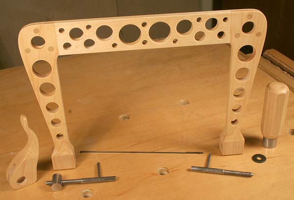

I needed a coping saw a while back and figured since I don't have a need for one very often I purchased a cheap one I found on ebay. I thought it was a good deal as it also came with 4 assorted blades. Well, it lasted for four uses before the pot metal blade mounting hardware snapped off. At that point I figured I'd try my hand at making one. Here is what I came up with:
Here's what it looks like unassembled...

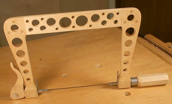

and put together ready for use:

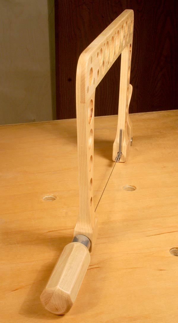

I kept the saw as strong but light as possible. It comes in just under 8oz. ...
Attachment 4008
Anyway, the saw works nicely and am happy with how it turned out.
