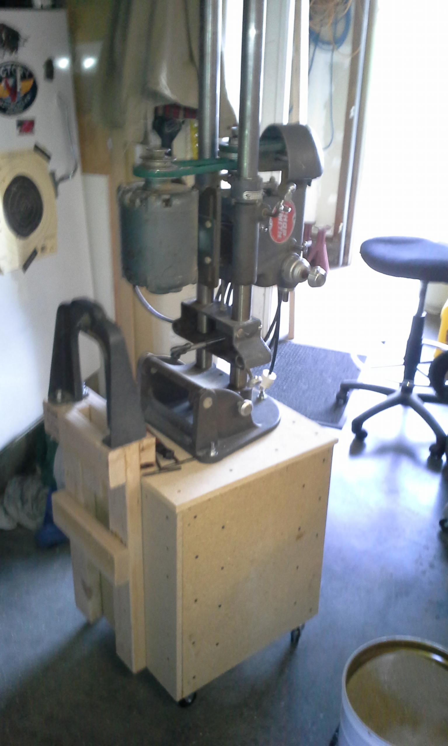

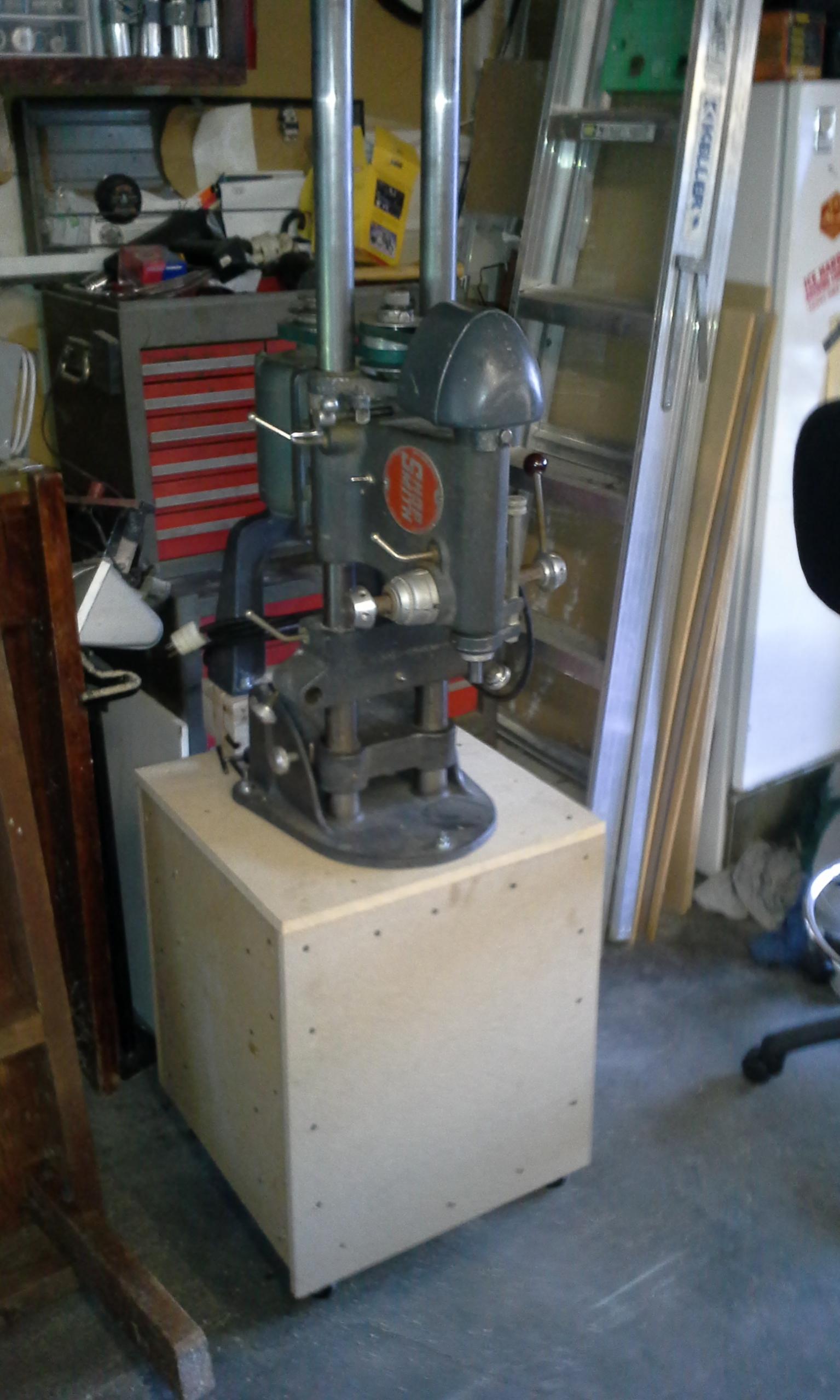

About a year or so ago, I purchased an old Shopsmith 10ER, from a guy that had inherited it from his father; but no longer had interest in using it. In keeping with my need for tools that would fit limited space, but with maximal use, I decided to buy it (that and anytime my wife makes me aware of a power tool for sale, I jump on it!:rolleyes:). Soon after my new toy was safely home, I realized that it still took up too much room; so with some investigation and research, realized that I could minimize it's foot print even more. Thus the Shopsmith 'Pedestal'. It was inspired by a fellow owner, that posted a video of one on YouTube.
The construction isn't fancy, but as stout as I could make it; as it would need to carry the weight of the 10ER and not wrack or distort when placed in either the vertical or horizontal configurations.

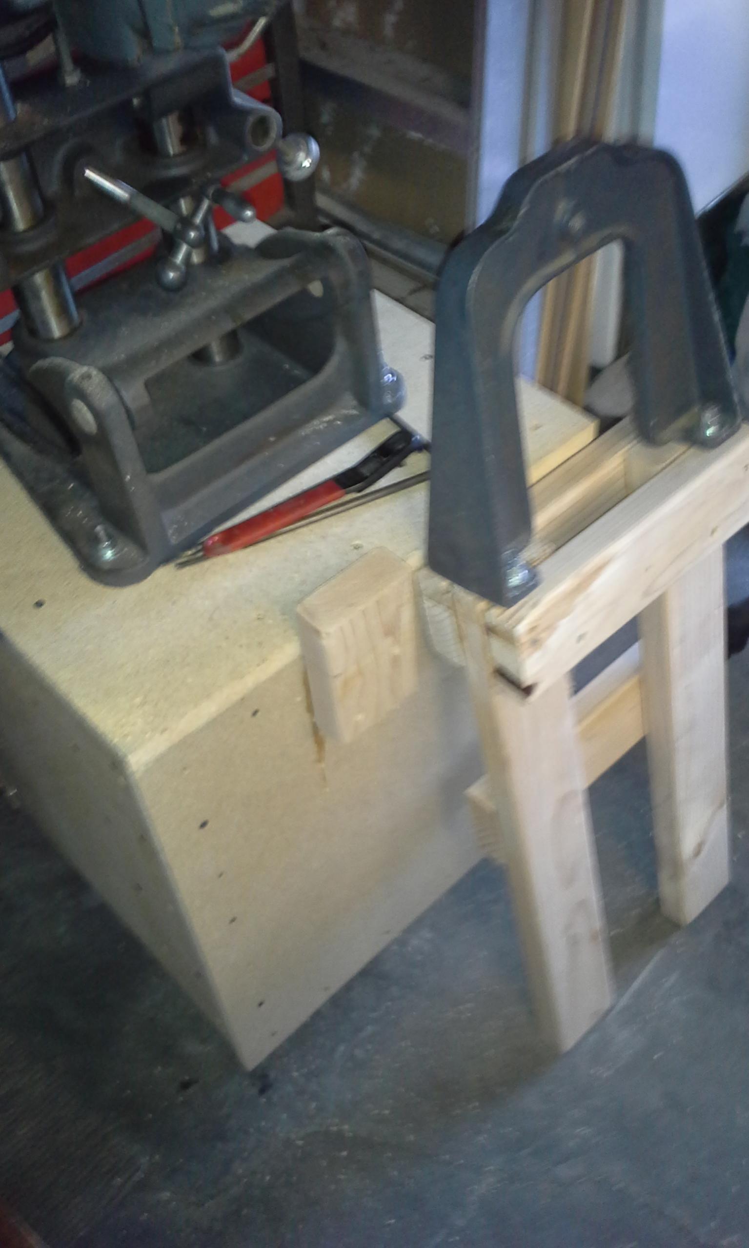

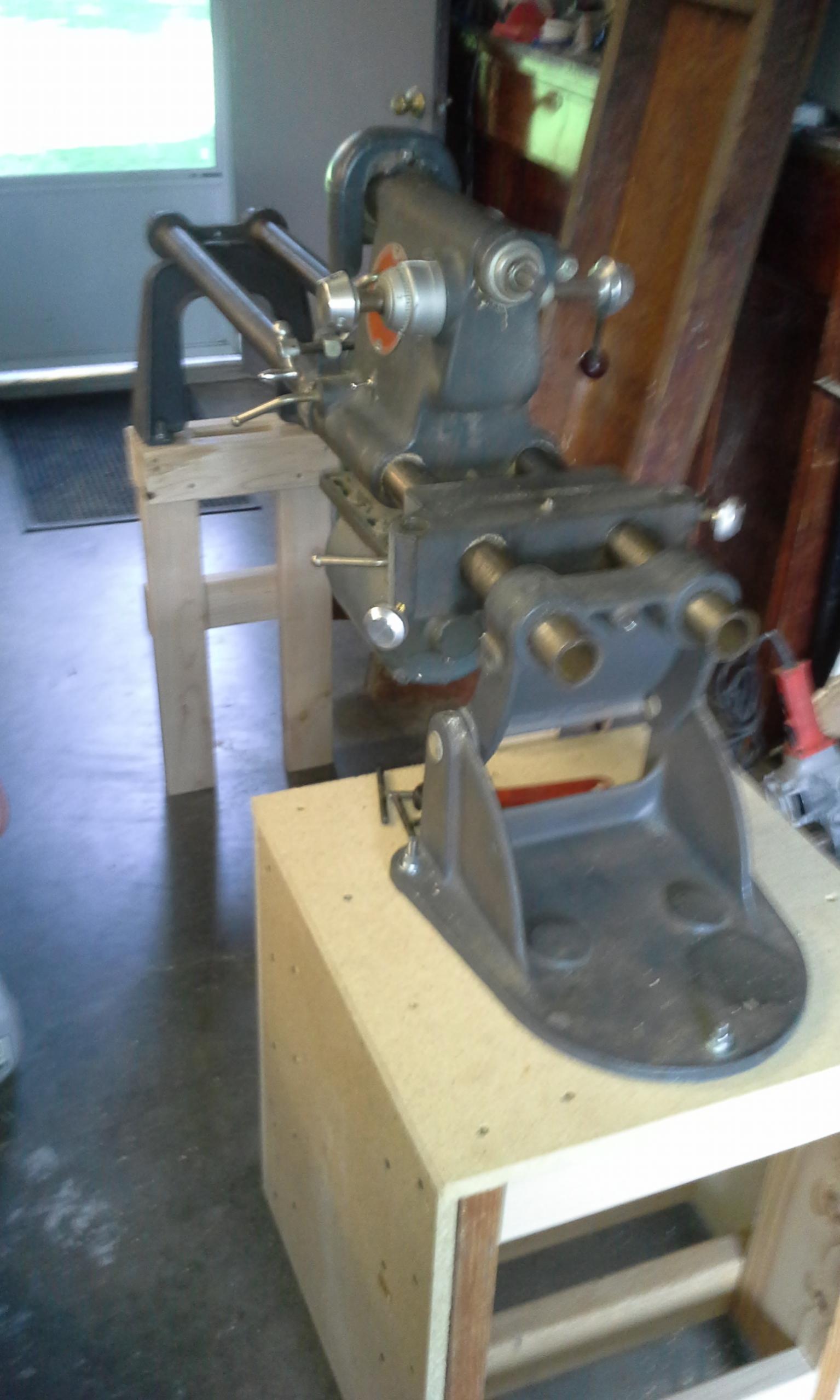

Here's a couple of additional shots of the 10ER in Horizontal configuration. The photo on the right was taken before the front of the pedestal was fully enclosed.
One of the concerns, was if the 'outboard' support for the 10ER would be stable enough to work well. After over a year of working with this machine in both vertical and horizontal 'modes', it has worked very well. I've had no issues with stability! The best part is, that in the vertical position, the machine only takes up four square feet of floor space! Much better than the the original horizontal bench or legs, that required at least 6 or 8 feet of length and 2 feet in width. Since floor space in my garage 'shop' is already at a premium, this mod was a must!
