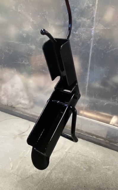

    Hi All

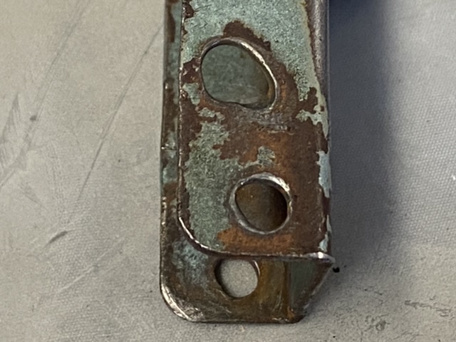

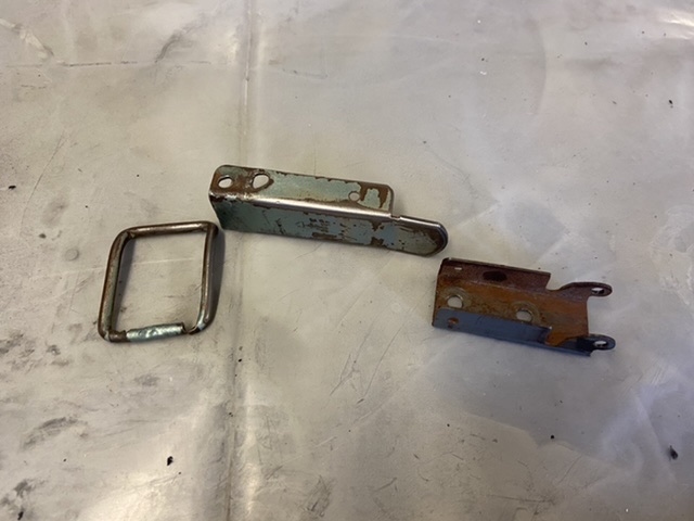

    On closing the door of my shot blast cabinet the door latch fell apart from wear and tear. My first thought was to just buy a replacement but trying to get an exact match was impossible and I didn’t really want to drill additional holes. So the only option was to make a new one.

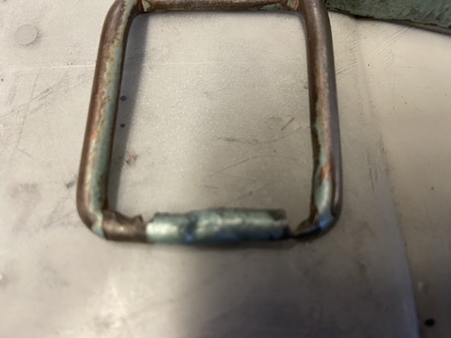

ID:	34341Click image for larger version.
ID:	34342Photos showing excessive wear.

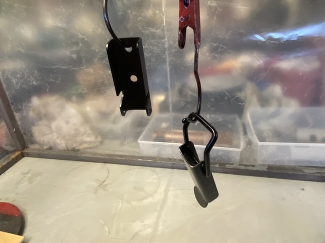

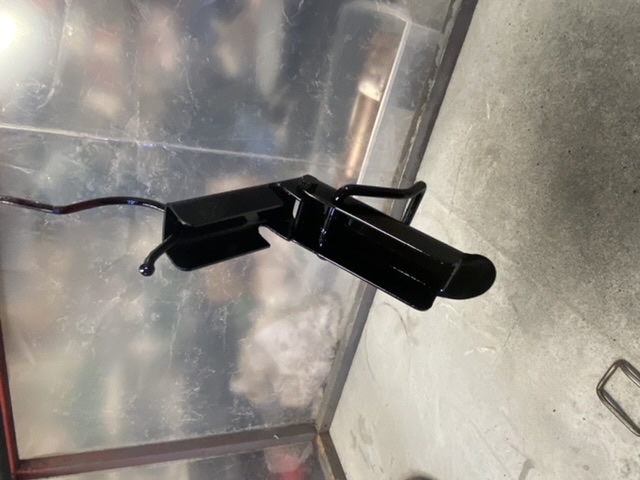

ID:	34345 New latch painted

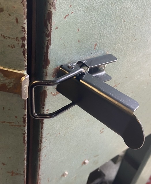

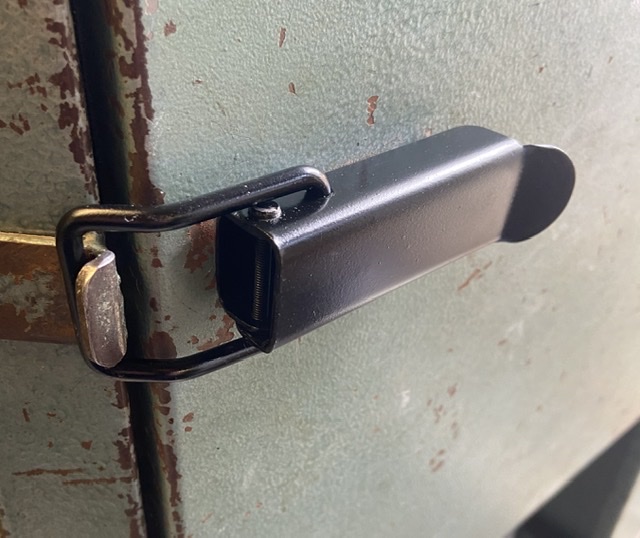

ID:	34347 Click image for larger version.

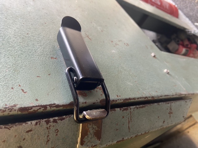

ID:	34348 In place and works really well
    This only took a hour and half to make so pleased with the result.
ID:	34344   Click image for larger version.
