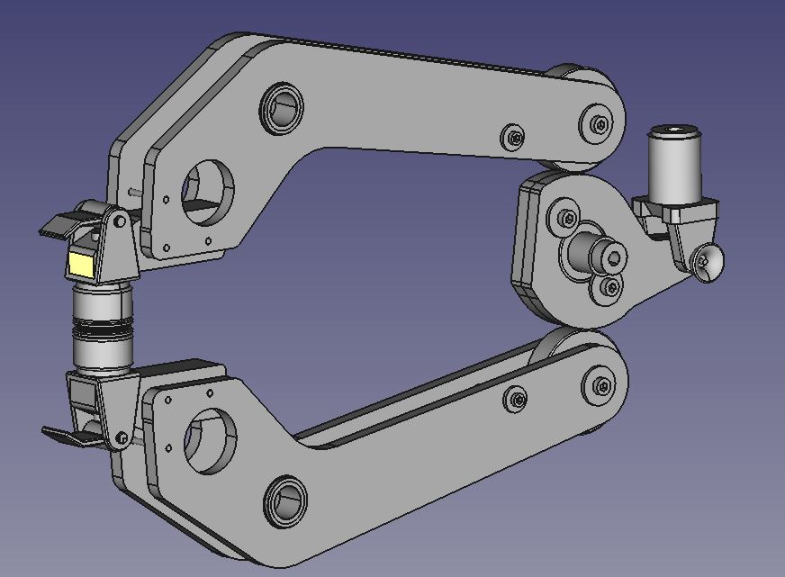

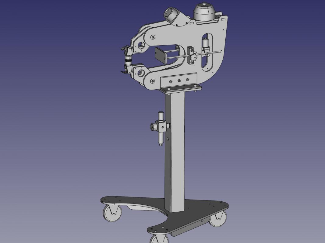

    Just wanted to show the result of the last days of work on FREECAD on my Shrinker/Stretcher.
    Waterjet cutting is already in progress and abt. 90% of the other parts are in my workshop and waiting to be assembled.

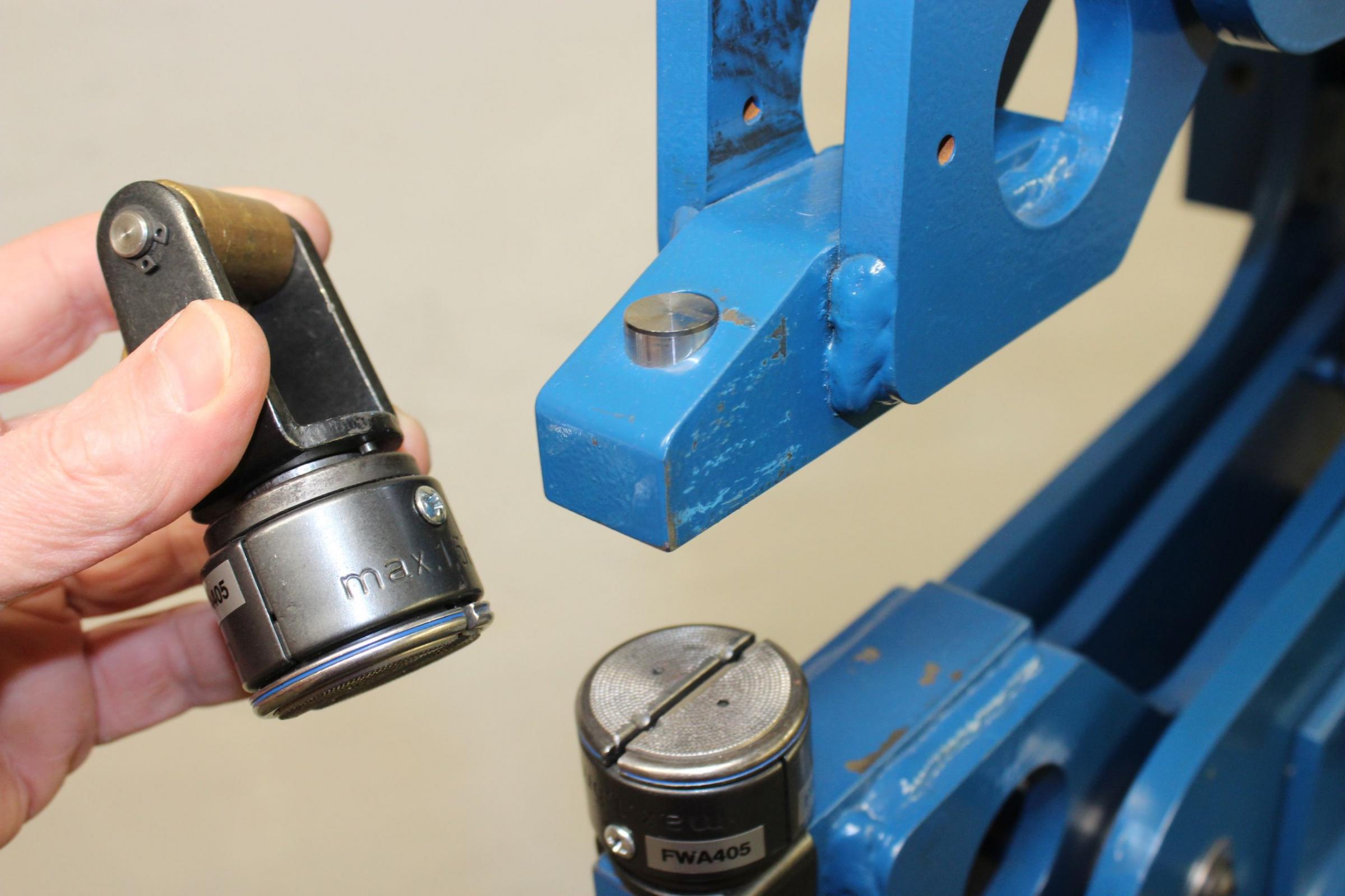

    Apart from the 300 mm throat depth, one special feature are the swiss made jaws from ECKOLD with quick release mechanism. The machine is designed for 1.5mm mild steel sheet metal or 2mm aluminum.

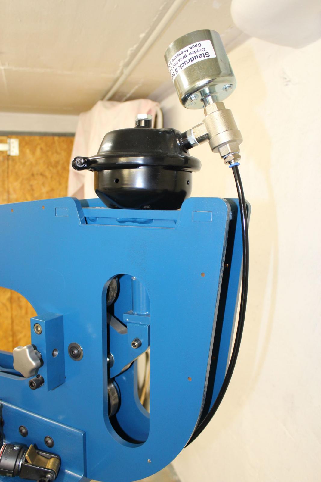

    Machine uses a pneumatic membrane cylinder from a truck brake system. It will bring 3 tons of pressure on the jaws by putting 5 bar of air pressure on the cylinder.

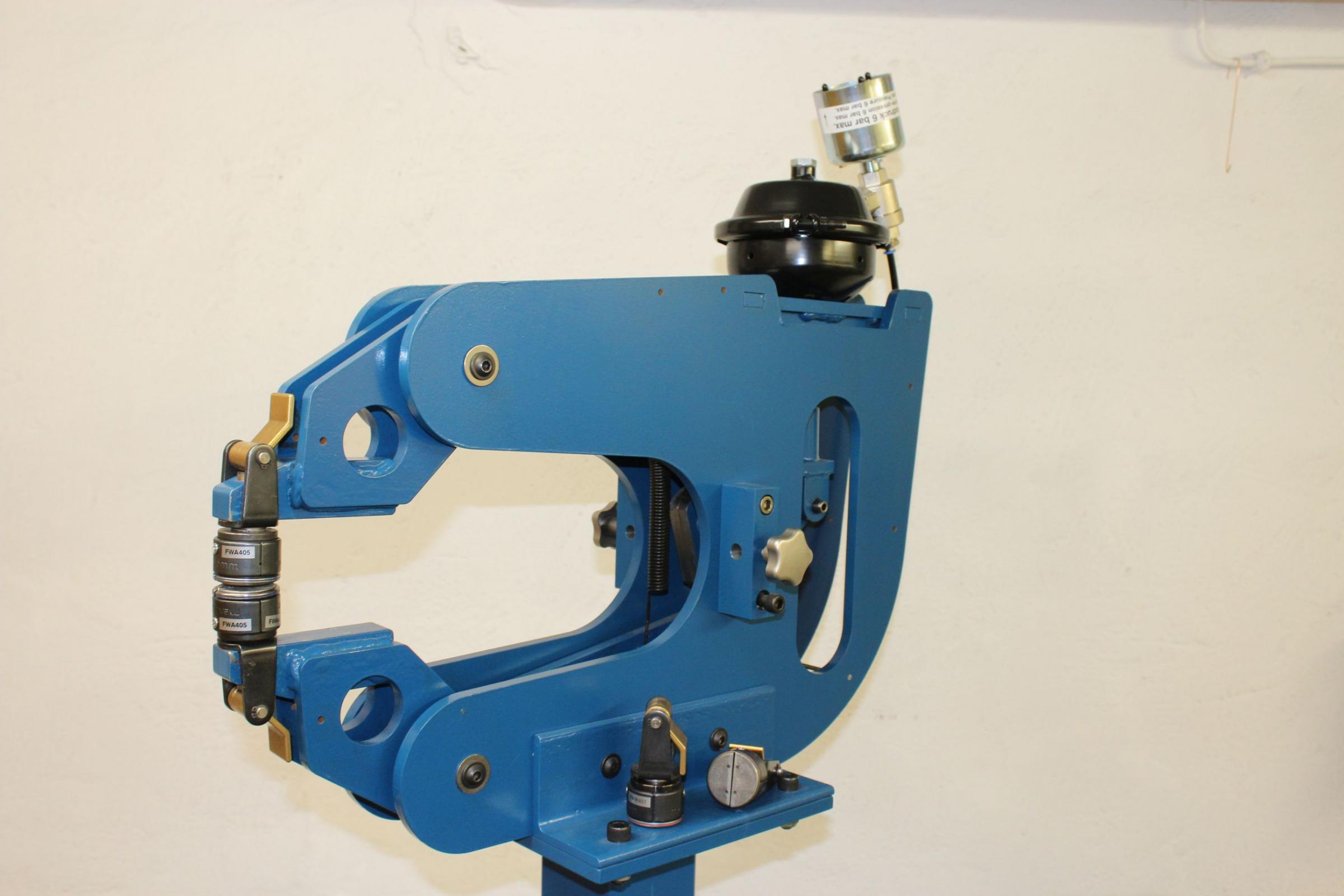

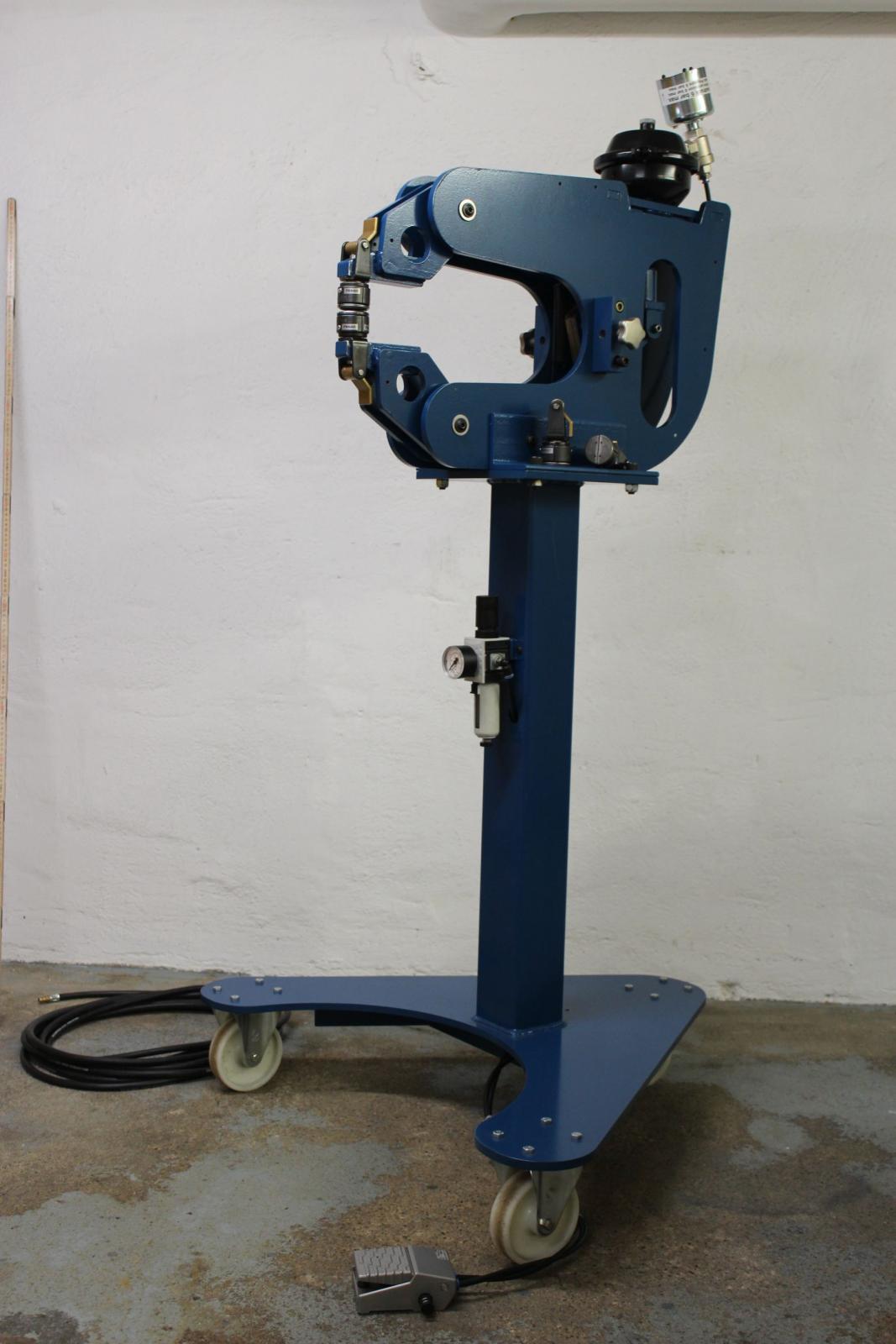

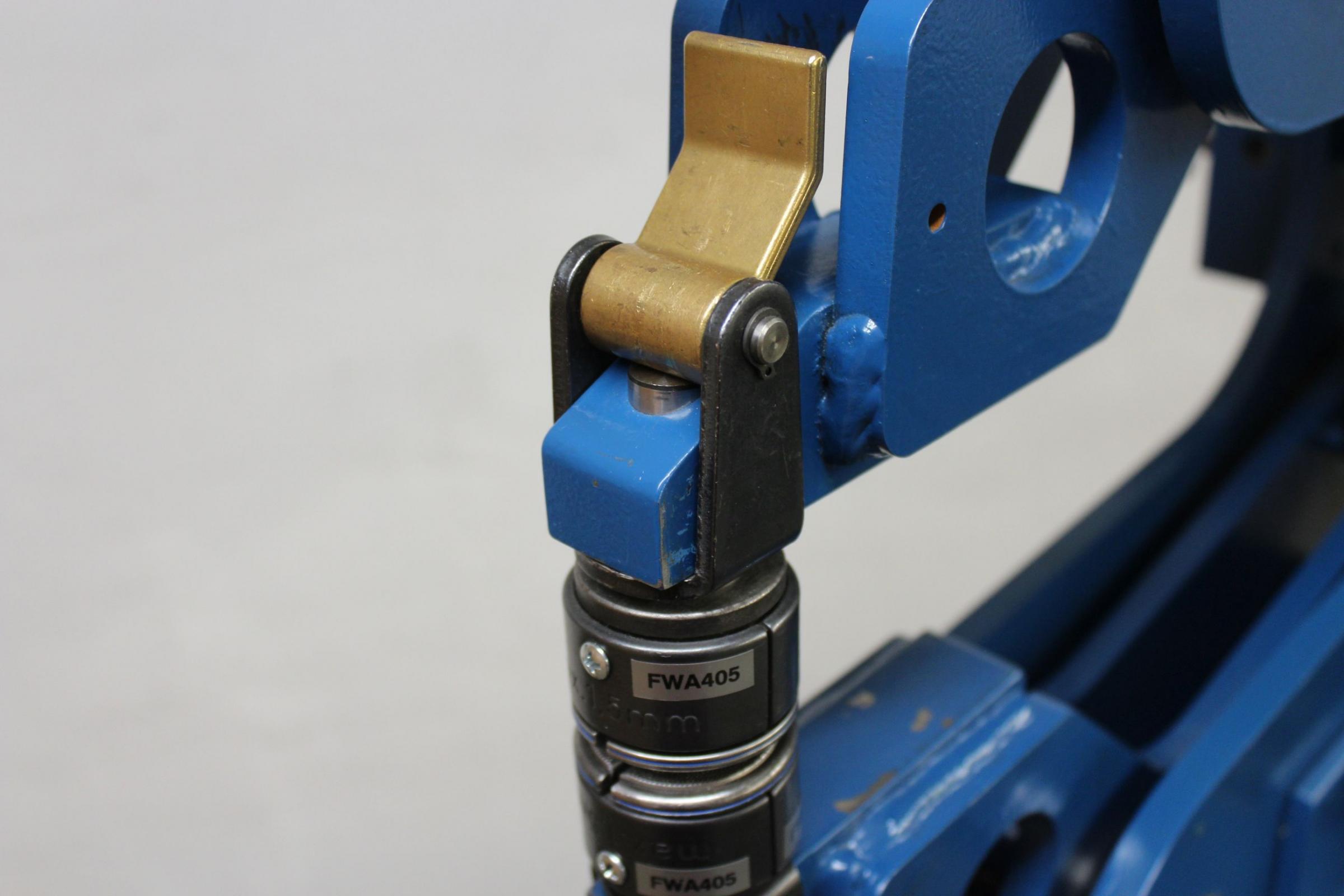

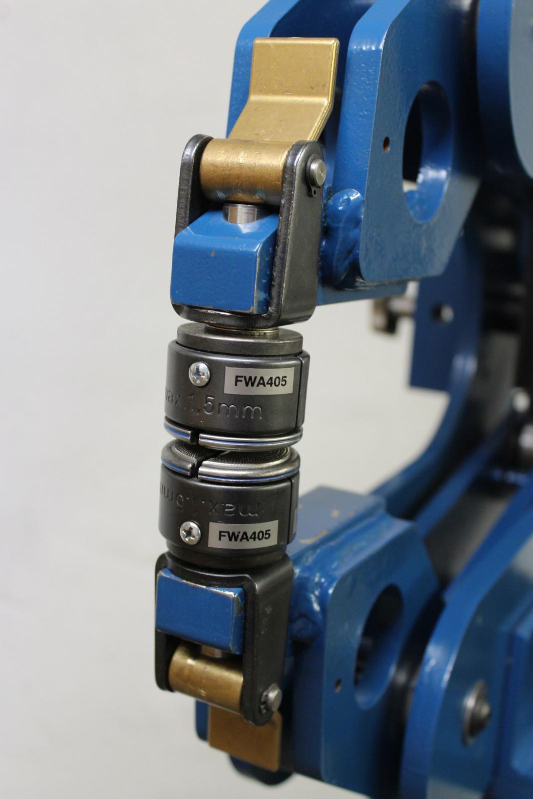

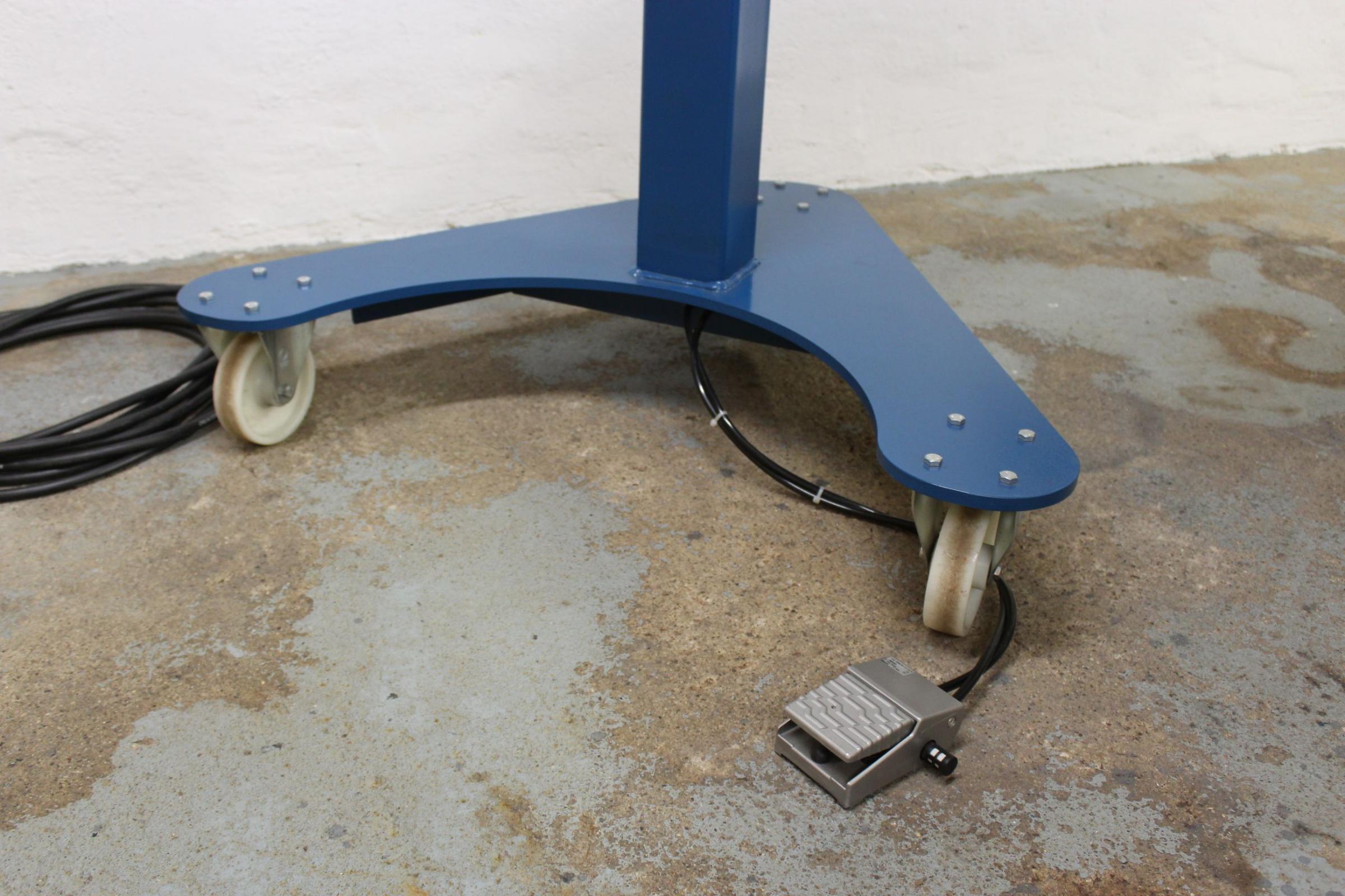

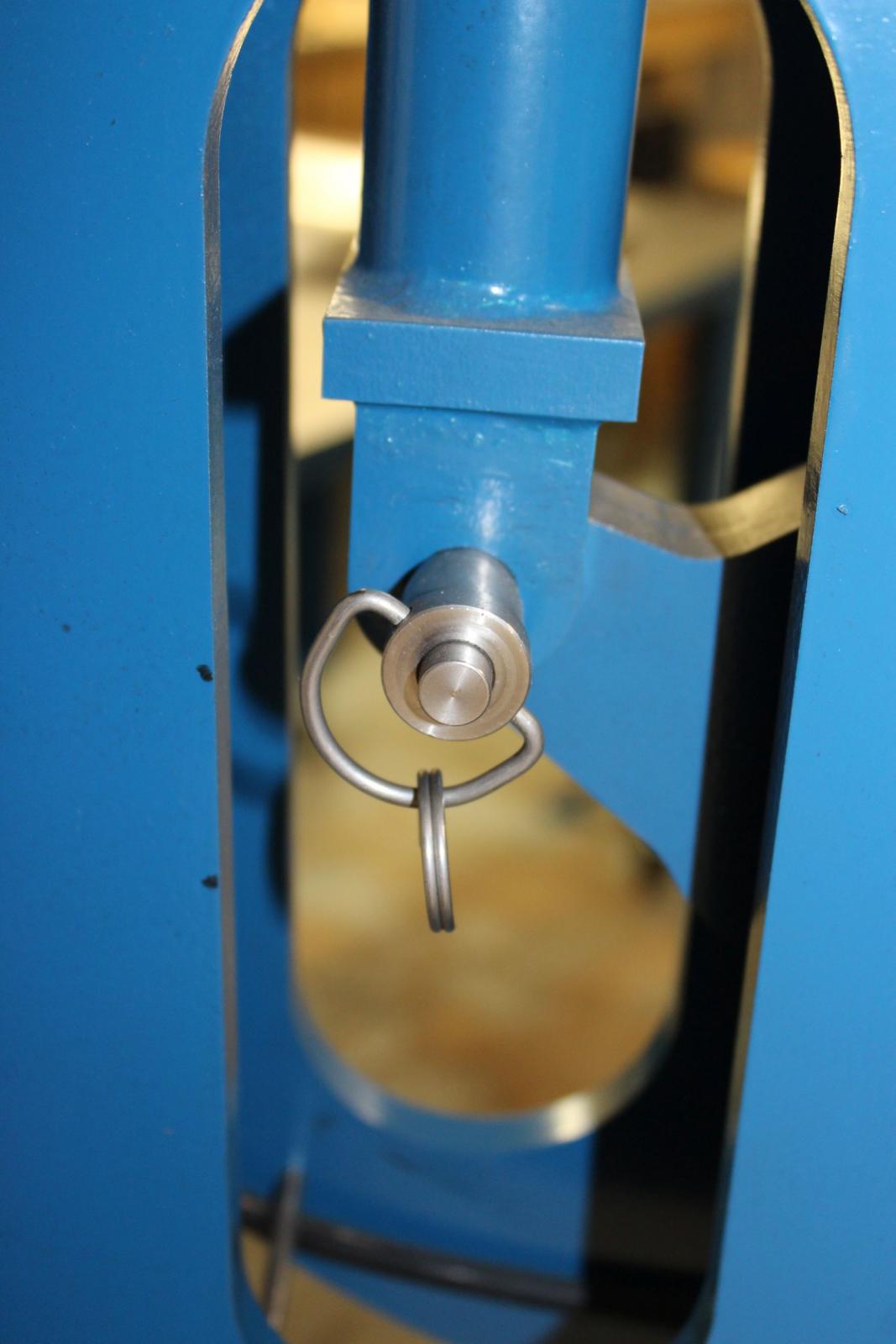

    Hi Folks! It's been a while...
    Here are some pictures of my finished Shrinker/Stretcher. Works great. I optimized the working speed (cycles per minute) by implementing a quick pressure release valve on the pneumatic membrane cylinder. Depending on the work piece it can be up to 30/min now. I also figured that the forces required for shrinking are way higher than for stretching. With the current setting it easily shrinks 1,0mm mild steel and stretches up to 1,5mm. If I had to do one again, I'd use a larger membrane cylinder and a stronger material for the excenter (see 3D pic) which is 2x 12mm plates made of S235, bolted together.
    Just ask if you have any questions...
    Charst

    Awesome pictures! I see a quality tool that you have made. Something like this can be very useful for panel work and even bending bar and angle iron. If you were to do it over what metal thickness do you think it would be capable of shrinking or stretching?

    Hi Kent
    The Eckolds are used ones. I was really lucky to get them for a very, very low price
    I accidently have deleted the set of STP-Files a couple of months ago and was too lazy to make new ones. I Just have the original .FCStd-Files from FREECad, the DXF-Files for the waterjet cutting and a parts list (German). It's a 10mb Zipfile package that I can send you. Send me a PM with your email adress.
