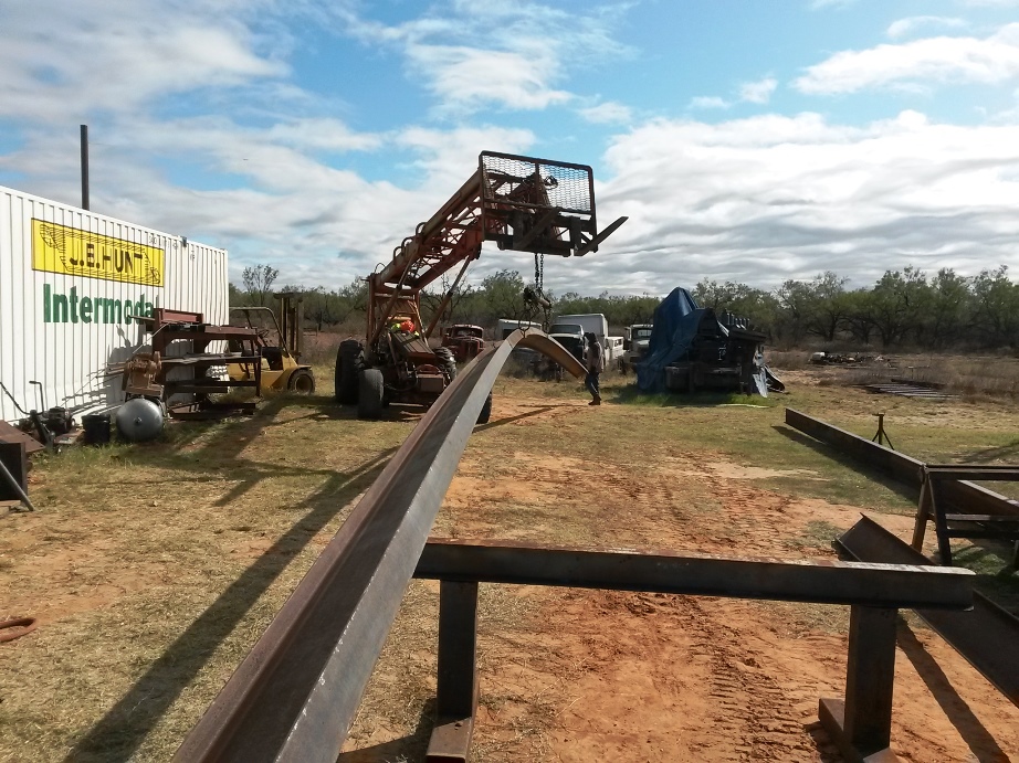

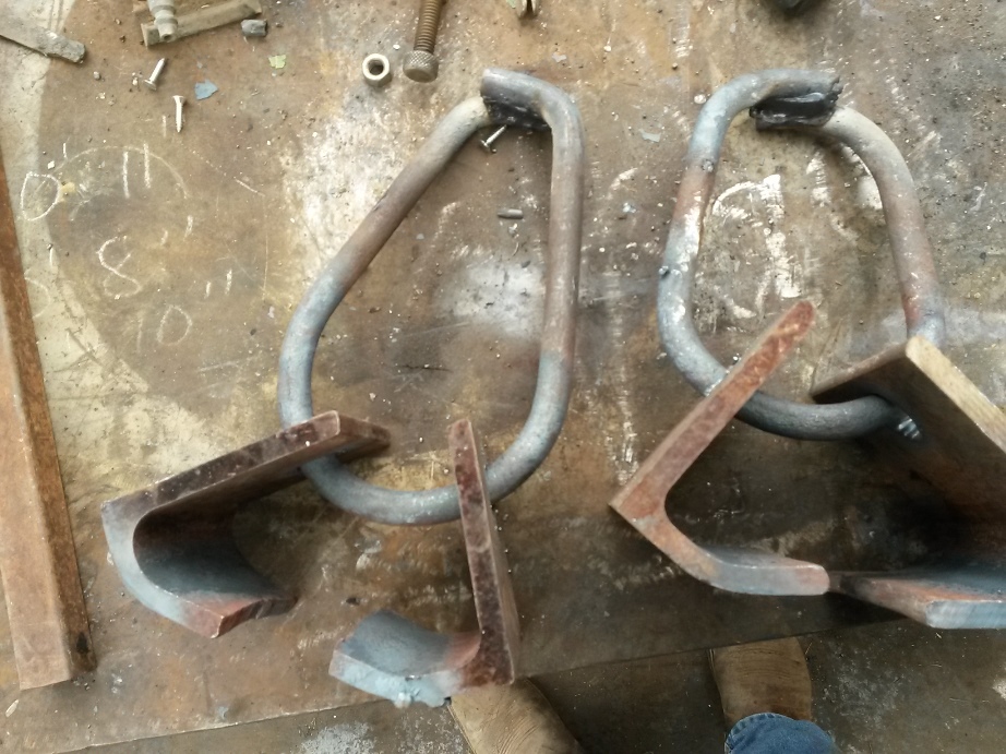

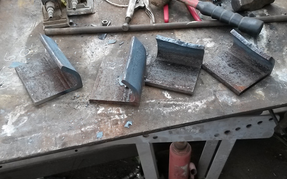

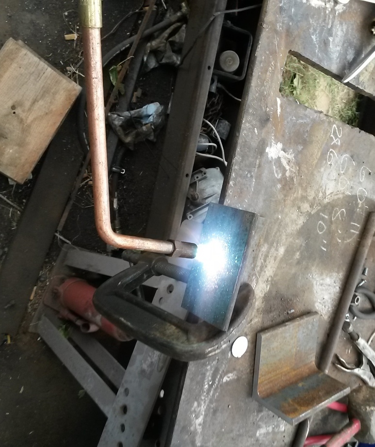

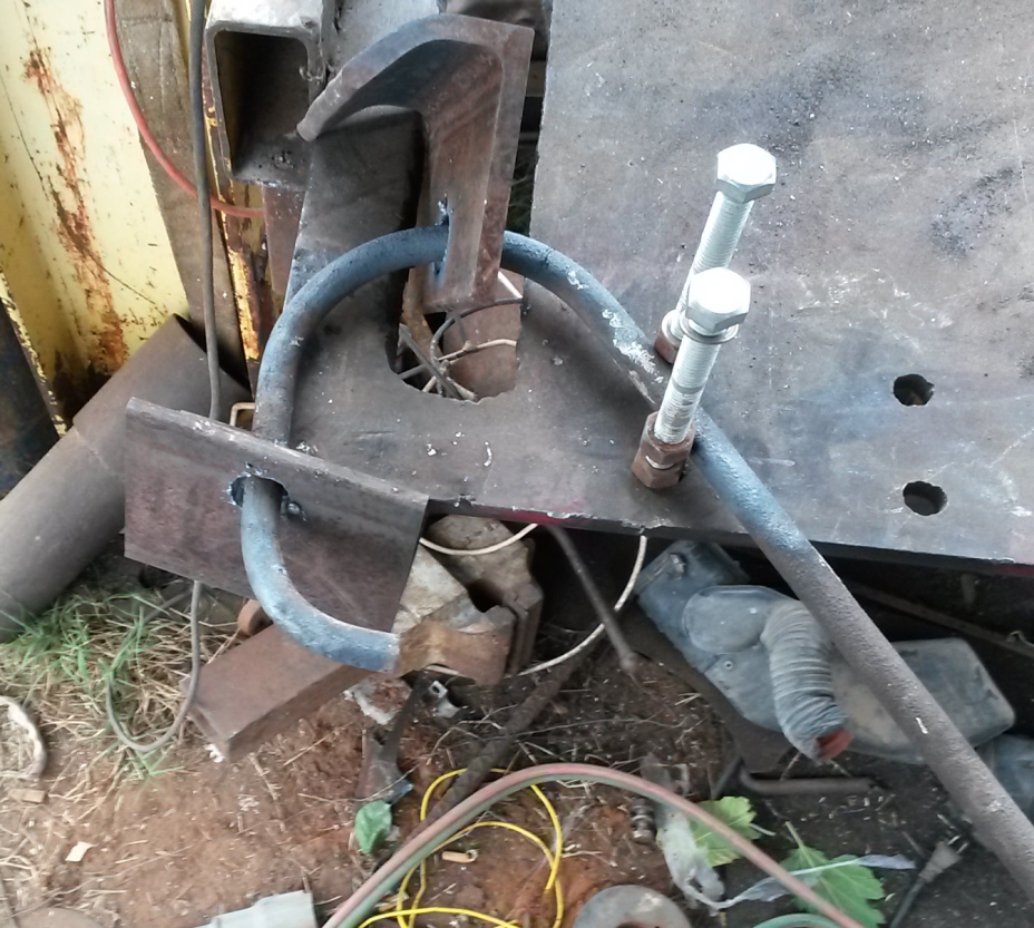

In getting ready to raise the top plate beams for my shop I needed a pair of clamps of beam hooks to hang from my spreader bar to assist in safely lifting the 68ft long beams
the clamps are made from 3 x5 x3/8" angle iron and 5/8 sucker rod
Attachment 31734
Attachment 31735
Attachment 31736
they don't match but hanging from a chain who cares as long as they do the job I wasn't about to spend a lot of time on them anyway.
