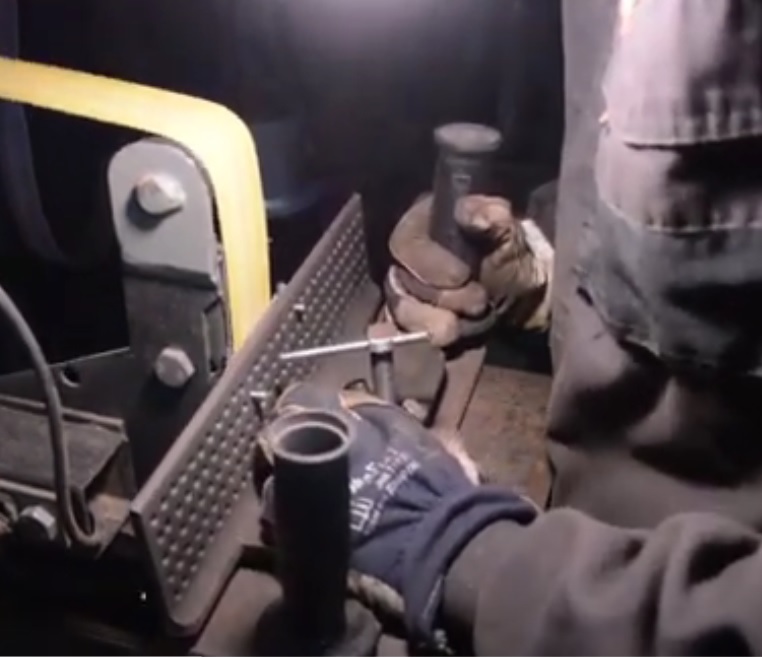

Simple KnifeMaking Jig made out of 70 [mm] angle iron.
Allows the attachment of large blades (easily up to 300 [mm]).
Huge amount of tapped holes helps in finding proper position for different bevel styles.

Attachment 40953

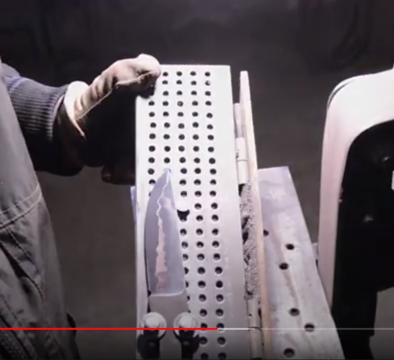

I use M6 bolts with washers to clamp blanks to the Jig
Attachment 40954
