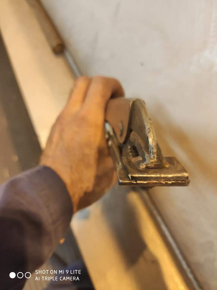

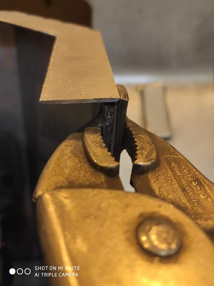

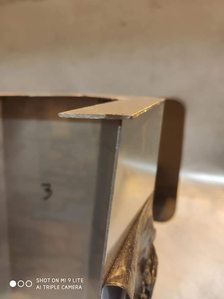

    Simple sheet metal align clamp from locking pliers
    Simple aligment tool for welding sheet metals.
    Two different lenght flats weld to locking pliers.
