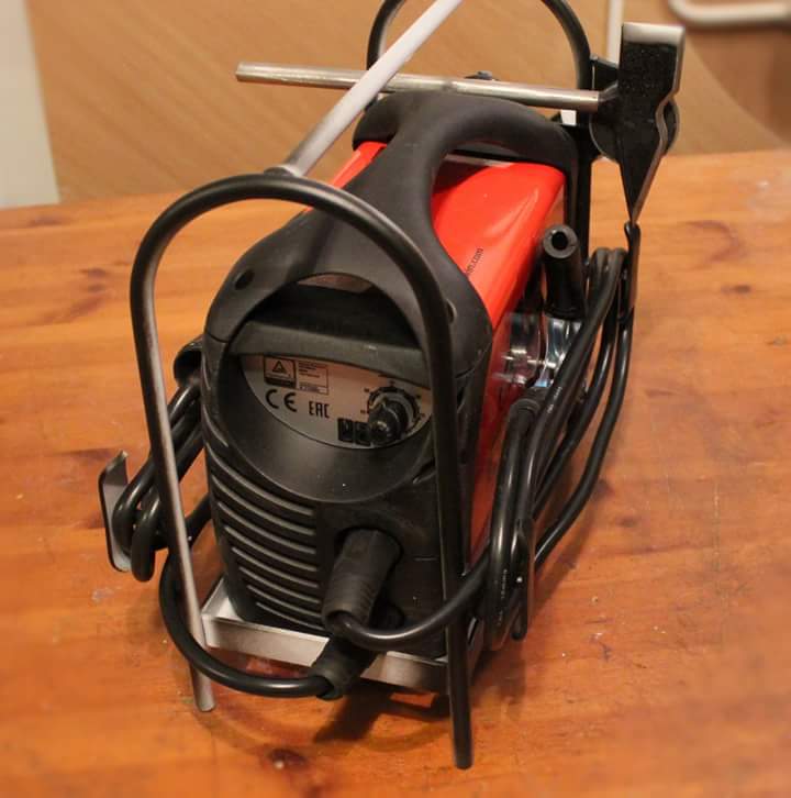

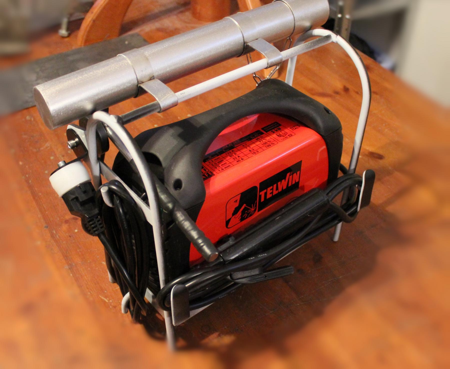

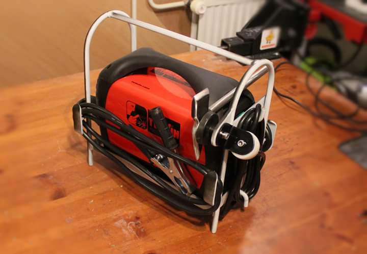

Hi.
Made a simple caddy for my stick welder.
To avoid cable mess when stored.
Material is 10mm and 8mm rod, 3mm flat bar and L-profile.
Attachment 20820
Attachment 20821

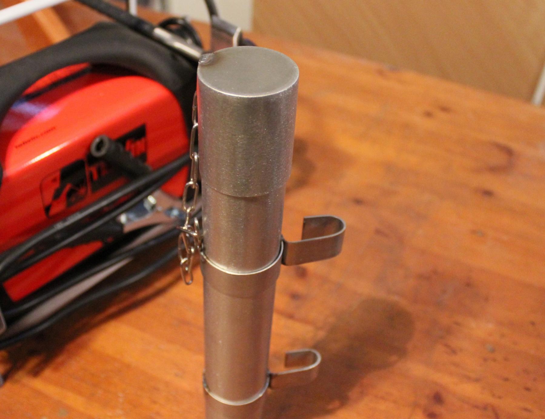

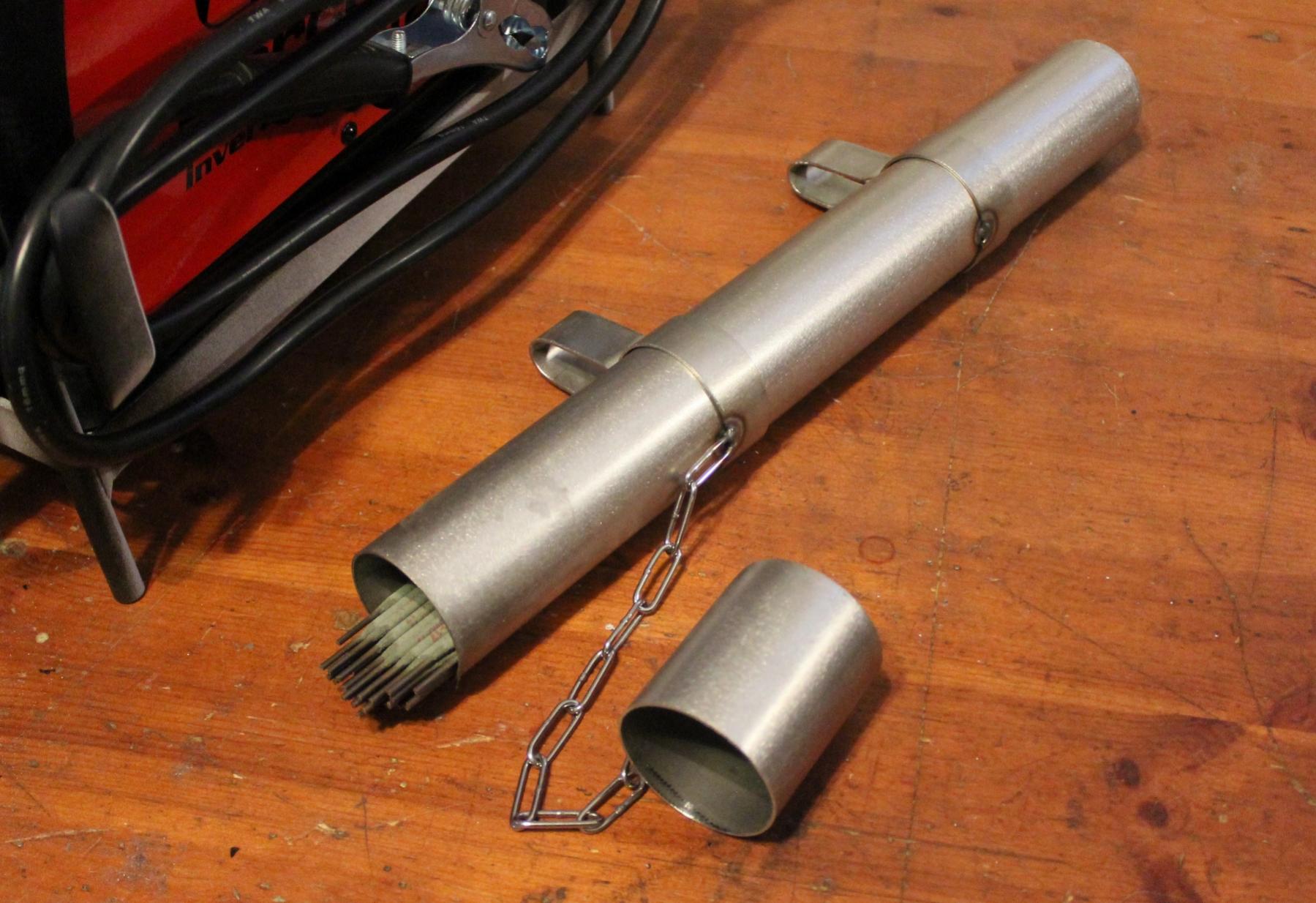

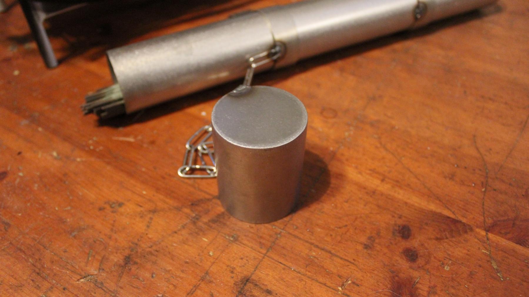

Made a simple attachment to this caddy.
For carrying and storing welding rods.
Material is stainless pipe, smaller one has 50mm outer diameter, cap is made from pipe with 50mm inner diameter. Both are with 1mm wall.
Ends are weld from 1mm stainless sheet.
When not in use, i store the casing and rods on top of our central heater and rods stay dry.
Attachment 20847
Attachment 20848
Attachment 20849
Attachment 20850
