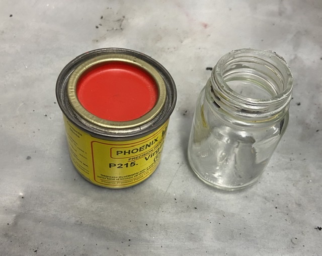

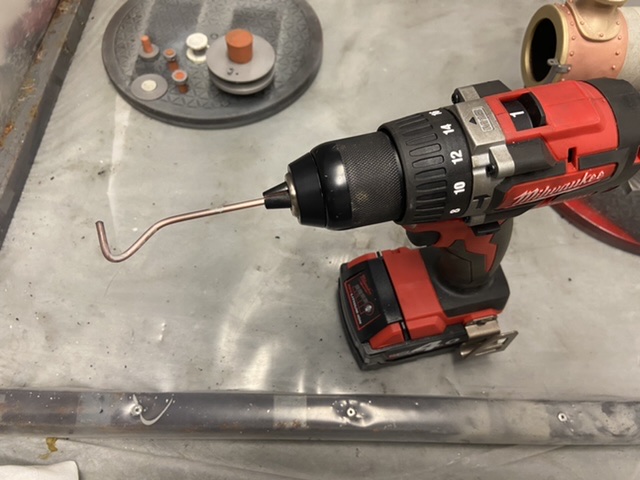

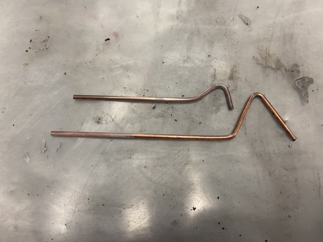

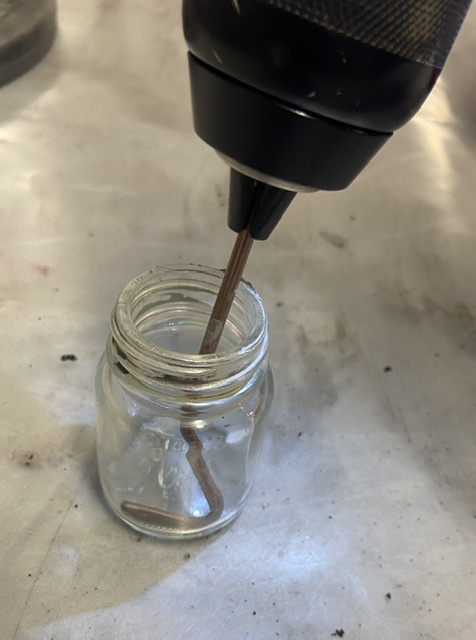

This is a simple paint stirrer made from a piece of 3mm Tig welding rod bent up with a pair of pliers and used in a battery drill. This really mixes the paint quickly and effectively in seconds. I wish I could claim it was my idea but sadly not. I read this in a book called “how (not) to paint a locomotive by Christopher Vine. I have only ever used it on small tins of modelling paint so not sure how it would work on household paint tins with a bigger framed stirrer.:headscratch:Another great advantage, if I have mixed to much paint I can seal and stir in the airbrush bottle at a latter date. Very simple but very effective.
Attachment 34378 Bent welding rod ready to stir paint.
Attachment 34379 Two different sizes
Attachment 34381 Attachment 34382
