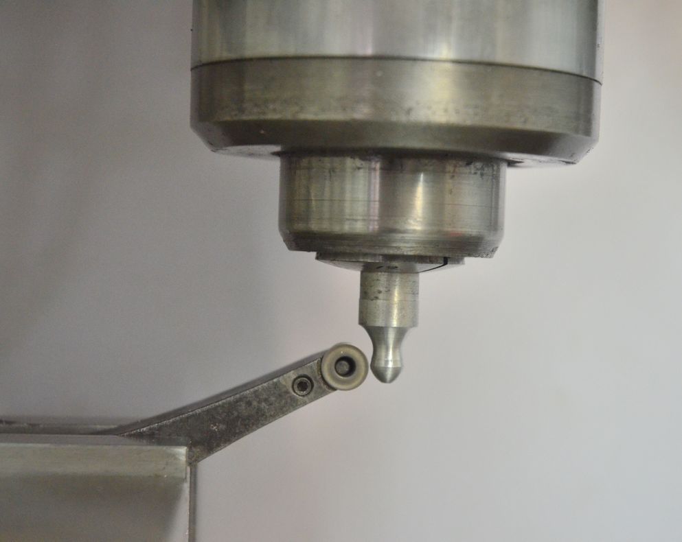

Here is how I would do it in a mill. Virtually zero setup, just add some G-code and away you go. click on pic. for full size.
Attachment 19203
There many similar examples of this on the net but they have missed an opportunity.
They have placed the rotational axis of the tool assembly on the centre line of the cross slide, just like mine. That was forced on me because of my decision to use the existing compound rest as the basis. However, it would have been very easy when building the complete thing from scratch to move the axis on the plate forward toward the chuck. maybe even overlapping the edge of the cross slide with the plate. So those designs suffer needlessly from the same problem as mine, they both need a lot of work piece overhang to provide clearance from the chuck.
Another aspect which could be easily improved is the tool holder. There is no need to machine the guts out of it to make an "L", If just enough is machined away to provide clearance for the largest ball then it would be more rigid and have more mass. Rigidity and mass are very desirable properties on any machine tool.

If it is this simple why does anyone build the more complicated ball turner?

Ha, I often ask myself that about a lot of things. I am lazy so I tend to find simple solutions. In this case my solution is perfect for my stated and immediate need but it is in general not as flexible in application as some of the purpose built versions. I was constricted by the pivot being set back from the edge and so chuck clearance is a problem to such an extent that I can't do much in the way of small concave shapes. Big ones will be fine.

Nice job, Tony! Gets the job done.
I made an over the top ball turner that uses a 2" Criterion boring head mounted in a QC tool post. Works great and I don't have the overhang issues you mentioned.
