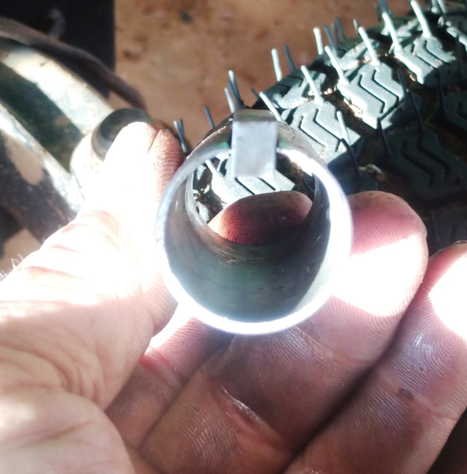

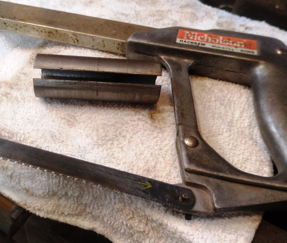

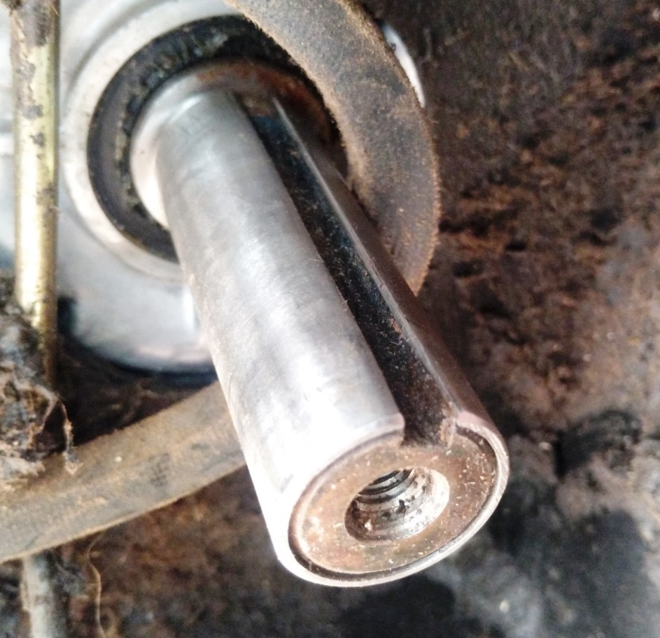

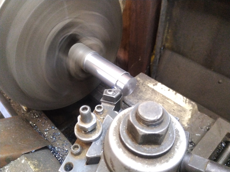

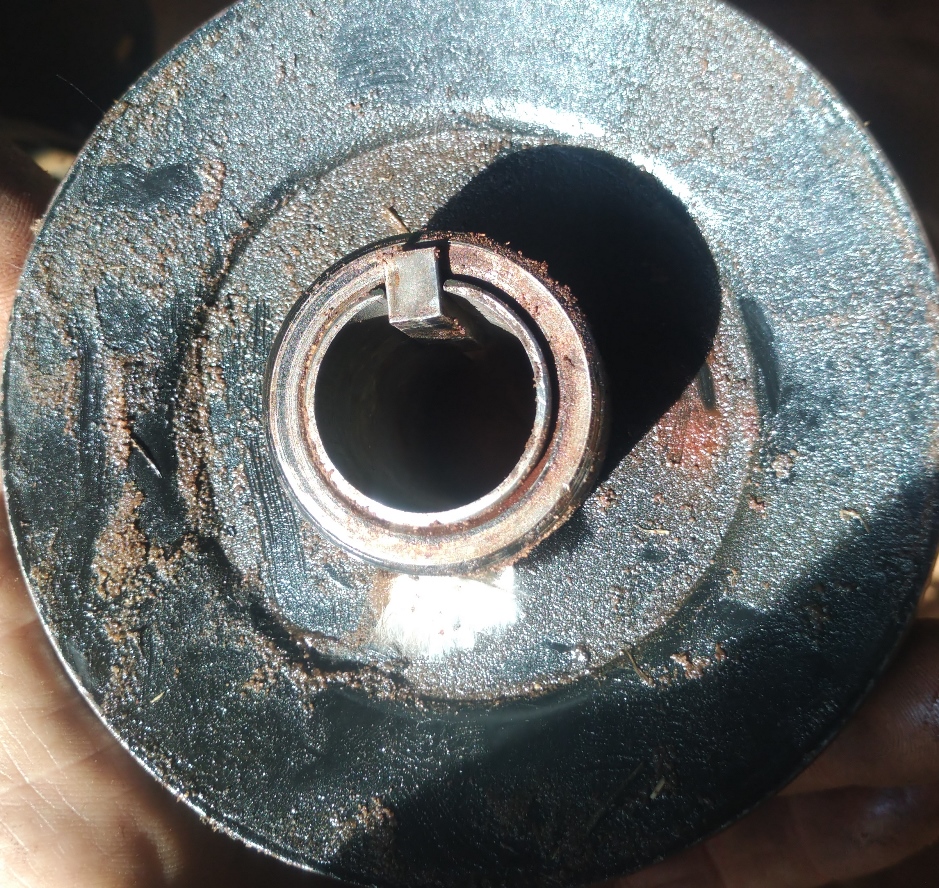

So I just had to make a 3inch long split sleeve bushing.
First I turned it down and bored it out then I split it for the shaft key

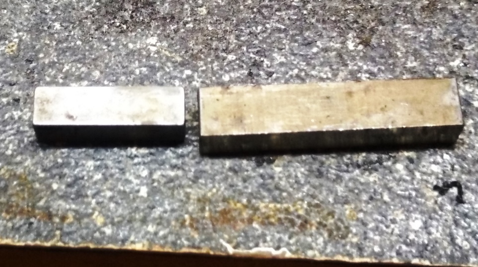

But it went like this, I purposefully turned it .005 under size then made the bore a few thou. undersize as well, taking into account for the tangent or thickness of the sleeve. From past experiences this should cause the sleeve to fit tighter on the shaft and remain there should the clutch need replacing later on. I will also have to make a shaft key of 1/4 by 5/16" high to correspond with the thickness of the sleeve
