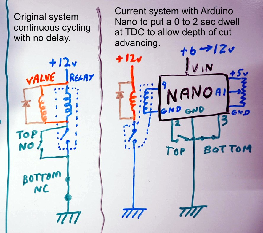

This post ties up some loose ends and describes the control. Schematics are shown below and the Arduino programme code is shown in the intro comments of this video;
https://youtu.be/ddg-DAFAGu8
Here is the schematic for the control, which is fully explained in the video.
Attachment 39848

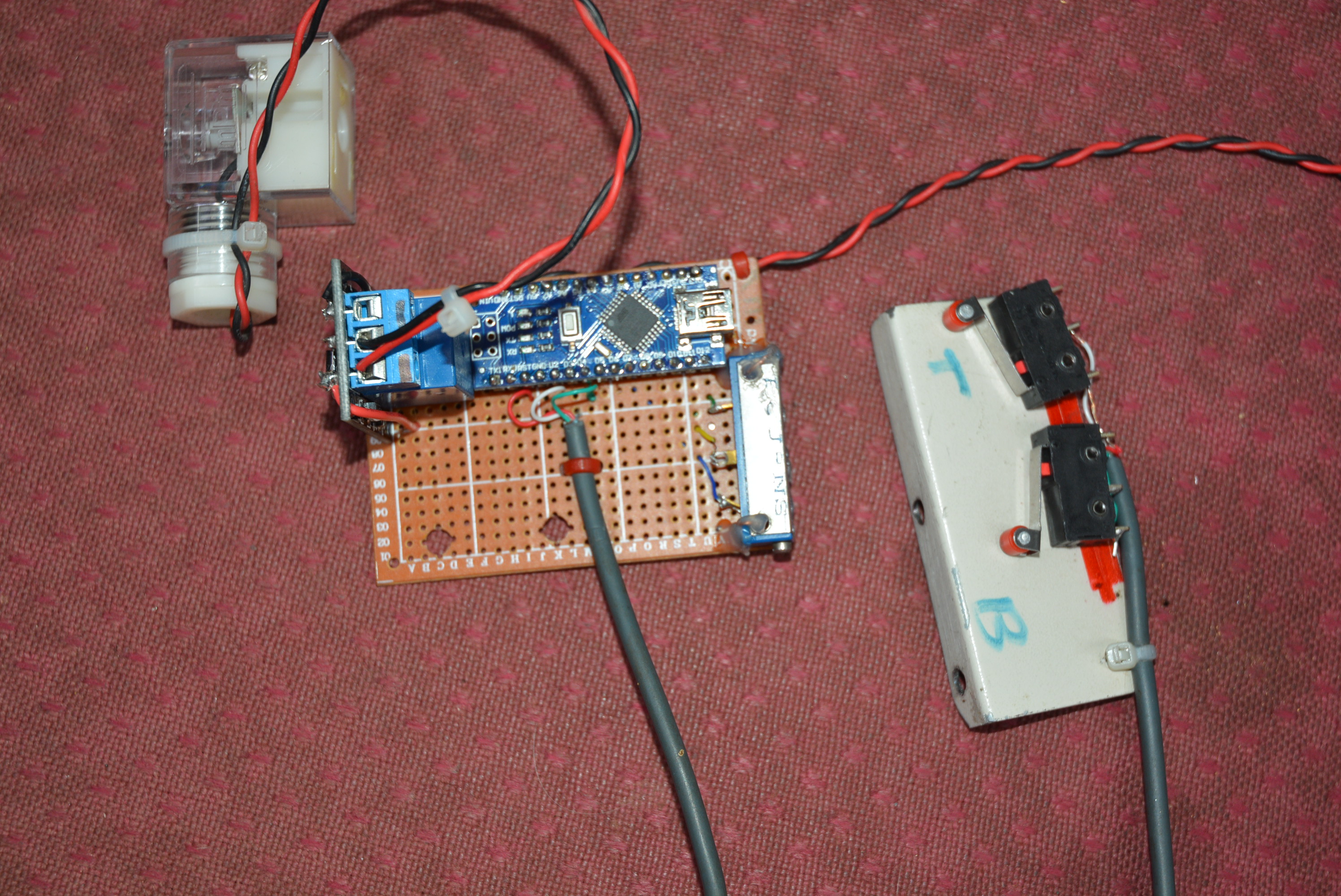

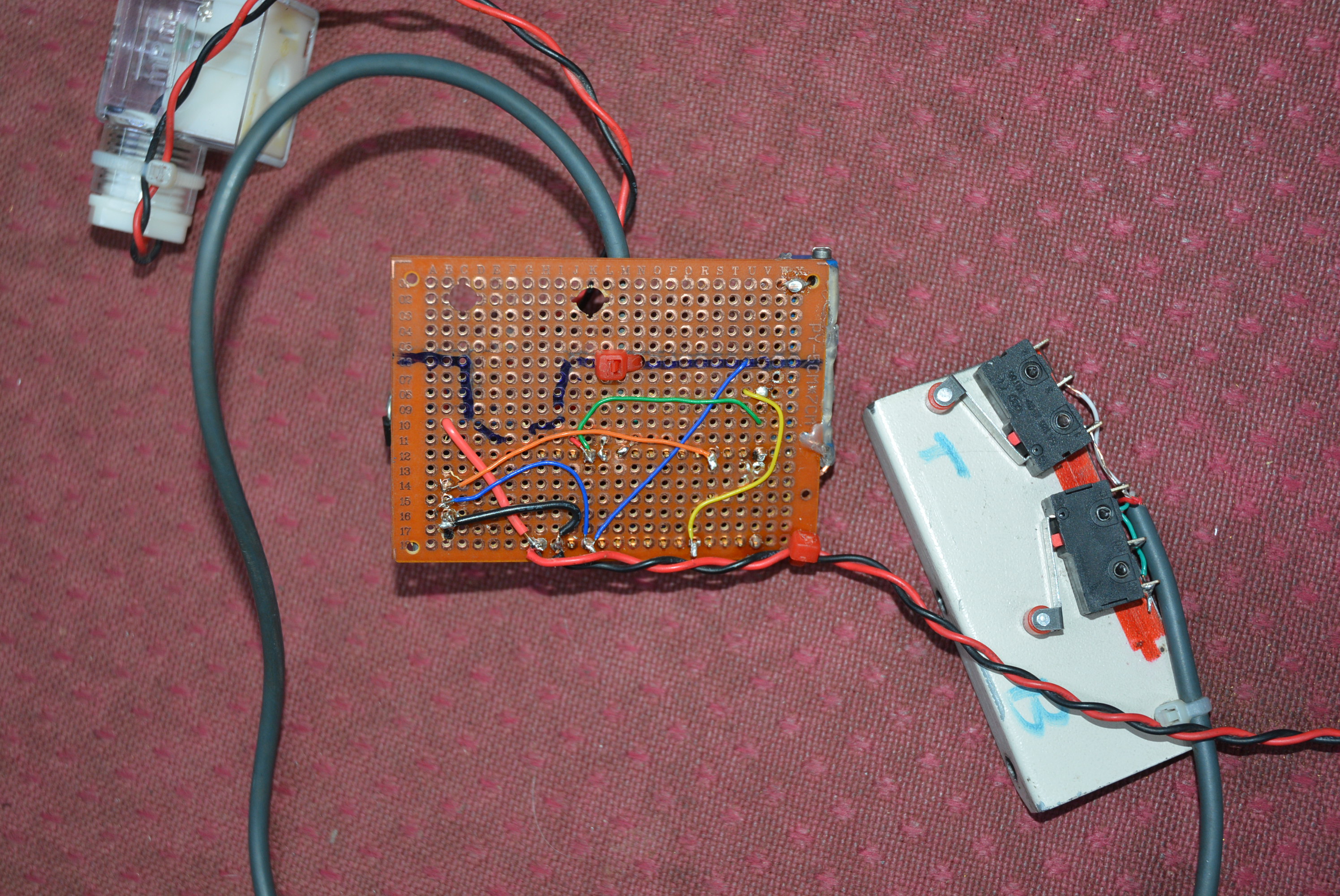

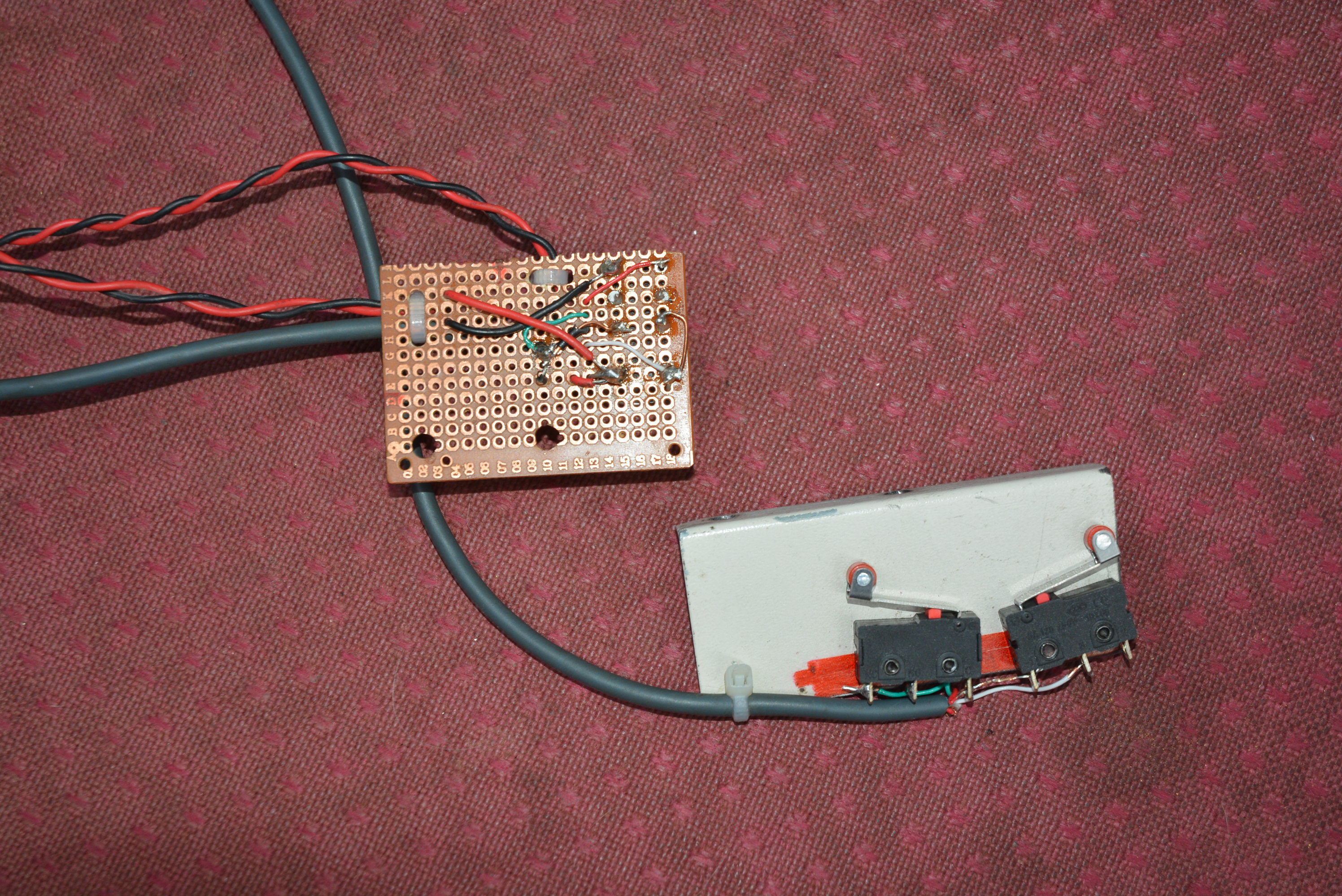

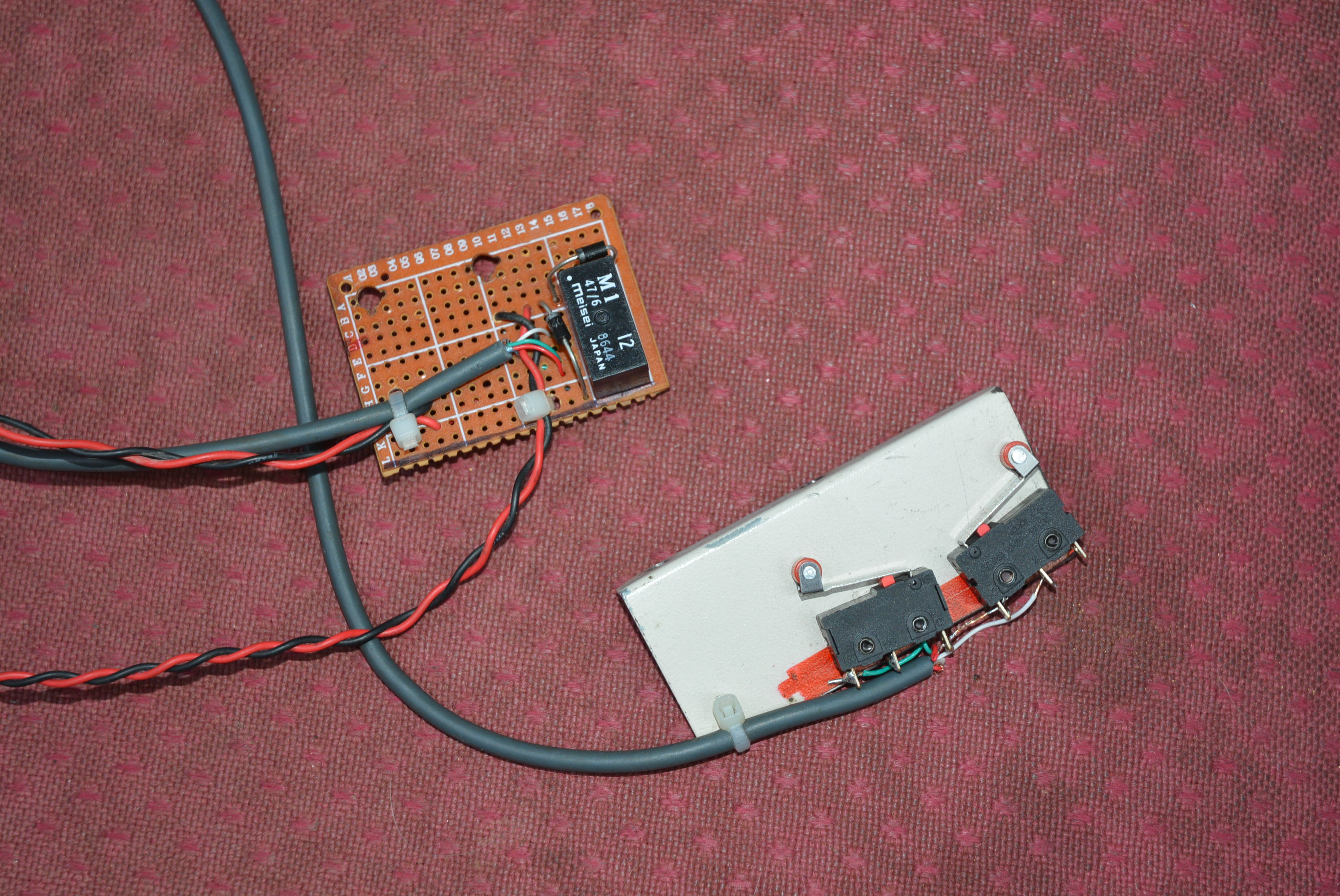

and some random pix of the Arduino and pre-Arduino boards, which show just how simple it really is.
Attachment 39849 Attachment 39850 Pre-Arduino control.
Attachment 39851 Attachment 39852 Arduino control.

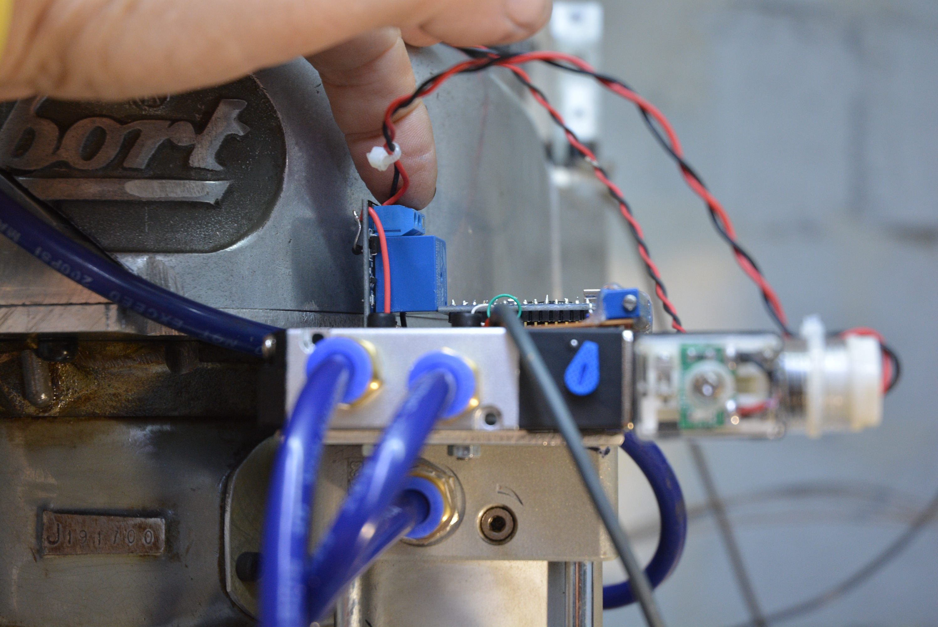

Attachment 39853 Control board bolted to top of solenoid valve. Finger points to relay.
